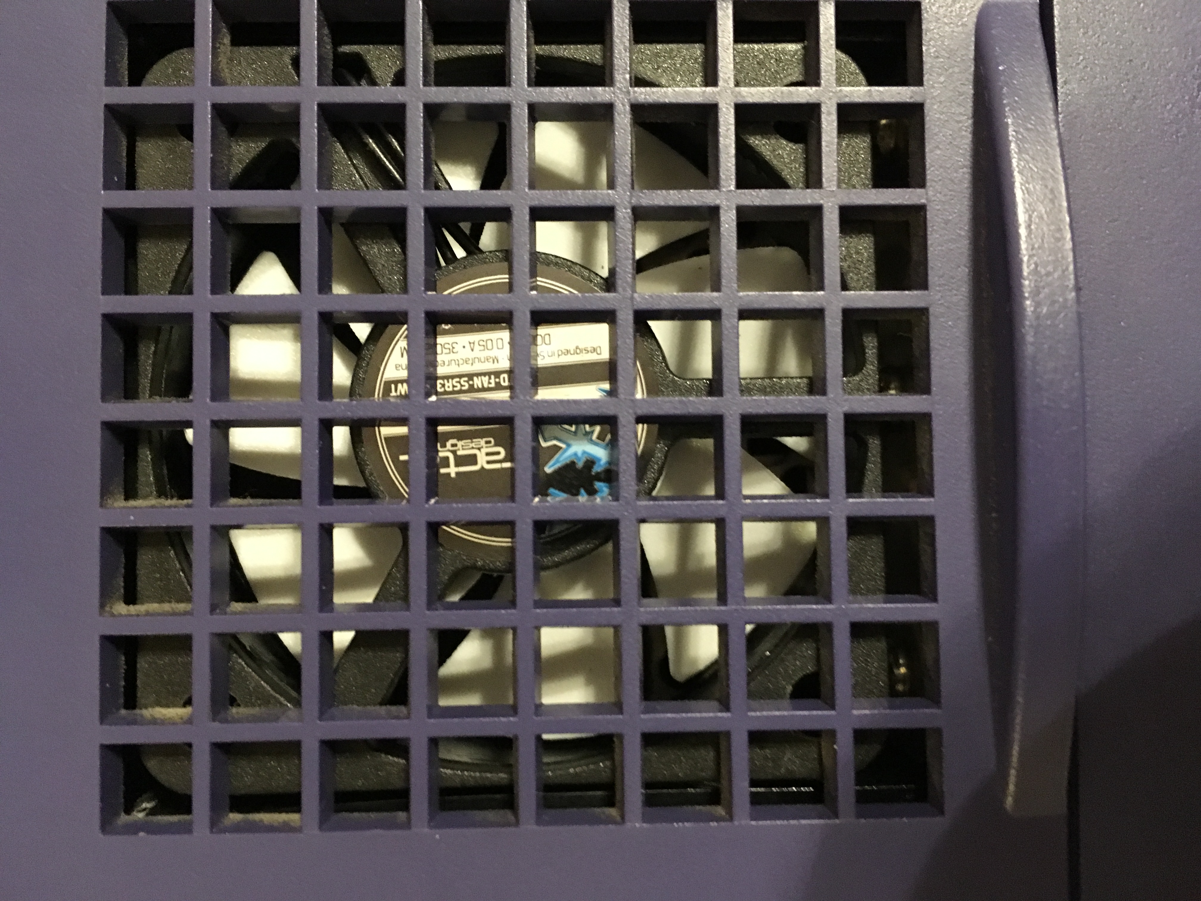

Fan
(2.33 MiB) Not downloaded yet
boredomca
Posts: 186
Location: USA
Re: GC fan replacement
Post by boredomca » Sat Apr 14, 2018 12:59 am
Wow looks great, Good job.
