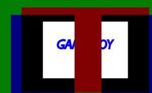

Red + Green: Regenerated blanking interval
Green + Blue: Actual blanking interval

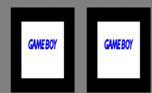

Why am I seeing a double split image?
Either progressive scan mode is enabled or, if using GCVideo-DVI, line doubling is by default.
If line doubling is at fault, the picture may also be scrolling with a slant.
