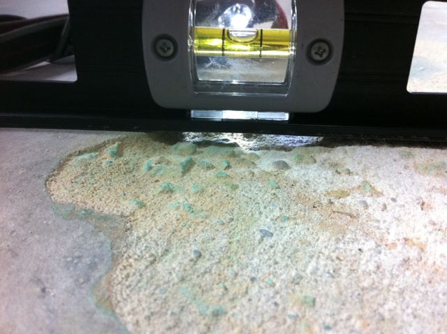

Postby megalomaniac » Tue Jun 12, 2012 11:21 pm
just wanted to add some new found discovered information about HCL+hydrogen peroxide (Copper Chloride) homebrew etching solution...
it is still my opinion that this is the best solution to use however i want to add a word of caution...
i am packing and cleaning my lab...
during cleaning, i noticed something odd about a batch of dried etching solution i spilled on my concrete floor...
looks like this stuff will eat thru concrete
oops :roll:
