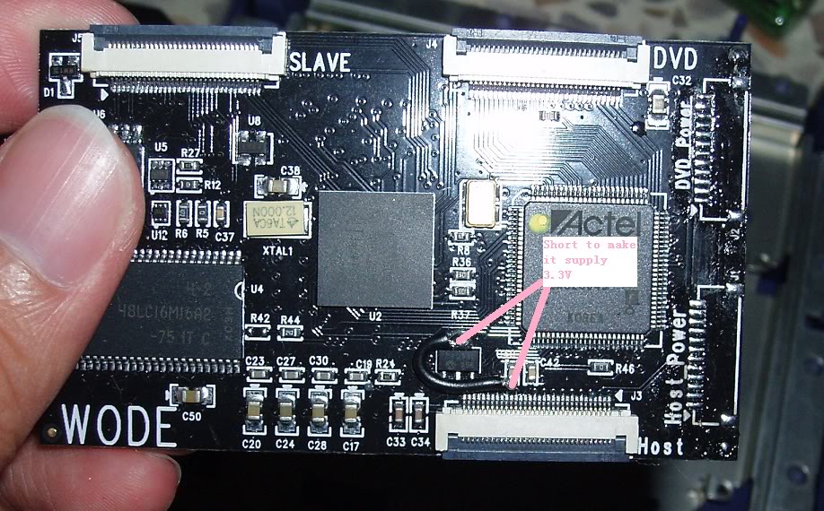

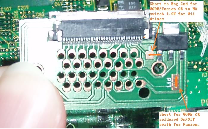

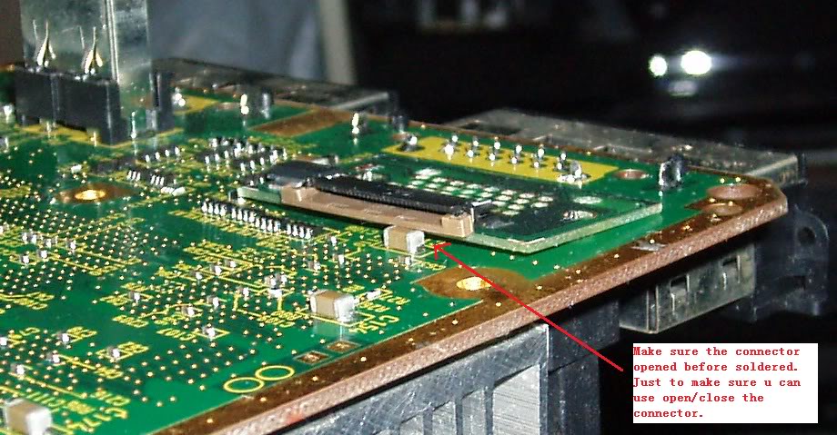

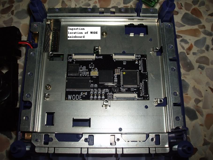

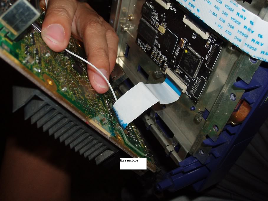

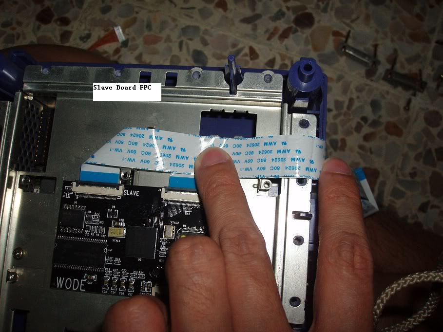

This initial stage tutorial are made only for Emu-Kidid who on testing on my adaptor.
Soldered it.
Assembled the mainboard top metal casing.
Conenct Slave FPC to WODE Slave Board.
Connect 5V and GND to Slave Board.
Turn ON.
(112.16 KiB) Not downloaded yet

Could anyone please explain to me in more detail what the shorting wire on the main wode board is for?
@emu_kidid: Any more news on when or if these adapters will be available? I've got everything I need now to install the Wode and was wondering if it's worth waiting for one of these adapters or to just try and solder directley to the FPC cable.

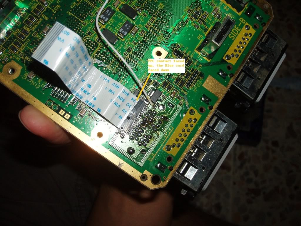

So I finally installed it, and I'm having issues with getting a Wiikey Fusion working. It blinks and blinks but I get the "Error the disc could not be read" message. All my switches are correct too. No difference with a 1.9v/GND switch. I noticed when I put the lid switch to closed and I haven't hit the GND/1.9v switch I get "Reading disc" flashing rapidly back to "Please insert a Gamecube Disc".
I've double checked all my points and they're solid, only thing I haven't checked is if the pin mappings are correct on the board itself. Also, the on board 3.3v wasn't very reliable so I wired it up directly. Neat little adapter if I could get it working right!
