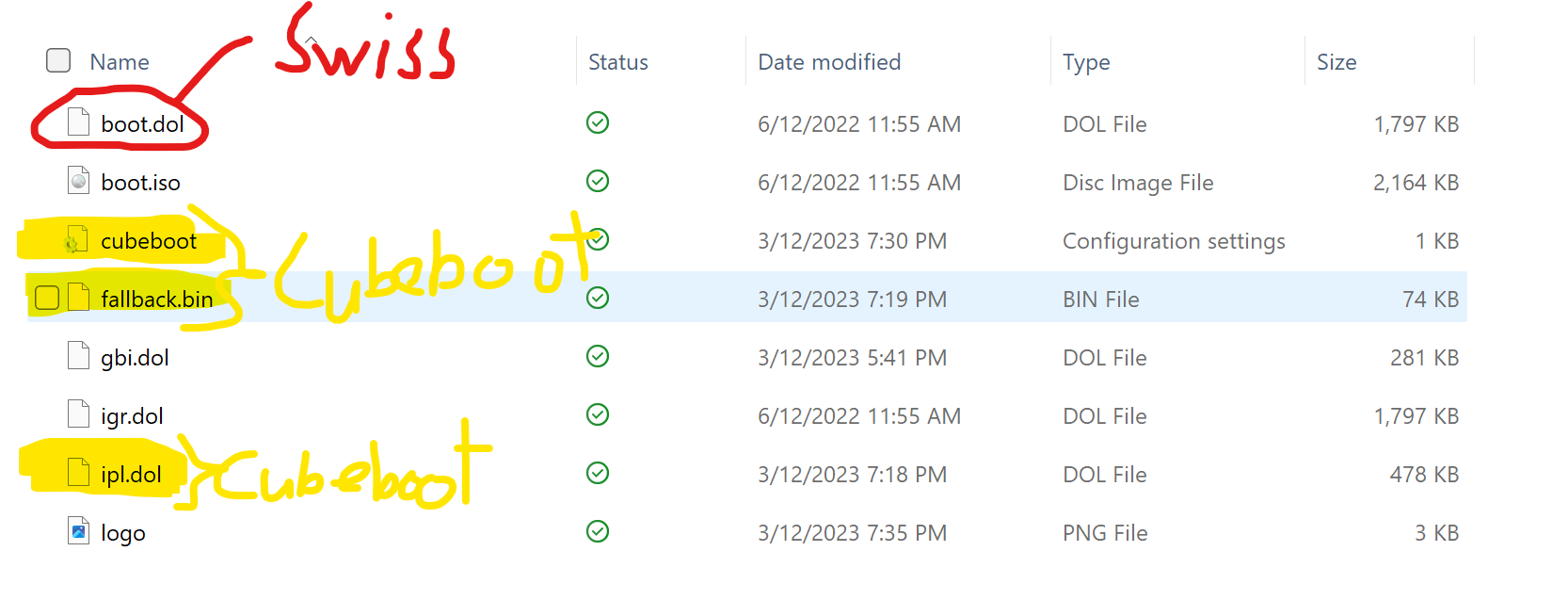

Has anyone had any luck with using Cubeboot https://github.com/OffBroadway/flippyboot-ipl/releases ? I tried to use it following these instructions https://youtu.be/Vij3upNyOsQ. However no matter whether I renamed my usual Swiss DOL (which I typically have named IPL.DOL) 'boot.dol' or 'swiss.dol' like the video instructs, the result was the same: the Cubeboot logo title screen would play, but would only go into the stock Gamecube no-disc boot menu. I could never get it to load to Swiss.
I'm running Swiss Release 1336 on a DOL-001 Picoboot modded GC using SD2SP2. I've attached a screenshot with the files I'm using, which hopefully helps illustrate

Okay. So that video didn't work for me either. Here's what you need to do. Follow most of his video to the T but when you get to the coding part make it look like this.
cube_color OOfff
force_fallback = 0
force_progressive =1
default_ program= boot.dol
preboot_delay_ms = 500
postboot_delay_ms = 3000
You may need to change progressive fallback to 0 if it doesn't work then try again. You can use the website he recommended to pick a color. I'm not 100% sure if this is exactly right to copy and paste it. But once I get home in a few hours if it doesn't work I can copy and paste from my SD Card and it will forsure work for you then.
