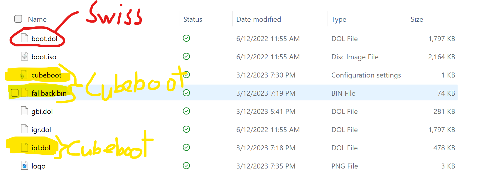

Hi all!
Has anyone had any luck with using Cubeboot https://github.com/OffBroadway/flippyboot-ipl/releases ? I tried to use it following these instructions https://youtu.be/Vij3upNyOsQ. However no matter whether I renamed my usual Swiss DOL (which I typically have named IPL.DOL) 'boot.dol' or 'swiss.dol' like the video instructs, the result was the same: the Cubeboot logo title screen would play, but would only go into the stock Gamecube no-disc boot menu. I could never get it to load to Swiss.
I'm running Swiss Release 1336 on a DOL-001 Picoboot modded GC using SD2SP2. I've attached a screenshot with the files I'm using, which hopefully helps illustrate :D
Sorry BTW….I could’ve found a better sub forum to post this in. My apologies.

Post by Therealkush » Mon Apr 24, 2023 12:46 pm
Okay. So that video didn't work for me either. Here's what you need to do. Follow most of his video to the T but when you get to the coding part make it look like this.
cube_color OOfff
force_fallback = 0
force_progressive =1
default_ program= boot.dol
preboot_delay_ms = 500
postboot_delay_ms = 3000
You may need to change progressive fallback to 0 if it doesn't work then try again. You can use the website he recommended to pick a color. I'm not 100% sure if this is exactly right to copy and paste it. But once I get home in a few hours if it doesn't work I can copy and paste from my SD Card and it will forsure work for you then.
