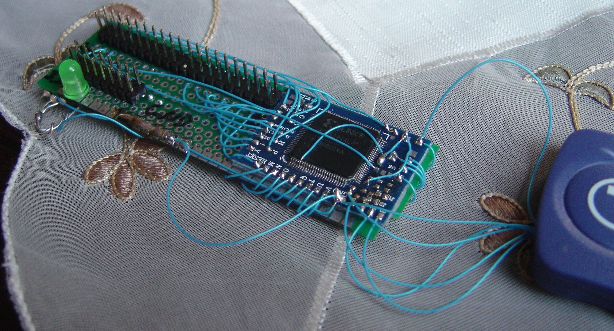

It seems my question may have been answered in one way or another :roll: , Since the CPLD legs could be used directly, the componants i was asking about wouldn't be needed so long as I made sure the solder pads were connected to the legs of the CPLD.
Got my adapter working and fit it into a nice tidy case, shame about the ebay power adapter blowing after 2 mins of use, using an old pc PSU for now :P

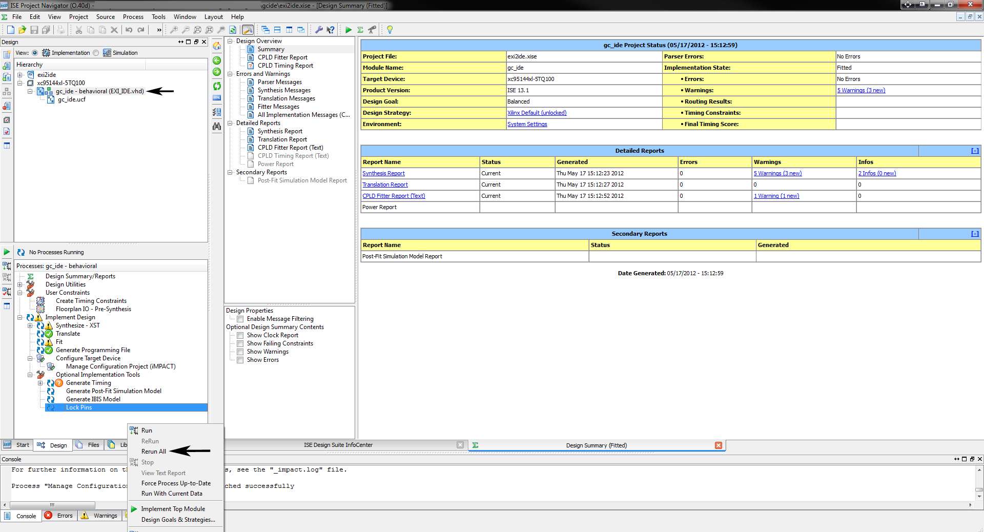

emu_kidid wrote:the changes you make to the .ucf file are not recognized until you rebuild the project. I had made this same mistake. see in "Building the firmware" at http://www.gc-forever.com/gchdd/build.htm
Can somebody take a screenshot of this?
I can't find it in iMPACT or the SDK ver. 14.1, and I suspect that the programming part is what's blowing my party.
Also, what happens if you try ide-exi in swiss without an HDD connected?
Is it detected?
(Also sorry for the necro, but I don't think I should open a new thread for something that has already been semi-answered here.)
dilav
Posts: 111
Location: USA
Re: Homebrew HDD adapter for Gamecube Tutorial
Post by dilav » Thu May 17, 2012 10:22 pm
SouLSLayeR wrote: Can somebody take a screenshot of this?
Is it detected?
Does this help:
Not sure what exactly you are trying to do. With no HDD connected, Swiss does not detect anything.
(171.07 KiB) Not downloaded yet

Post by SouLSLayeR » Thu May 17, 2012 10:37 pm
Oh, Project Navigator :o
What the heck, I'll download the whole package just to be sure I got it :P
It's just that I don't feel the cpld is programmed correctly for some reason.
And after reading yamaharacer's (I think) troubles and downloading his bluechip v9 .ucf and rechecking every pin with every pad...again, nothing happened.
So I realized that even though I had a different .ucf, I didn't do anything different in the programming procedure...like loading a different .ucf somehow.
(it's a pain having to connect the hdd every time, the PSU is in a weird spot and has fairly short wires :< )
Thanks for the pic ;)
