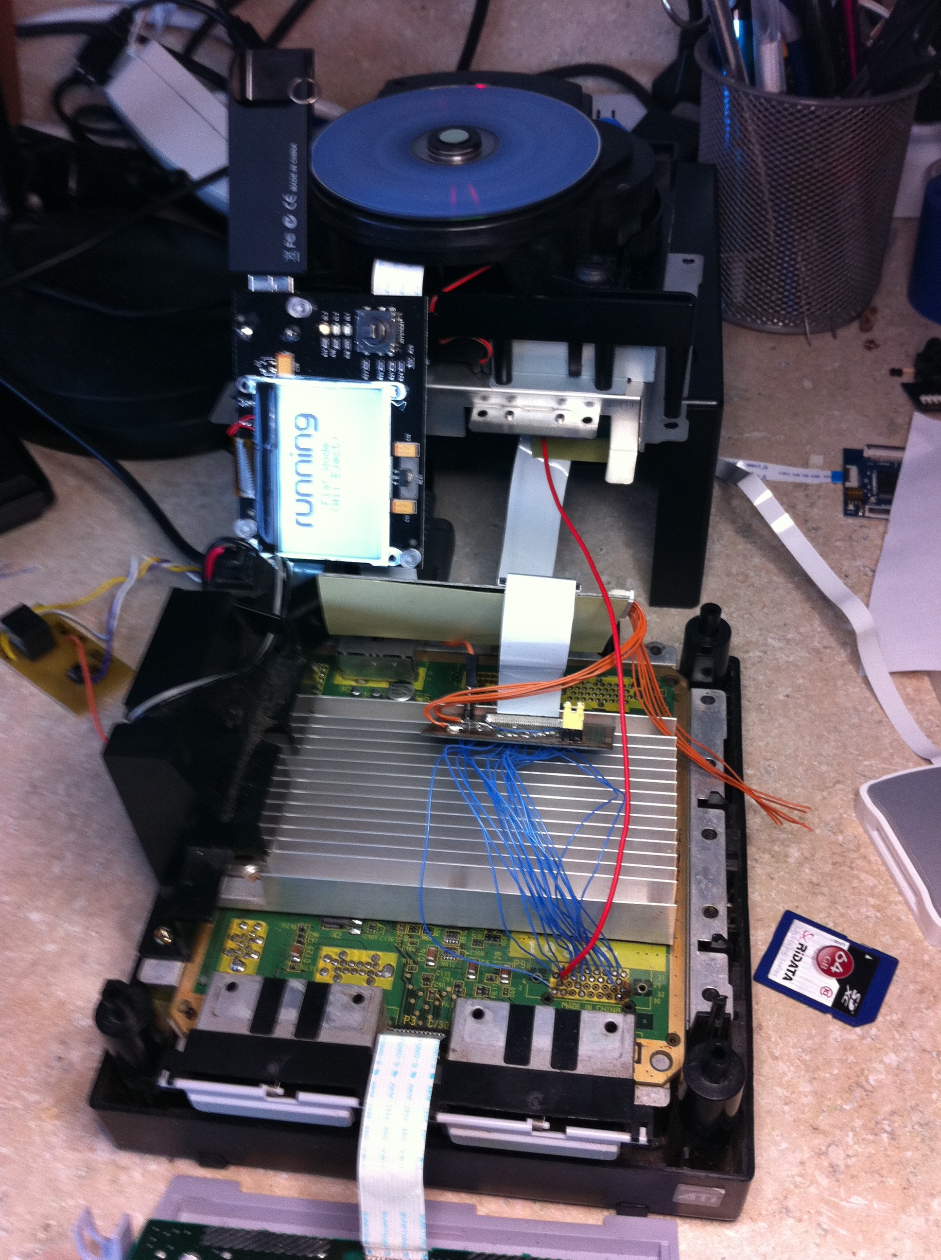

Post by megalomaniac » Mon Nov 12, 2012 11:44 pm
WODE!!!!!!
not much to say about wode, it just work....
here is a quick pic of my testing conditions....
yea wires.....why? because i am not gonna drill 0.5mm holes x 32
so i made a larger version of the replacement port design that has the exact same layout and connections....but a lot easier to make at home and easier to work....
so ignore the wires as they will not be required for production version...
the blue wires are are from the mainboard to the DVD REPLACEMENT PORT ADAPTER
the orange wires are wode power...note: all required wode power available on the DVD REPLACEMENT PORT ADAPTER (12v not required)
FFC cable from DVD REPLACEMENT PORT ADAPTER to WODE MAINBOARD
FFC cable from WODE MAINBOARD to DVD INSERT under the GC drive
red cable 5v power to GC drive
disc is spinning, initialized, and ready to play...
STATUS:
WODE VERIFIED, READY FOR USE!!!
WKF still testing
edit: after thought...i need to go dig out a streaming audio title...
(2.56 MiB) Not downloaded yet
