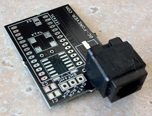

i wanted to post this before i forget again....
the pinout for the fiber optic connector is a direct pin match to the PCB..
so you can directly solder the connector to the board or run extension wires and header pins for quick disconnect...
more pics will be posted later of an actual installation...
(72.9 KiB) Not downloaded yet

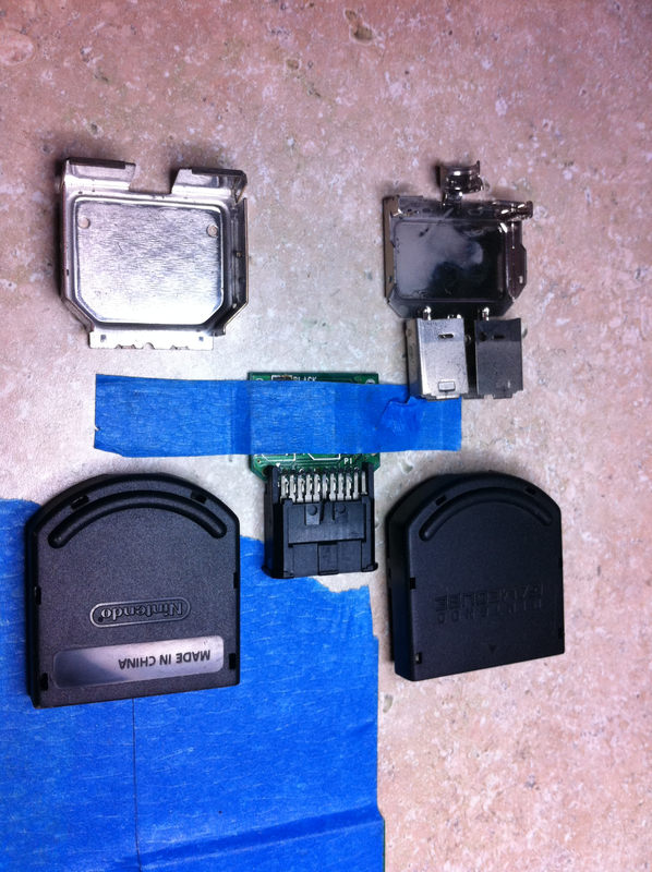

if you mean to say you already have a component cable and want to tap into it, i would advise against...
can it be done? yes
but the digital port only provides 3v and 12v...the fiber optic circuit requires 5v
so the easiest way to add audio is to wire internally...
if you really need to have an external audio connection, then you need to add a LM7805 regulator to convert the 12v power to 5v...
also you will have to open the component cable housing and pry open the metal shielding without damaging it...
it can be a little tricky for someone their first time...
(585.39 KiB) Not downloaded yet
