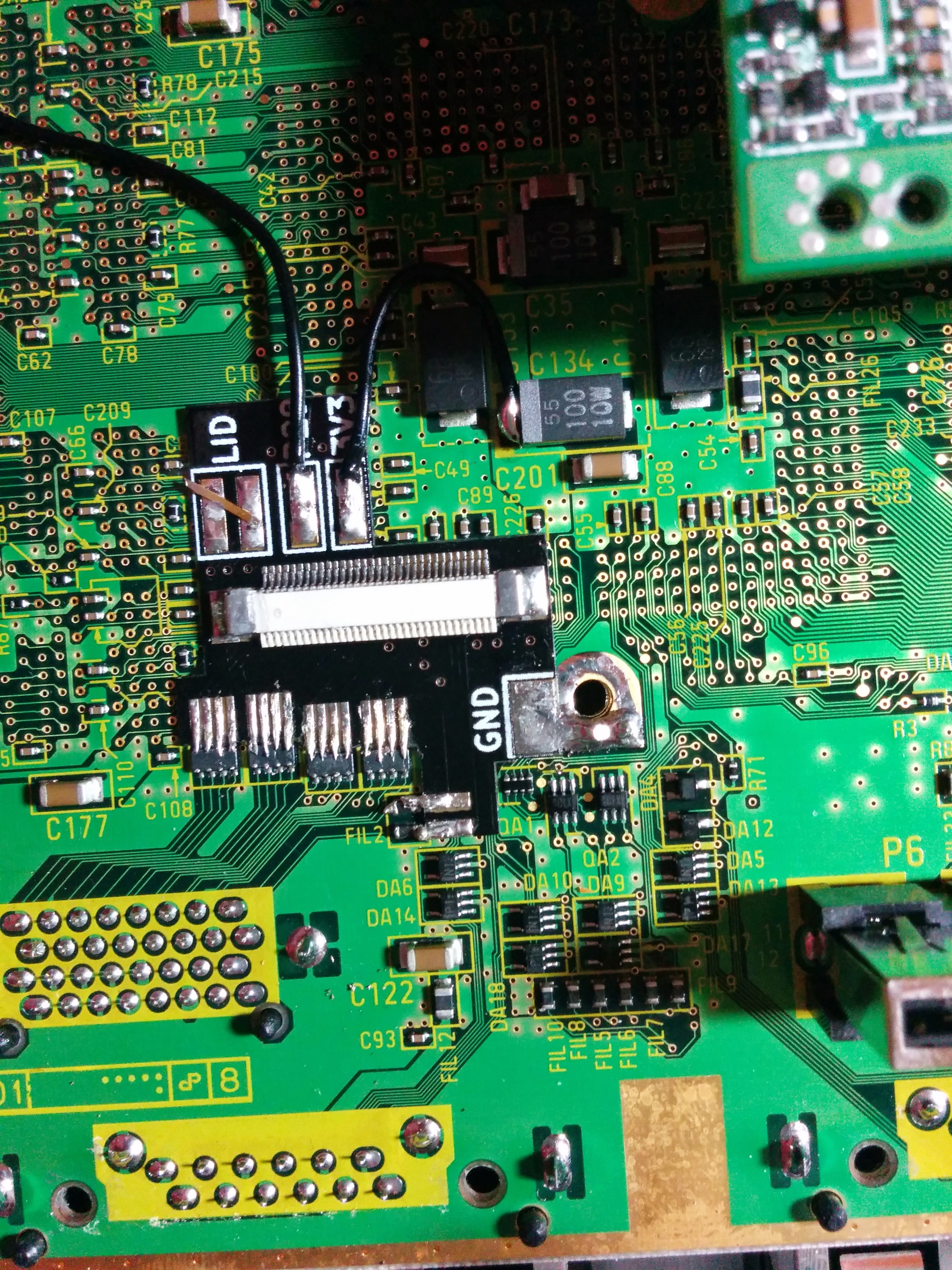

Is it possible to leave the DVD connector in tact when installing mega v6? Or does it cause shorts?
- (2.22 MiB) Not downloaded yet

nice solder job..its a little tricky at first till you get the hang of it eh?
you can leave the DVD connector there no problem....just do not have a DVD drive attached onto the connector else you will have data conflict/collision and boot issues.
Re: mega drive v6 install
Yeah, you can use the drive if you unplug the wasp though.

Thanks for the reply! And yeah the solder was tricky but I did got the hang of it. It would have been easier I'm sure if I didn't shake like a crack head when I solder. The board is perfect though. Amazing design. Do you use CAD software to design the PCB? I only wonder because I keep thinking I'd like to make some nice SD geckos. I'm pretty good with auto CAD but I've never used PCB design software.
My wife took my Beer Away!!!!
He uses PCB artist if I recall correctly.
