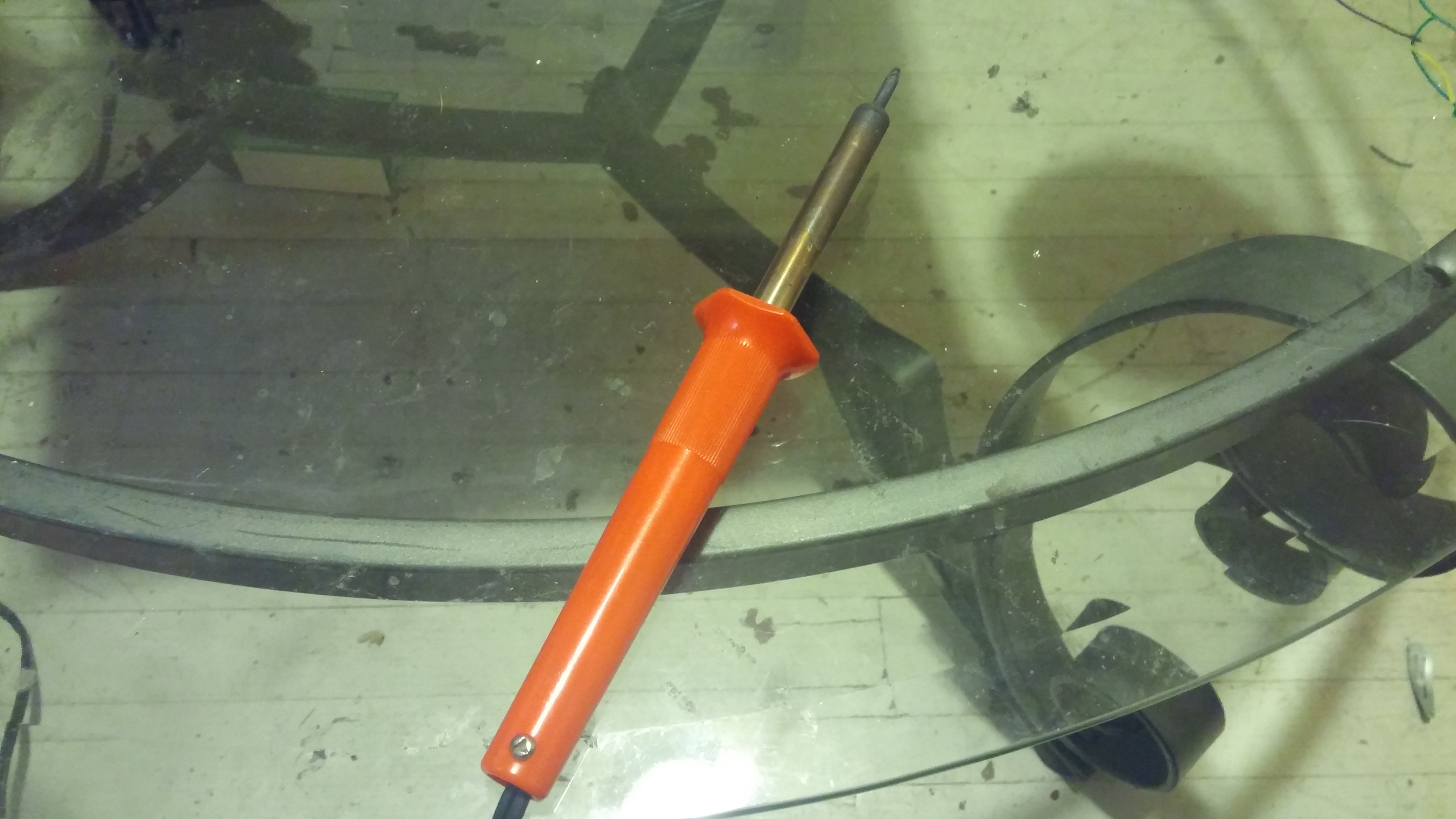

while most of these clones are much better than the lightning rod iron you currently own, they will only be a partial upgrade to what you are currently using...
your current iron is 15w...
the aoyue 936 is 35w...

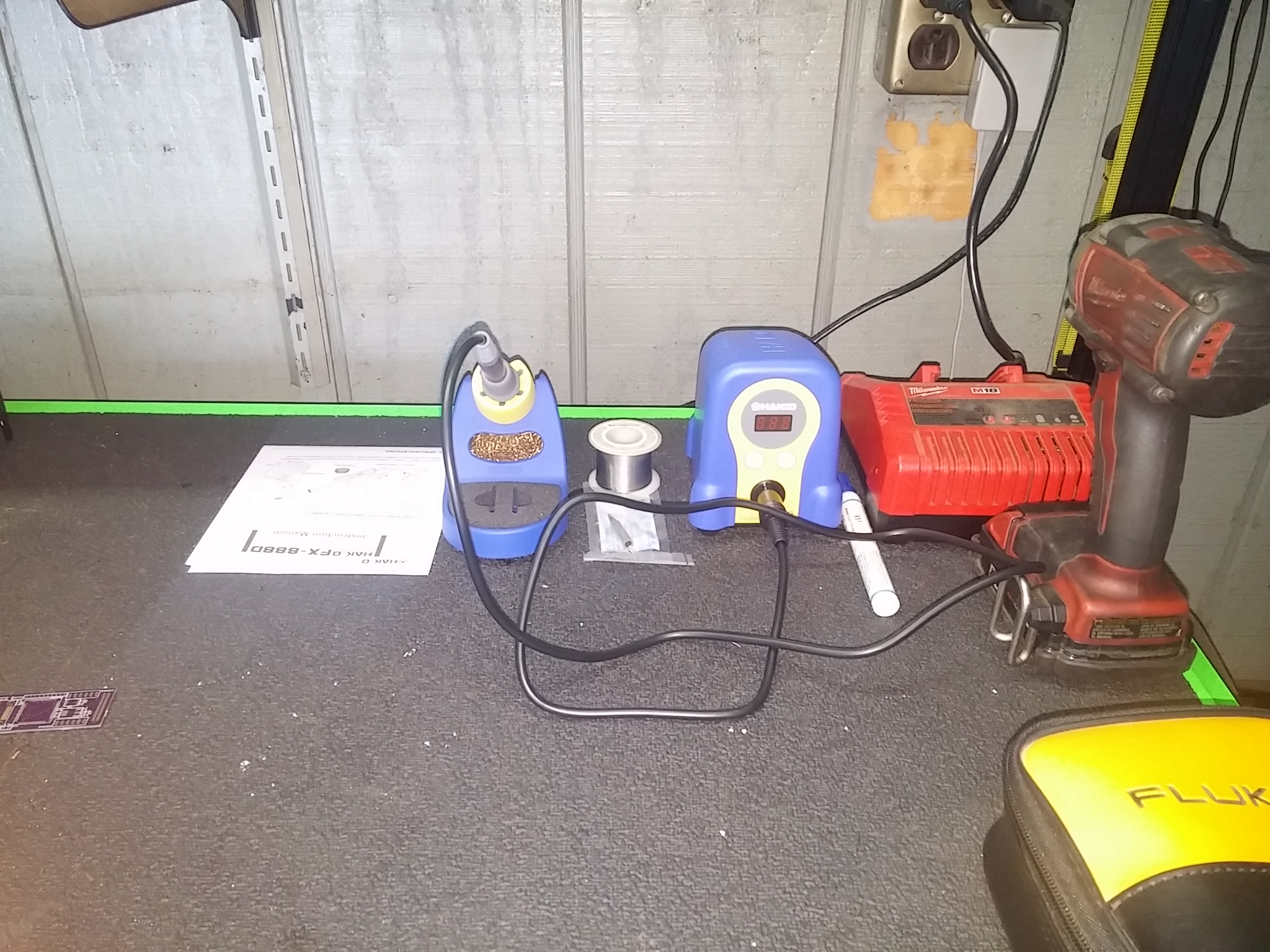

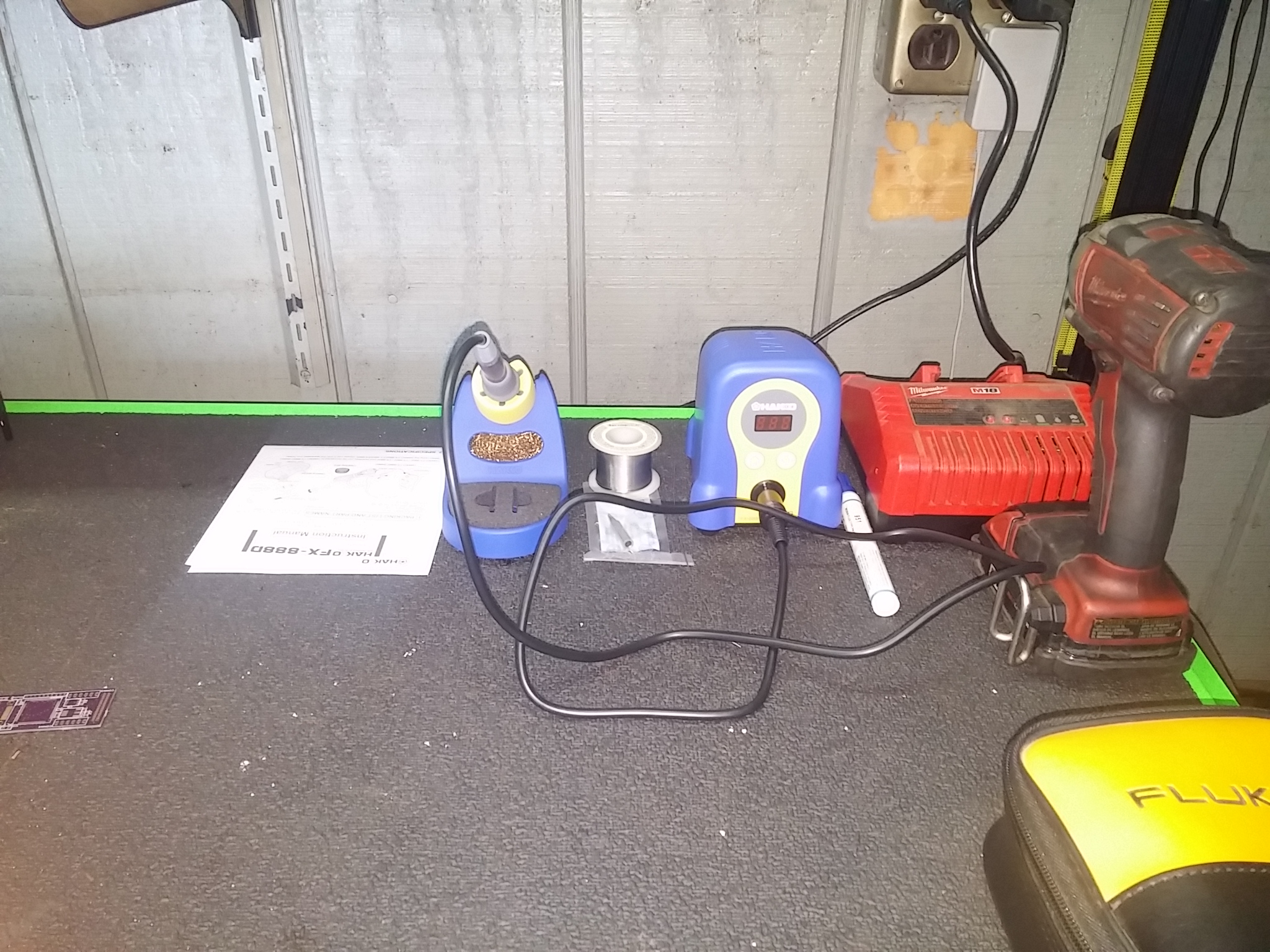

Hakko FX-888D ordered hopefully it was a good investment. I will hold off on ordered some tips till I get the hakko and have a go with it. I'm completely new to temp control this will be a learning experience. Need some broken PCBs to test with oh and those hot tweezers next month I'm ordering them that is exactly what I need to desolder it's awesome
@mega 850°f! Jesus I don't want to vaporize traces. I'll start at 600 and go from there. What's up with the 951 flux and do you use leaded or unleaded solder. I use 60/40 lead free but I'm thinking of switching to leaded. FYI home depot has the hakko fx888d as well

I knew the soldering on the ide-exi wasn't up to par but considering the soldering iron I was using I don't think it was that bad. At least I will have a proper setup by next week. So what do you use leaded or unleaded I understand the different melting points but also doesn't lead solder make your tips last longer because of lower tinmegalomaniac wrote:i think you need to play with lead and lead-free to understand the different melting points and how each type flows onto a component or pad..

My Hakko FX-888D came in the mail today. Looks very nice blue/yellow isn't my color of choice but it's fine when I get my work area cleaned up I will take a picture. Did some simple soldering just to get a feel with the new iron and wow so nice heats up fast as shit. I'm still waiting for 2 more parts for the shuriken video so finally can do some testing since the user won't sell me one no worries I will just build one myself then make a video. So I will have all 3 cloned component devices tested last on the list is GCvideo-lite 0.9 which I know I'm going to like the most. That project will take me a little long to make because I want that internally installed no more crazy wires jetting out the back of my cube.
