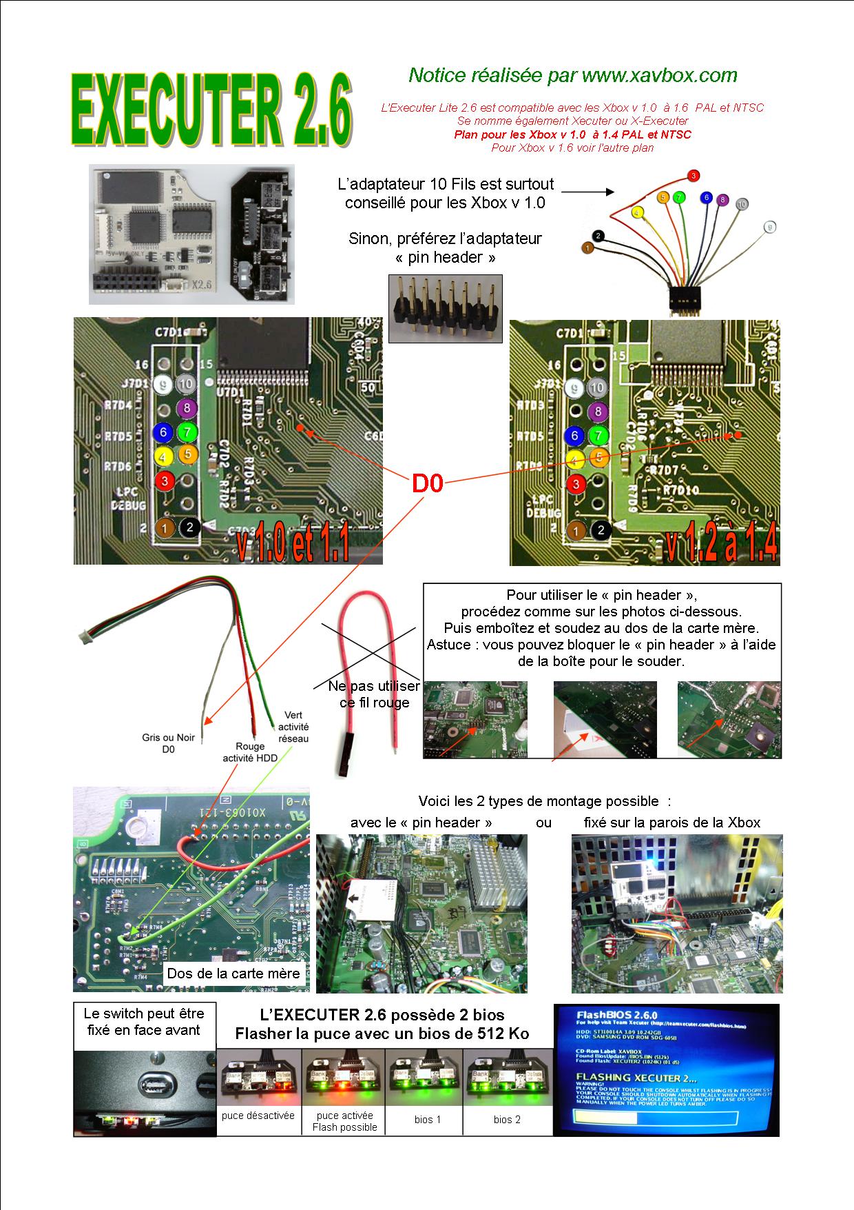

You can install the modchip on the tsop flashed Xbox, turn the x2.6 off with the dipswitch and boot from the tsop, once the hacked dashboard is running, turn the modchip on and start flashbios it should let you flash the xecuter in that way.

Cool thank you when I get setup a bit I will install the modchip I have it removed already and in a antistatic bag. I must rewire the connector that goes to the remote first then find some pinheaders I know I have some around. This is the reason I need to cleanMadowax wrote:You can install the modchip on the tsop flashed Xbox, turn the x2.6 off with the dipswitch and boot from the tsop, once the hacked dashboard is running, turn the modchip on and start flashbios it should let you flash the xecuter in that way.
Re: how to flash Xecuter 2.6 CE without programmer
The d0 point should let you switch from tsop flashing to chip flashing and viceversa, if disconnected, your flash program should see the tsop chip, if connected the modchip one, just double check which nand the flasher discover before flashing. I have done this a couple of time, back in the days, to do the reverse operation you are trying, flash the tsop while booting from a modchip and it worked no problem. If someone remembers it differently please correct me, it was a long time ago and maybe I remember it wrong.
