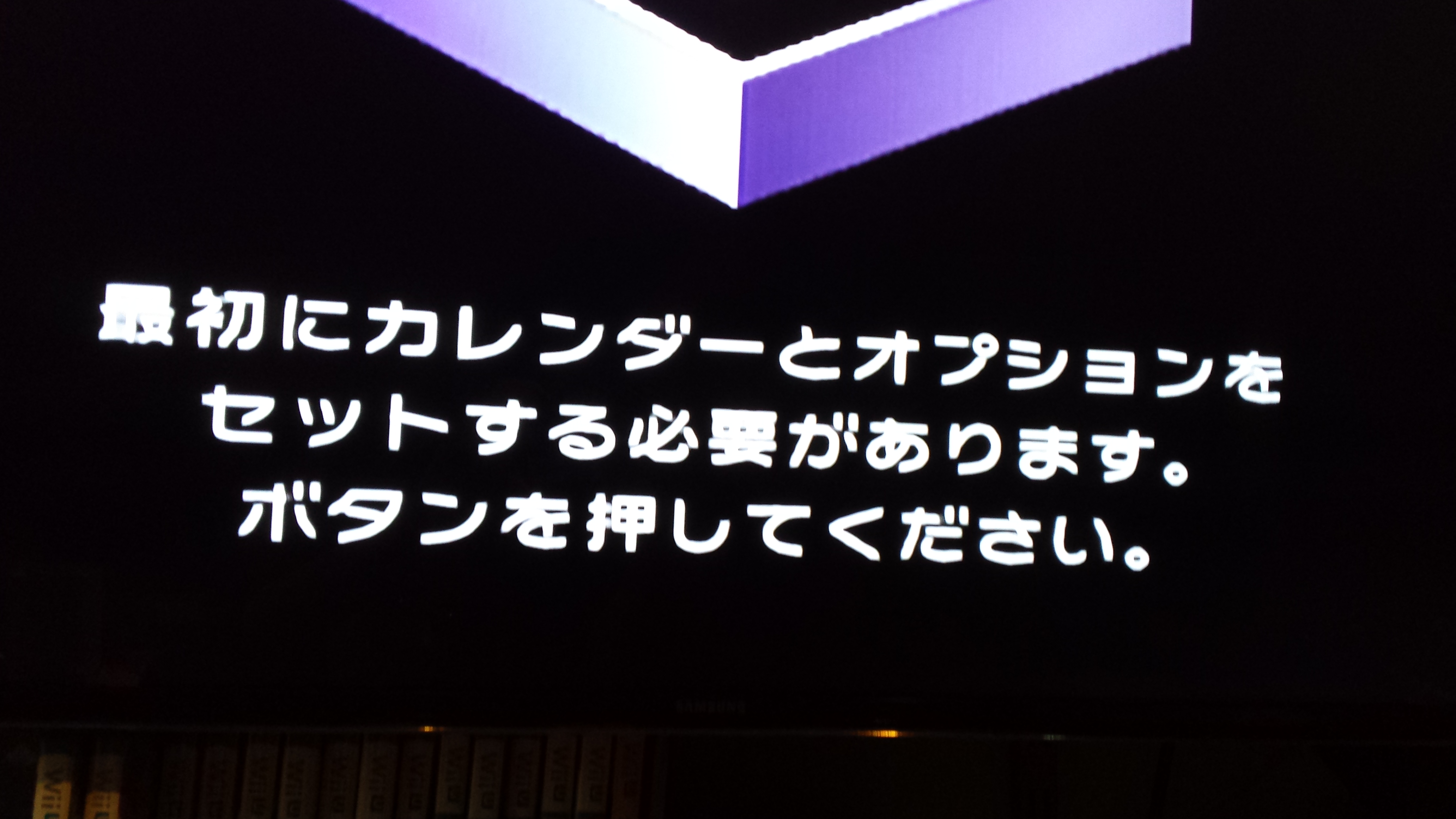

I have mingled a little bit more with it and bent the ribbon (in the case it has an inner interruption of connection). I was right with this assumption. Got control working for a few seconds. Next time I restarted the cube it gives me an odd error message:
It says that the calendar and options are not set up. I think it happened because I removed the front panel which has the bios battery

Re: Controller ports not working
Correct.CosmoCortney wrote: It says that the calendar and options are not set up. I think it happened because I removed the front panel which has the bios battery

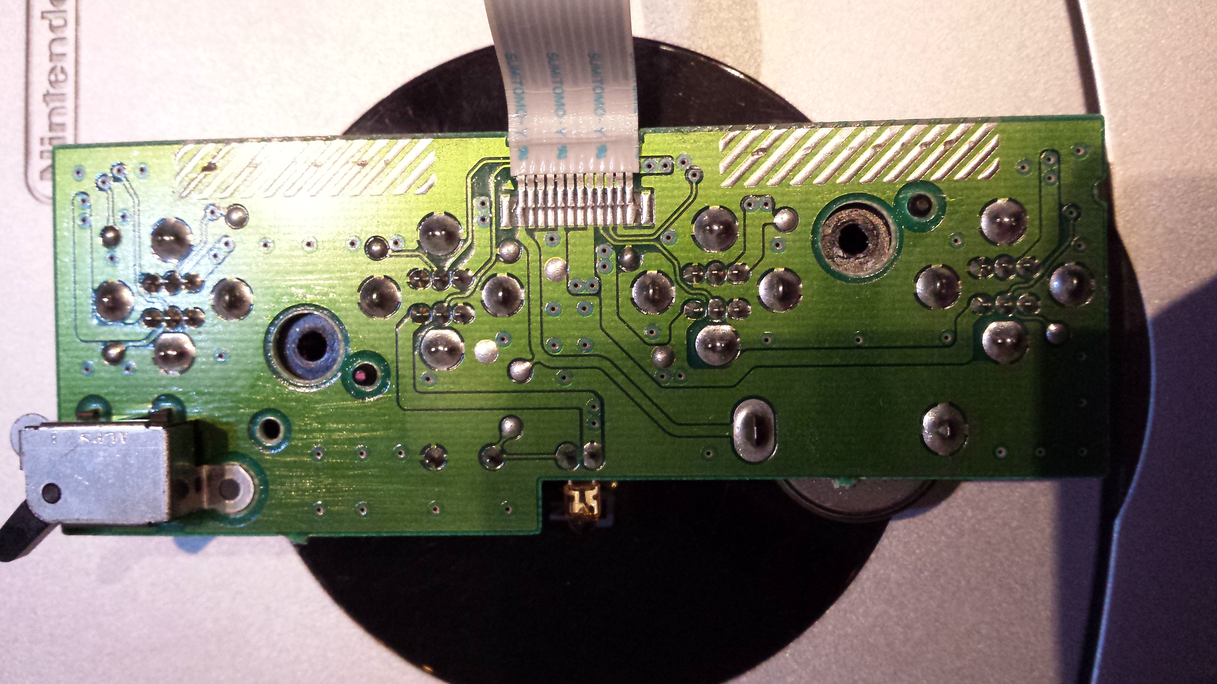

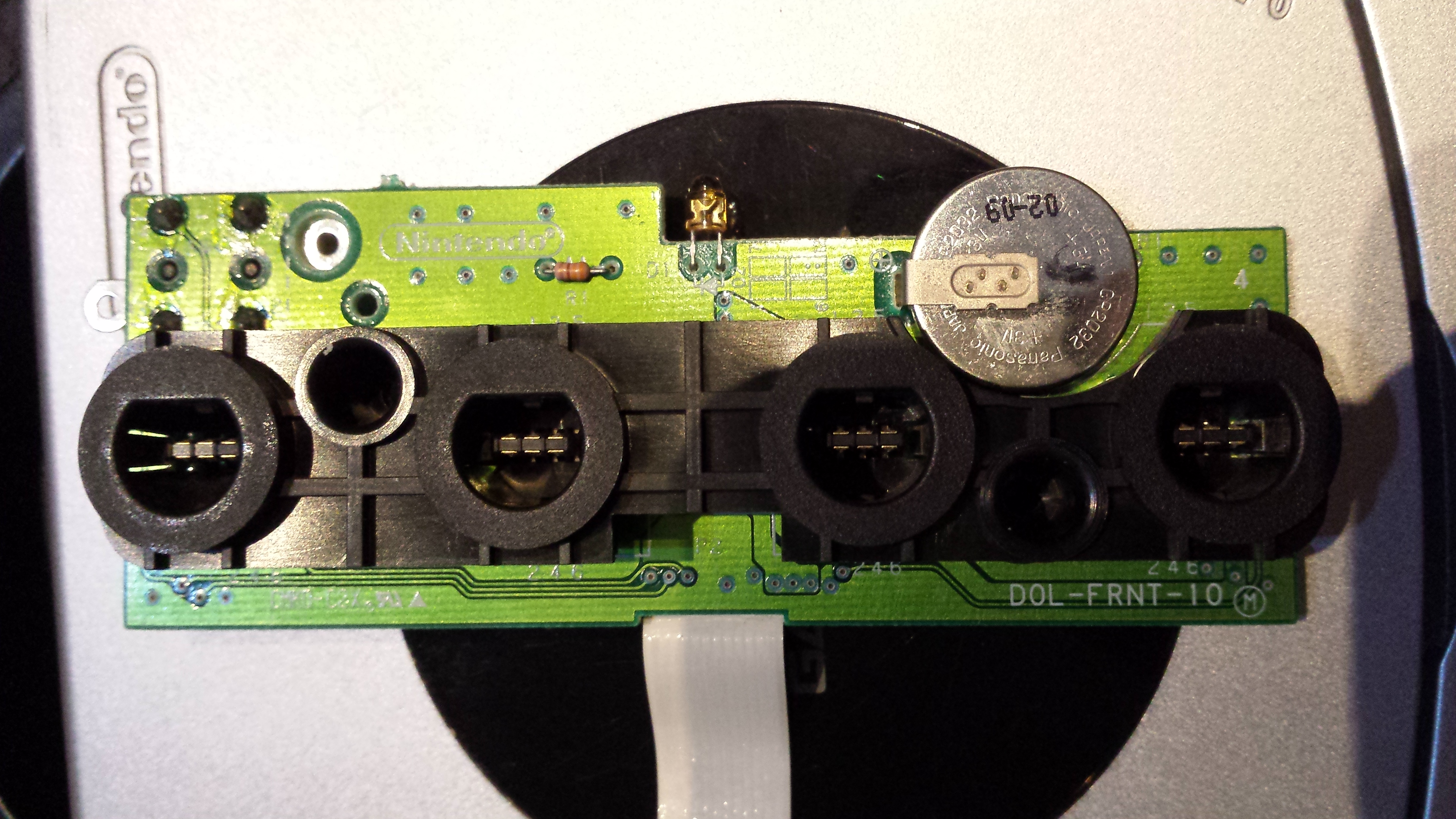

Yes, also removed it. Here're some pics:
It looks like the Led is showing signs of wear.. Im not sure exactly if that also links into the controller data line.. but if you see no other signs of wear/broken traces it would be a good place to start. Btw Badassconsoles.com sells working controller boards for a buck. it may take a couple of weeks for shipping but hey its only a dollar.
The LED doesn't matter, it's probably the cable that is broken.
Thanks! But the shipping costs to Germany ar $13.50. With luck I could get another cube for that moneyZEN_KYLE wrote:It looks like the Led is showing signs of wear.. Im not sure exactly if that also links into the controller data line.. but if you see no other signs of wear/broken traces it would be a good place to start. Btw Badassconsoles.com sells working controller boards for a buck. it may take a couple of weeks for shipping but hey its only a dollar.
Well, I have got a broken wii some time before. Is there a fitting ribbon cable inside?
Yep, just seen that by opening it. That's sad. But hey, there're fitting ones around the web. This one looks very decent to me. 12 lanes and 13mm wideStreetwalker wrote:No there isn't, the controller ports are mounted right onto the mainboard in the Wii.
EDIT: Gonna try if i can find out which lane is broken to bridge it with another cable
EDIT: Gonna try if i can find out which lane is broken to bridge it with another cable[/quote]
if all else fails you could use kynar wire or similar to individually make the connections. just be sure to use short lengths of wire and mark where each wire goes to be sure its correct. im not sure of your comfort with soldering, but there is a plethora of tutorial videos on YouTube and since you have those nice pads to solder to it shouldn't be too difficult. good luck! I hope this is useful
