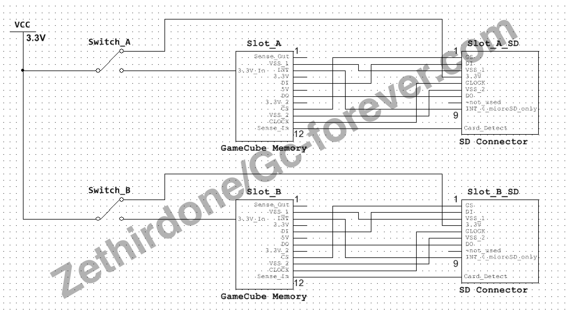

Also, I made out a little schematic to try to use a switch to swap between front memory or Sd that I would put in back of my console (If I ever want to copy a saved file from A to B). It wouldn't be more complicated as I got plenty of push-push Sd card connectors to mount one on each slot. Would that be really useful to have two sd instead of one?

Don't answer all at the same time! I did a schematic on my free time to explain how I would proceed.
I would cut the vcc trace that go to each memory slot, and would power them with a 1P2T switch to choose if I want to power the front slot or the sd adapter. From what I understood from my SD connector, the card detect pin return the vcc signal if a card is inserted and the sense in(pin 12) is expecting 3.3v(high level) when a device is connected. My only incertitude is because a card is still inserted in the front slot, all the signals are merged together, but the front card is not powered. I think that it would not interfer with the SD adapter but i'm not sure. If it is the case I would need to use something like a 8 poles double throw switch to break all signal from SD and memory Slot.
Re: SDgecko DIY slot inside gamecube
You won't need the SD gecko in slot A. You don't need a power switch either, just have the SD card sense switch short sense in/out on the GC when a card is present.

So only one card in slot B is use, but I want to leave both card inserted and only switch from sd to memory card when I desire, leaving both connected at the same time on the same pin, the GC would send data to both and also read from both(would make probably errors). But I understand what you want to suggest me is simply insert SD and Remove memory card or the opposite.
Apply the switch to the CS pins, not the 3.3v line
CS is active low.

I thought to use the chip select signal, but if I break only CS and and the front slot is selected with the switch with no card inside, sense will still be HIGH from the sd card detect. That's why I thought cutting the power to one or the other would make appear them as disconnect.Aurelio wrote:Apply the switch to the CS pins, not the 3.3v line
Good to know.Streetwalker wrote:CS is active low.
On the other end, two pull up resistor to each CS pin and break it with a 2p2t switch, I could use at the same time the same switch on my sense signal to avoid detecting a card on the other slot.
What do you think?
