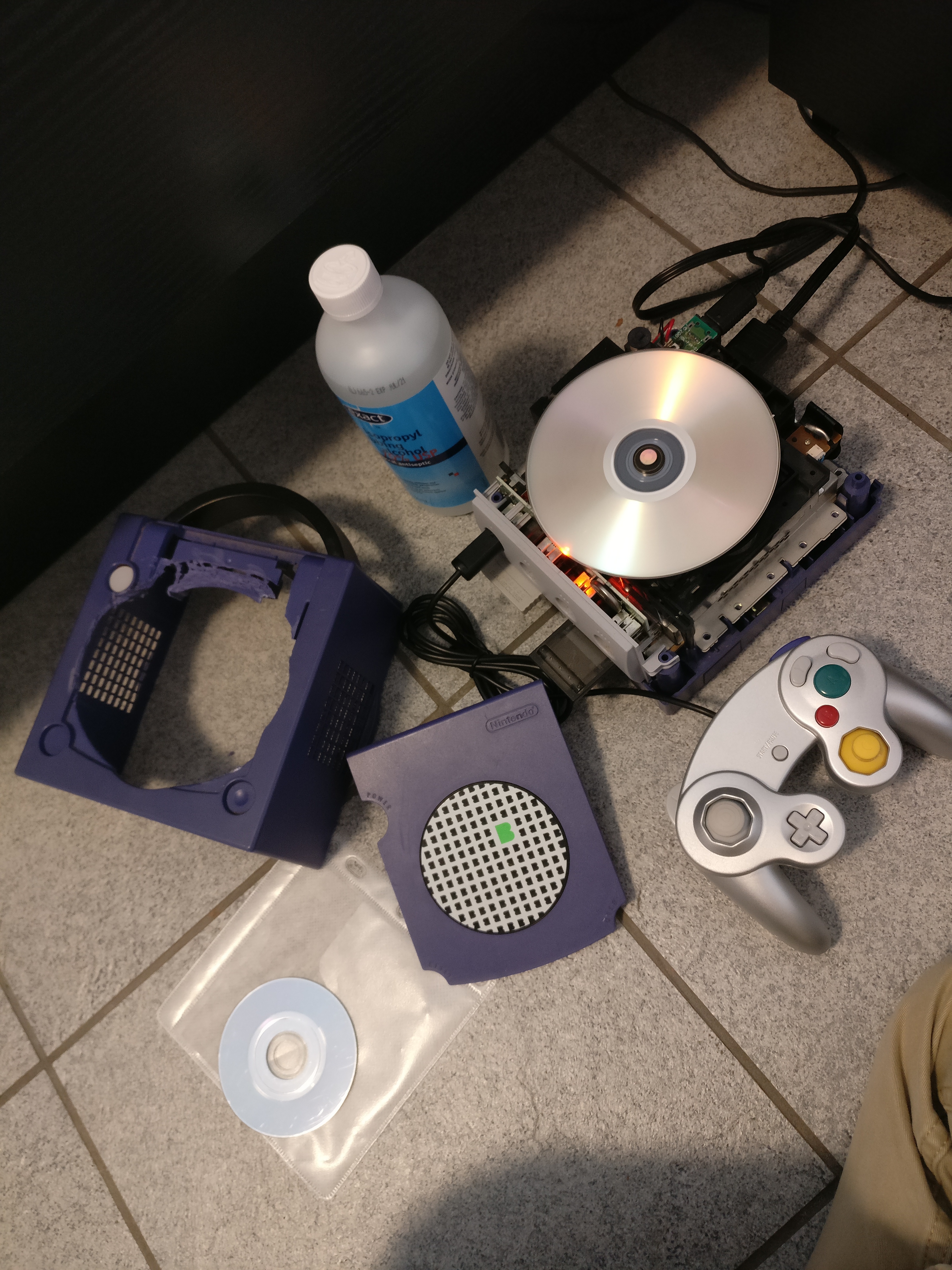

Attached here is a picture

Nvm... 2 minutes into the game the disc stops spinning and says an error has occurred and to restart.. What now? Is the laser too weak?
