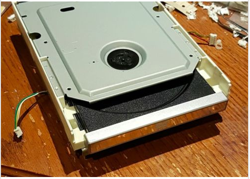

It's true, the Q's disc tray almost always break. So, a buddy and I came up with a 3D-printed model replacement. What do you guys think? We've done a trial and it ended up working flawless. We also do Region Mods for Gamecube's with a disc tray replacement as a service. It hasn't been a hot seller as of yet, but we just finished a week or two ago.
if i could buy a couple of cd trays off you that would be grate, also on your ebay listing you say contact us for questions but dont have that function enabled

I'd also be interested in one.

Slypty wrote:Gamecube's with a disc tray replacement
Now that sounds interesting for me. Would like to see how that replacment fits into the gamecube. :)
Hadn't been on the forums for a while and don't even have the Q originally mentioned, but I would still be very interested in this. What sort of price would it sell for?
