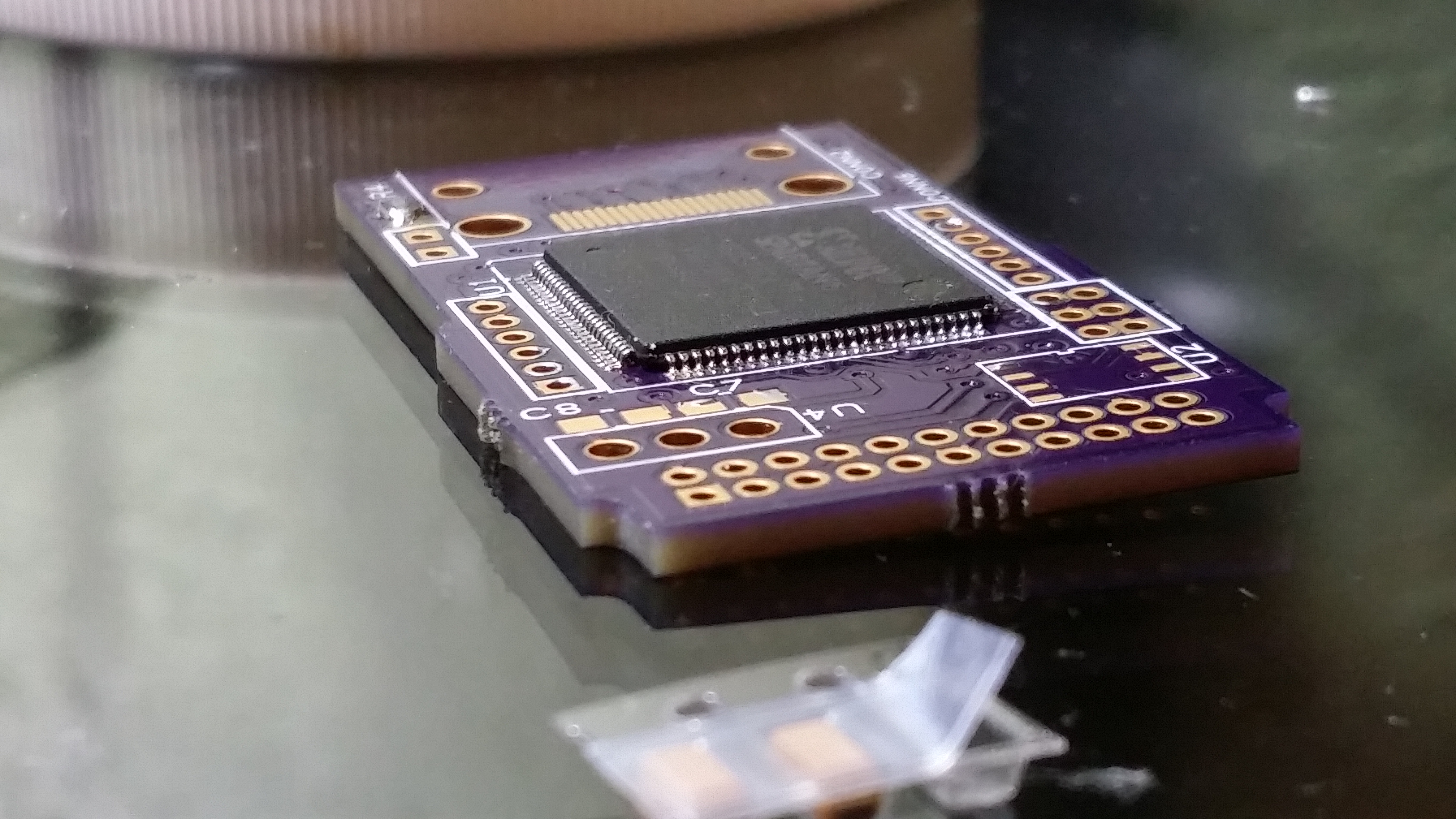

Starting a Shruiken V3 build. Soldered the FPGA on earlier today.
Mostly done. Not sure where JP1 is. I'll need to learn how to connect it for programming. I don't have a programmer so I may try the parallel port method.
I am not 100% certain how to orientate U2 and C7. I used pics I saw online to compare.
