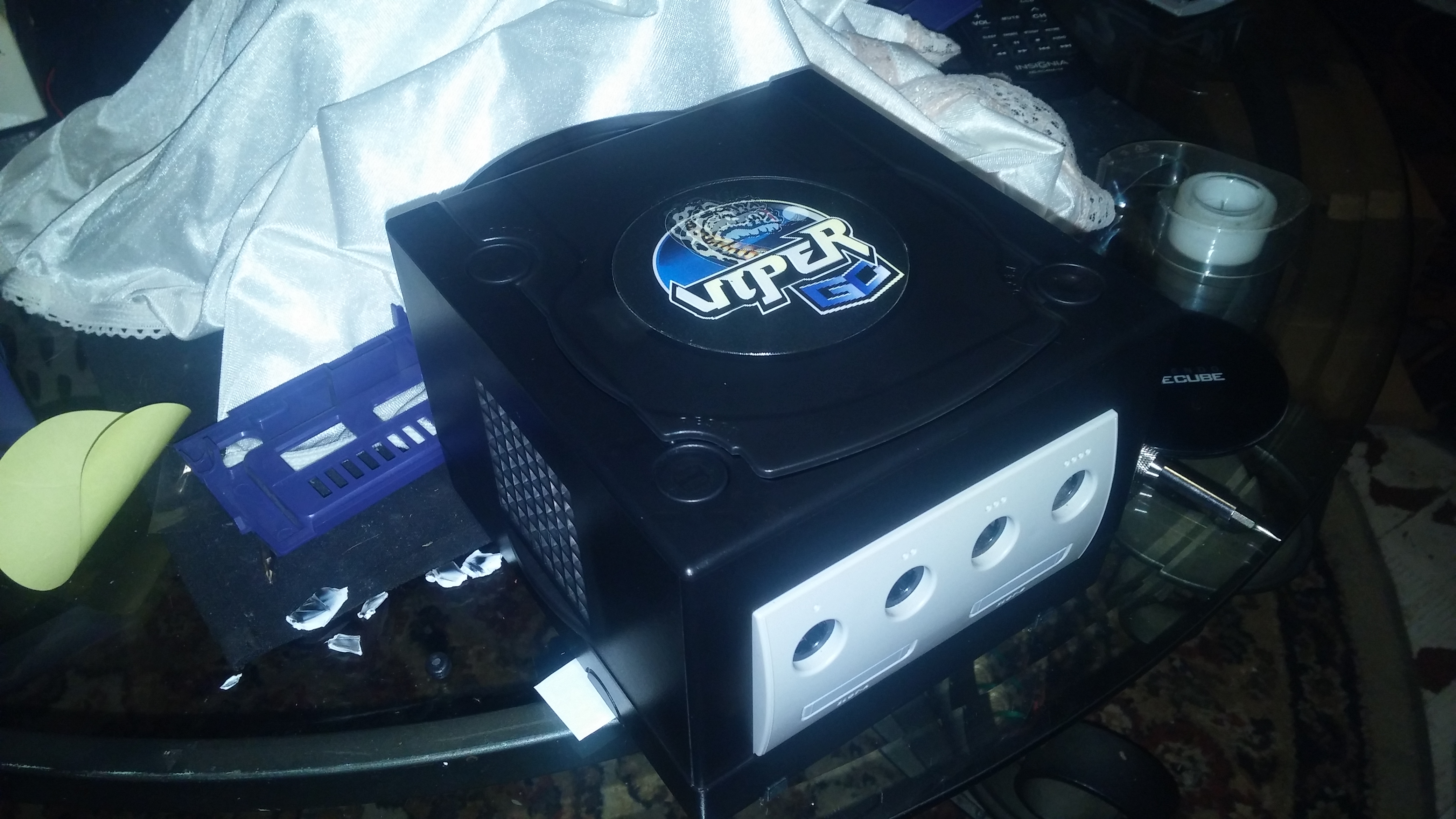

I just got my full case replacement made by viper gc crystal black and there is this usb board mounted on the back under the av ports. There is a mirco usb and full size usb port with a ffc type connector does anyone know what this does and what it connects to?
Re: Viper GC
Post by novenary » Thu Feb 25, 2016 11:24 pm
Probably to replace the parallel programmer.
andre104623
Posts: 694
Re: Viper GC
Post by andre104623 » Fri Feb 26, 2016 1:00 am
Streetwalker wrote:Probably to replace the parallel programmer.
Well I thought that also but there is a slot on top of the a/v ports for a parallel port for viper gc. I figured that I cant plug it into the viper gc extreme because there is alot of components on the usb programmer that this board doesnt have. I like it though has a door that opens to access the usb ports very cool.
Posts: 4948
Re: Viper GC
Post by emu_kidid » Fri Feb 26, 2016 2:03 am
yeah there's not much use for those, it was intended for USB programming.
andre104623
Posts: 694
Re: Viper GC
Post by andre104623 » Fri Feb 26, 2016 3:35 pm
Thanks for the info guys. This cube looks great
