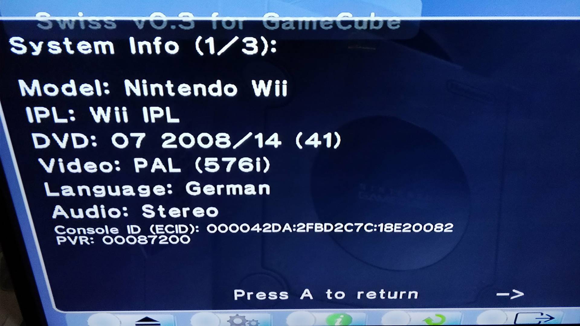

Could you go into the "Info" section of Swiss when the wode is connected/current device and let me know what it shows there for "DVD Drive" version?
There's some crude detection in the latest Swiss 0.4 code to auto-detect if a WODE is present but it currently assumes one hardcoded drive version response from it: https://github.com/emukidid/swiss-gc/bl ... ODE.c#L132

I know, I'm actually using 0.4 for applying cheat codes on some games. I think there was either a bug, that WODE was not working or that I couldn't get the swiss ISO to autoboot.
emu_kidid wrote: Could you go into the "Info" section of Swiss when the wode is connected/current device and let me know what it shows there for "DVD Drive" version?
It's a friend's Wii, I'll ask him to take a photo.

Post by andzlay » Sat Jan 13, 2018 2:25 pm
Hey!
I got the photo with the DVD drive version: It says 07 2008/14 (41).
It's from swiss 0.3 r174 autobooted from the WODE.

Post by emu_kidid » Tue Jan 16, 2018 2:25 am
OK - so it should've detected it :(
