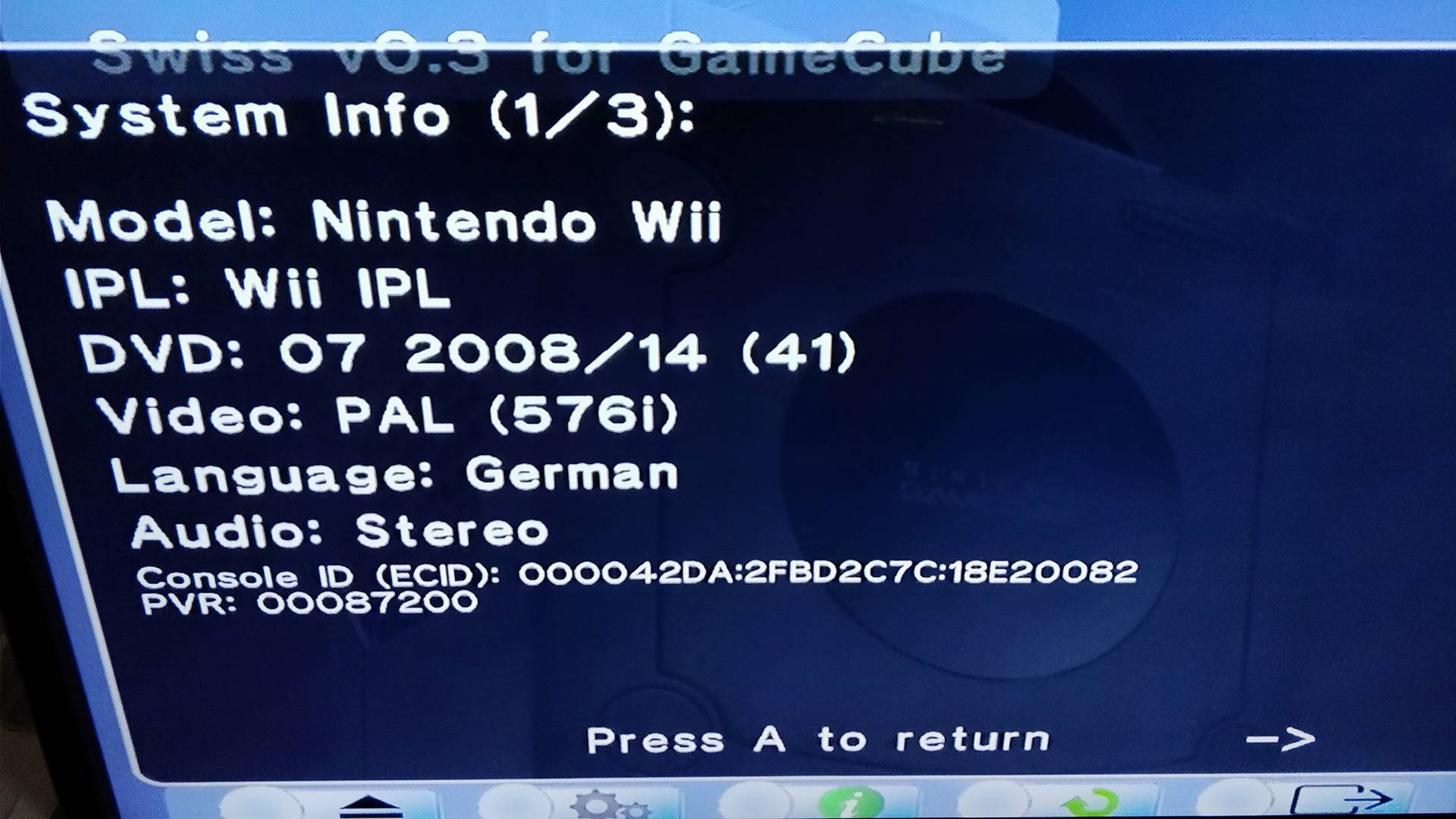

emu_kidid wrote: Could you go into the "Info" section of Swiss when the wode is connected/current device and let me know what it shows there for "DVD Drive" version?
It's a friend's Wii, I'll ask him to take a photo.

Post by andzlay » Sat Jan 13, 2018 2:25 pm
Hey!
I got the photo with the DVD drive version: It says 07 2008/14 (41).
It's from swiss 0.3 r174 autobooted from the WODE.
(157.77 KiB) Not downloaded yet
Posts: 4506
Re: Using a WODE on Wii with Swiss
Post by emu_kidid » Tue Jan 16, 2018 2:25 am
OK - so it should've detected it :(
