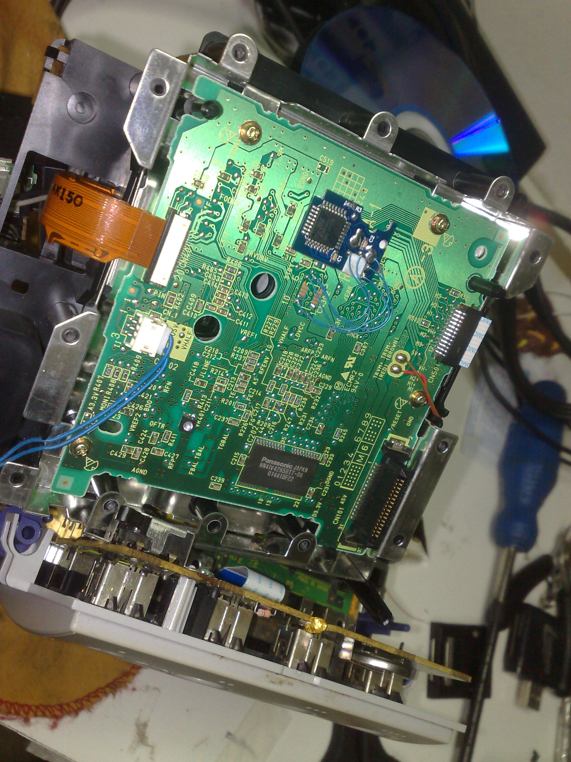

:D Hello my friends thanks, wiikey is working on my gamecube, thanks to everyone who helped me without even knowing it, without it this topic would not be possible, I would still be trying to find a modchip fo my beloved cube.Image
(1.05 MiB) Not downloaded yet

skygames wrote::D Hello my friends thanks, wiikey is working on my gamecube, thanks to everyone who helped me without even knowing it, without it this topic would not be possible, I would still be trying to find a modchip fo my beloved cube.
Er, well I'm very happy for you, but you probably posted this into the wrong section.

skygames wrote::D Hello my friends thanks, wiikey is working on my gamecube, thanks to everyone who helped me without even knowing it, without it this topic would not be possible, I would still be trying to find a modchip fo my beloved cube.Image
Nice job!
Also very handy, as there is a huge amount of Wiikeys compared to Xeno's. :)
