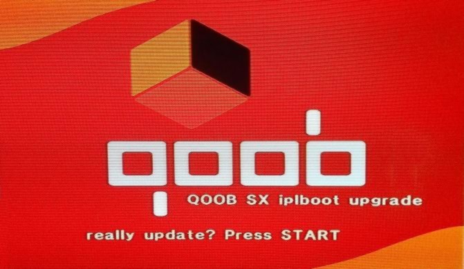

I hope you don't mind, I have just made a little change to your ELF! Now it shows the text "QOOB SX iplboot upgrade" instead of "QOOB SX upgrade to 1.3c" which it not true!
(90.82 KiB) Not downloaded yet
I also build an ISO everyone can burn on DVD and upgrade:
QOOB_SX_IPLBOOT_UPGRADE_ISO.rar
(1.04 MiB) Downloaded 1767 times
