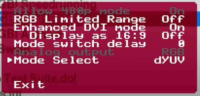

Post by Srandista » Sun Apr 07, 2019 9:10 pm
It's in EON options.

Post by Mr. T » Sun Apr 07, 2019 9:12 pm
Okay so to be clear, if I set both the analog output and digital to dyuv, I get a wonderful green hue on my OSSC due to using a scart cable and not a component cable?

Post by Extrems » Sun Apr 07, 2019 9:17 pm
Now you need to select YPbPr mode on your OSSC's AV1 input.
