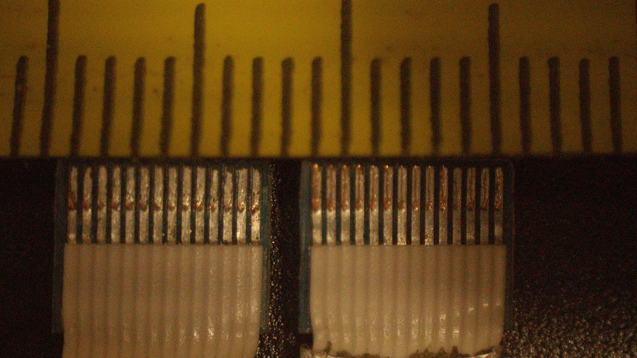

So i have managed to get a programmer (which I didn't think I would find) although it is untested.
Only problem is it doesn't come with a FCC cable, so I need a little help on which one to buy ?
Could anyone share these details on the ribbon please -
1, how many pins
2, pitch (0.5mm or 1mm)
3, direction (forward or reverse)
4, approximate length

Re: Viper GC
1. 14kup11 wrote: ↑Thu May 11, 2023 8:36 amSo i have managed to get a programmer (which I didn't think I would find) although it is untested.
1, how many pins
2. 0.5mm? (see picture)
3. Forward (same side)
4. exactly 220mm

Those are not 0.5mm pitch, unless the ruler isn't of the metric kind!

i have the full setup, i will replace the battery in my calipers tomorrow and measure the pitch

it was quite tricky given the size but i'm getting 14pin 0.35mm pitch but it looks like 0.5mm would work and that's a standard pitch so i'd try that.
without opening the console i'd estimate the cable is about 25cm long.
for me in the uk, this seems like it would be a good replacement:
https://www.ebay.co.uk/itm/173080054798 ... 6oQAvD_BwE
