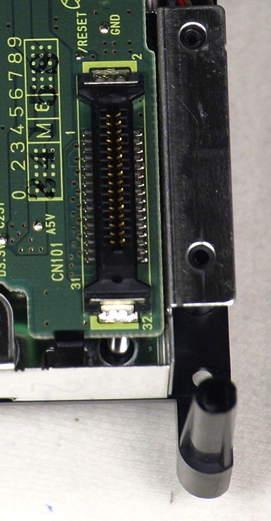

Re: Wii DVD & Wiikey Fusion + GC Portable Discussion
Post by Ashen » Tue Mar 22, 2011 10:43 pm
The part that is the issue is the male connector for the GC DVD drive. If someone could find that connector with the pins attached I could easily solder up 100+ of them to an adapter board in a day or two.
Alas, the dvd connector is nowhere to be found. Therefor no solderless adapters.
epoch
Posts: 54
Post by epoch » Wed Mar 23, 2011 4:38 am
Ashen wrote:The part that is the issue is the male connector for the GC DVD drive. If someone could find that connector with the pins attached I could easily solder up 100+ of them to an adapter board in a day or two.
The one labeled CN101 on the bottom of the optical drive assembly board? in the corner?
(296.9 KiB) Not downloaded yet
Posts: 4971
Post by emu_kidid » Wed Mar 23, 2011 4:41 am
yessir
