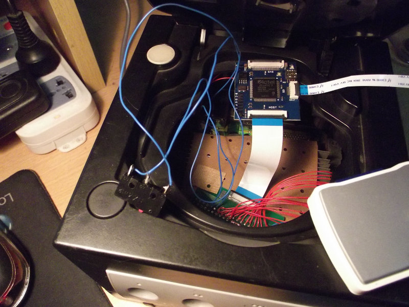

Mikog: the circuit board in the foreground is the portable GC. Ashen doesn't have it in the case yet. The laptop seems to be displaying the video output.

It was only running for 10 or 15 seconds there to test the board, hardly enough time to toast the chips. They will be properly heatsinked soon I promise.Dragoon wrote:Well the cutting is fine, a portable has to be small :p
Just don't fry your little cube
Darkmystery wrote:Hehe, this made me laugh.
Correct. I was just being lazy at the time and vid capture software on my netbook was the easiest way to test video and sound. Since I butchered my PSone screen that I was using and havent had time to troubleshoot it yet.doktor_krotch wrote:Mikog: the circuit board in the foreground is the portable GC. Ashen doesn't have it in the case yet. The laptop seems to be displaying the video output.

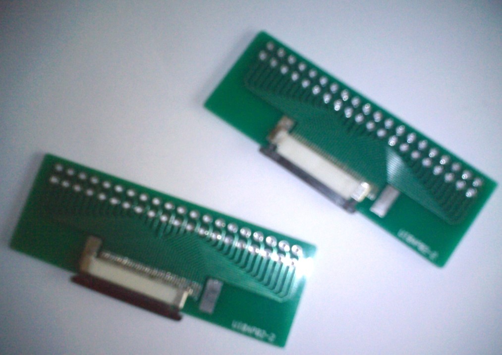

Recently found this nice pieces of hardware:one,two
They may be alternatives (to not solder on the flat cable directly) to the adapter mentioned earlier in this thread. Only if size is not important, of course.
I am also looking for the gamecube dvd drive connector, i found a very similar one produced by foxconn in dell laptops (see one side here). I think foxconn has a matching connector for us. Unfortunately they will not provide any bulk connectors to private individuals...

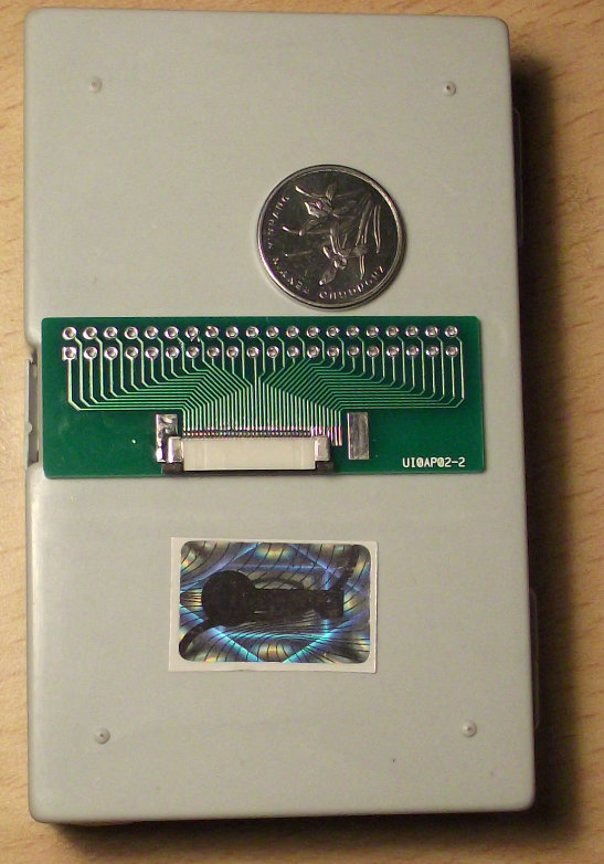

My converter board arrived yesterday. I bought the converter board and plug and asked the seller to solder them together for me . It costed me 2.8 us $ each without freight.
I purchased them from http://www.taobao.com, the biggest e-business site in China.

Wow, Those are great finds guys. Might be a more viable option than the proto advantage connectors. I will add those links to the megaguide. 2 adapters from protoadvantage cost me around 38$ shipped. Its been about 2 weeks and they are still not here yet... Finding a replicant of the male GC DVD connector is going to be a major pain in the ass I think. I've been looking all over also and havent had much luck. On the lighter side of thing my fusions should hopefully be here tomorrow or Monday. Keep in mind you may need to update the fusion to v1.5 firmware on a Wii. I didn't see this until today but it looks like they didnt add GC iso image support to the SD side of things till firmware v1.3
Edit: Bearteam can you get me direct links to the exact webpages you ordered from on that site. I can't read chinese
Ashen, here are the links.
http://item.taobao.com/item.htm?id=6598834882
http://item.taobao.com/item.htm?id=5686938034
You need to talk to the seller to ask him to solder them for you, I don't know whether the seller can understand English.
My Gamecube with Wiikey fusion.

That's strange, some of my NTSC-J games could run ,but some just hang on when the GC logo shows.
Paul.str, I attached to red wires to the Gamecube main board as Ashen shows in another thread.
Very nice bearteam! As for the games that hang, are you sure they are good dumps? Might be wire length too. Looks awesome though.
Maybe the reason is that my ISO is the one in which the garbage is removed. I can run the original ISO of Batman - Dark Tomorrow, but if I remove the garbage, it just hangs at the time when Gamecube logo shows.Ashen wrote:Very nice bearteam! As for the games that hang, are you sure they are good dumps? Might be wire length too. Looks awesome though.
