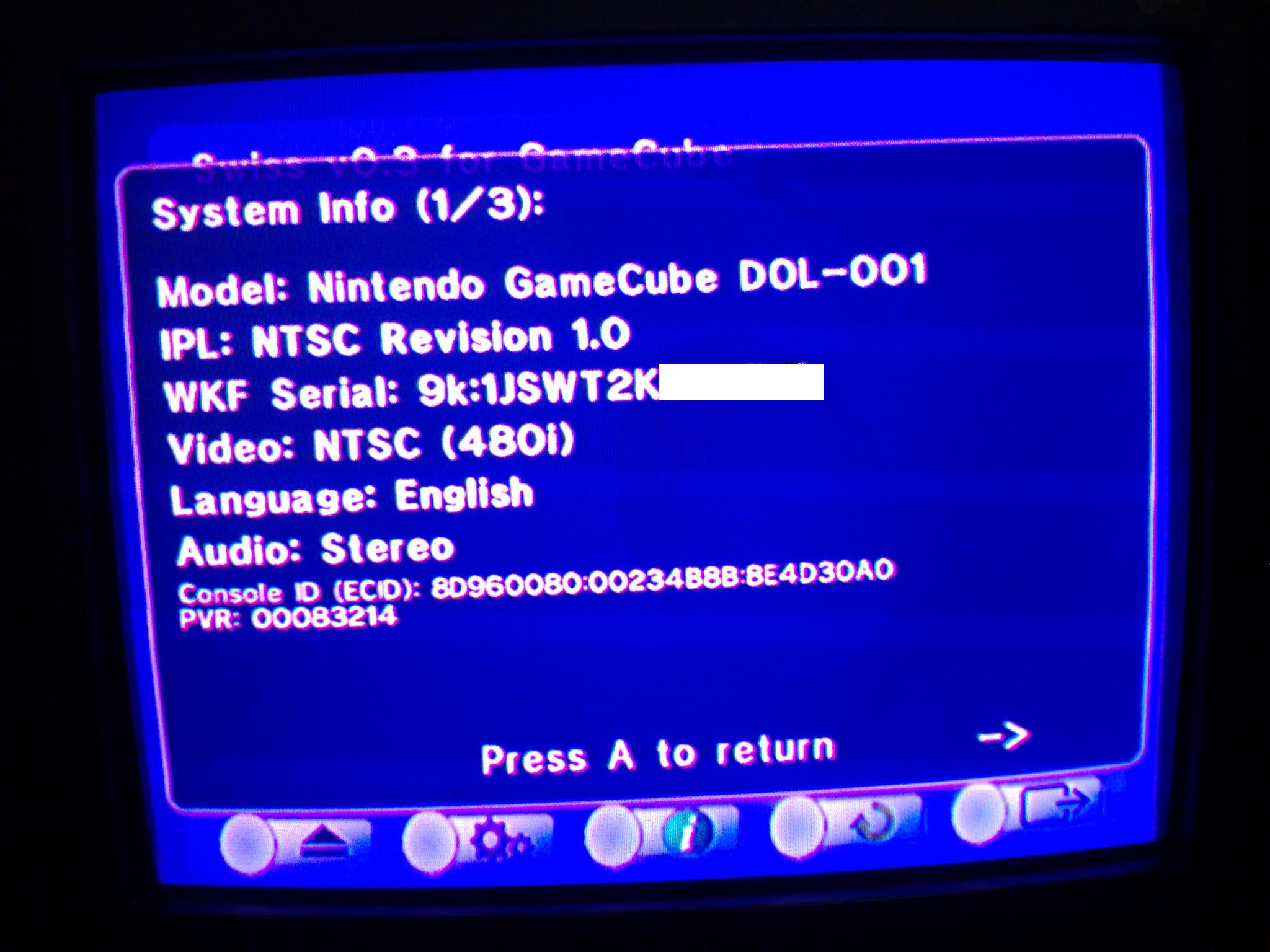

Post by bearteam » Mon Oct 01, 2012 10:23 am
exp0wnster wrote:I've been doing that, but it still freezes. Do you happen to have any pictures of your work? Thanks
Do you mean this one?
(286.88 KiB) Not downloaded yet
Re: Flash Swiss to Wiikey using a Wii?
Post by Ashen » Mon Oct 01, 2012 12:43 pm
You need to get a proper normally closed momentary switch for the eject button. SPST/SPDT switches have already been said to be unreliable. Even on IPL v1.1+ boards. If I have time I'll make a little video of an NTSC IPL 1.0 board working, and how to boot it properly.
Posts: 4971
Post by emu_kidid » Mon Oct 01, 2012 12:44 pm
Yes, SPST/SPDT switches are very unreliable, I can tell you all that for a fact as I was extensively trying to use one during Swiss development and it made it a very difficult process.
