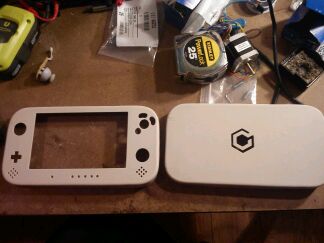

Casing:
Case is almost ready to be shipped to me, gman only needs to cnc then it is done.

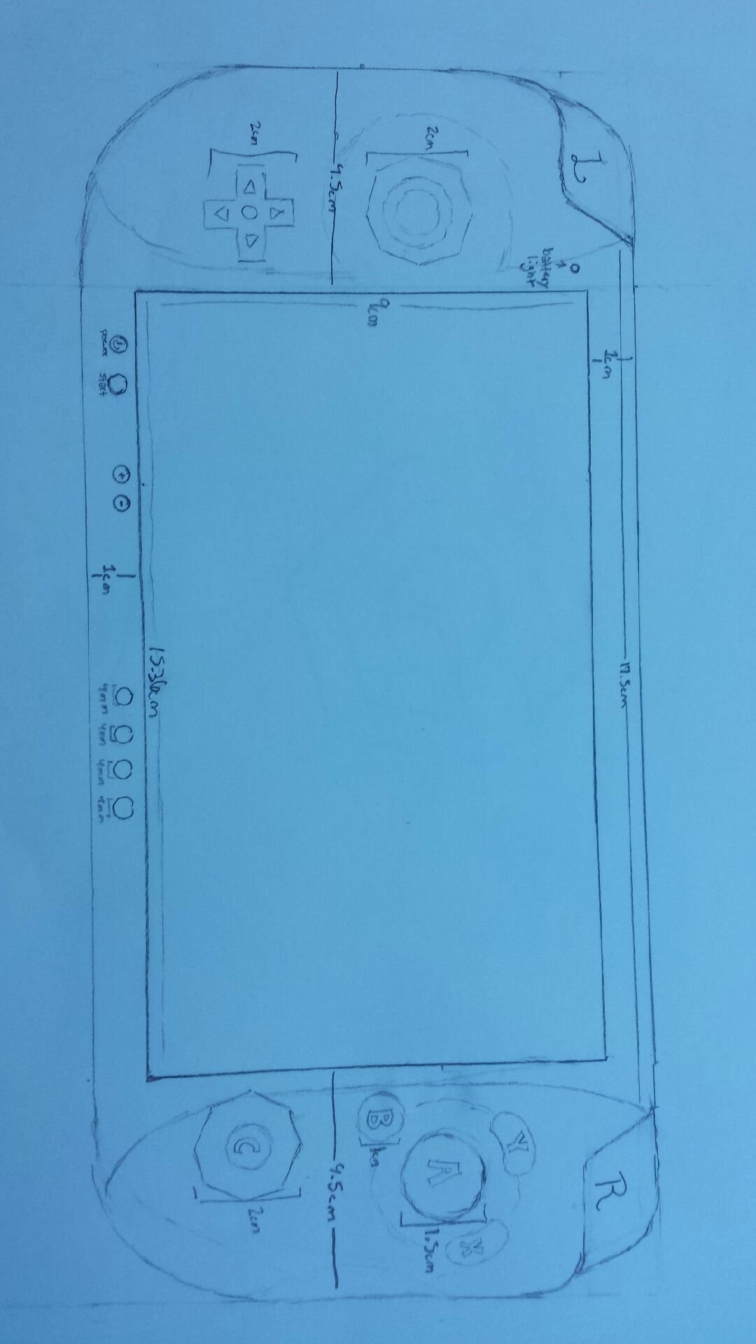

Sketch of front of the GCP and back, subject to change
Corners will not remain like that, hopefully will be flush to the top.
Any critisim is welcome :)
How does one wire controller one to the mobo while keeping controller 2 port available for the gamecube portable?

Case to be done soon

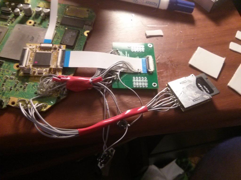

Cut and sanded mobo, turned out pretty good imo being the first time I use a dremel.
Wired SD Gecko, genesis emu works but n64 wont find roms ... (They are in the proper folder)
Removed vga, composite and power from screen board as they were too bulky.
UPDATE 2/21/14
Re-Wired SD Gecko with an adapter this time, looks much better and its clicky :D

Wired up 251 block memory card to the gamecube!
Casing is almost complete :D

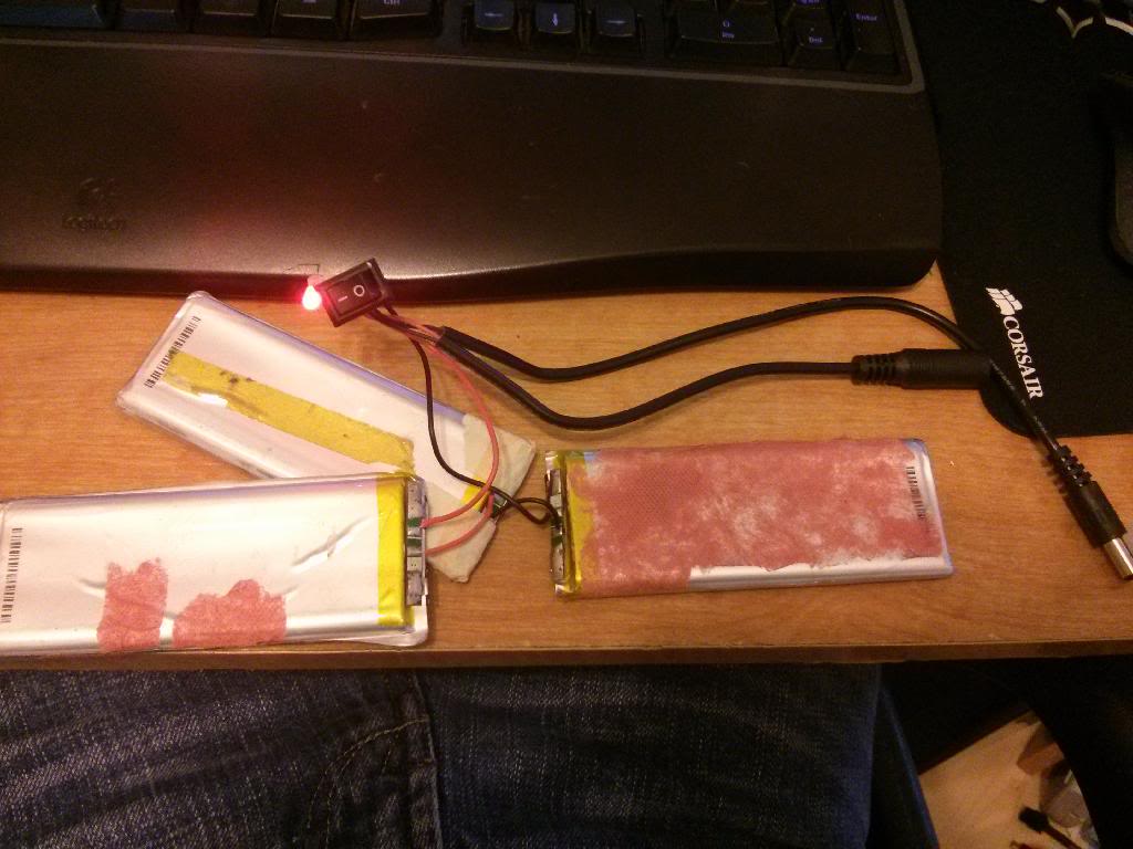

Good news: got the battery pack in
Bad news: No idea what the capacity is.
Here is a picture of the pack disassembled, it was huge at first and there was some Styrofoam in the pack so the lipo packs wouldnt move around or to give off the idea of a bigger/heavy pack.
I have no clue how battery wiring work, I know there is series and parallel thats about it. There doesnt seem to be some sort of smart charger attached either? If anyone could help me out that be great. No markings or anything on the packs either.

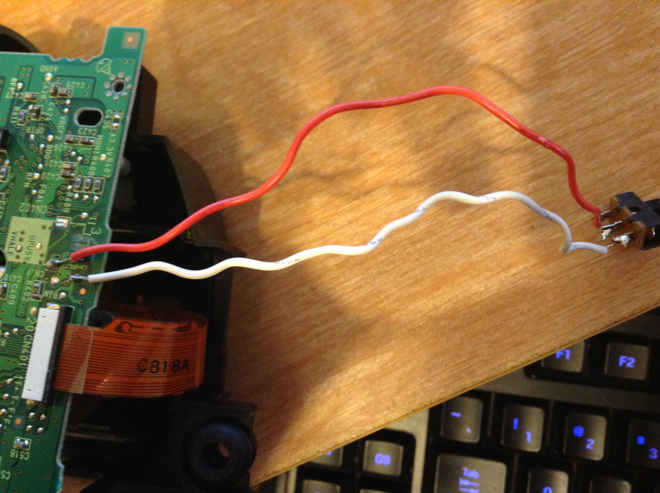

kinect360 wrote:As for the DD drive issues, even if the trace was screwed, wouldn't pin 23 on mobo still work?
pin 23 or pin 12?
dont get confused if you are looking at GC or Wii pinout..
the mainboard lid sense gets its signal from the disc drive lid switch...which is plugged into the connector where you have the pulled traces...
since you no longer have a usable connector, you can cut the blue lid switch cables and strip them a bit to solder to those two points like you showed in the pic...
then hold the switch closed....that should work...
another thing to consider is you might have a faulty switch or its not broken for some other unknown reason....so...if you put a disc in the drive, then jumper those two solder points together the lid will be permanently closed. connect the drive back onto the mainboard and power on the GC. it should spin the motor and try to read the disc..
if anything you can determine if everything is still functional using that quick dirty workaround...

I hooked it up originally to the blue cable board, it was working great like that so I decide to just attach it the daughter board instead with a longer wire. So the switch is functional, which pin is it, 23 or 12? I tried pin 23 under the mobo and had no luck there and also followed the trace and no luck there either.
As for the batteries I already have the 12v 9800mah on the way here, I would like to use those. Should I run the entire unit off 12v or 5v for efficiency? GC is able to go off 5v and so is the screen but they are both capable of taking 12v as well.

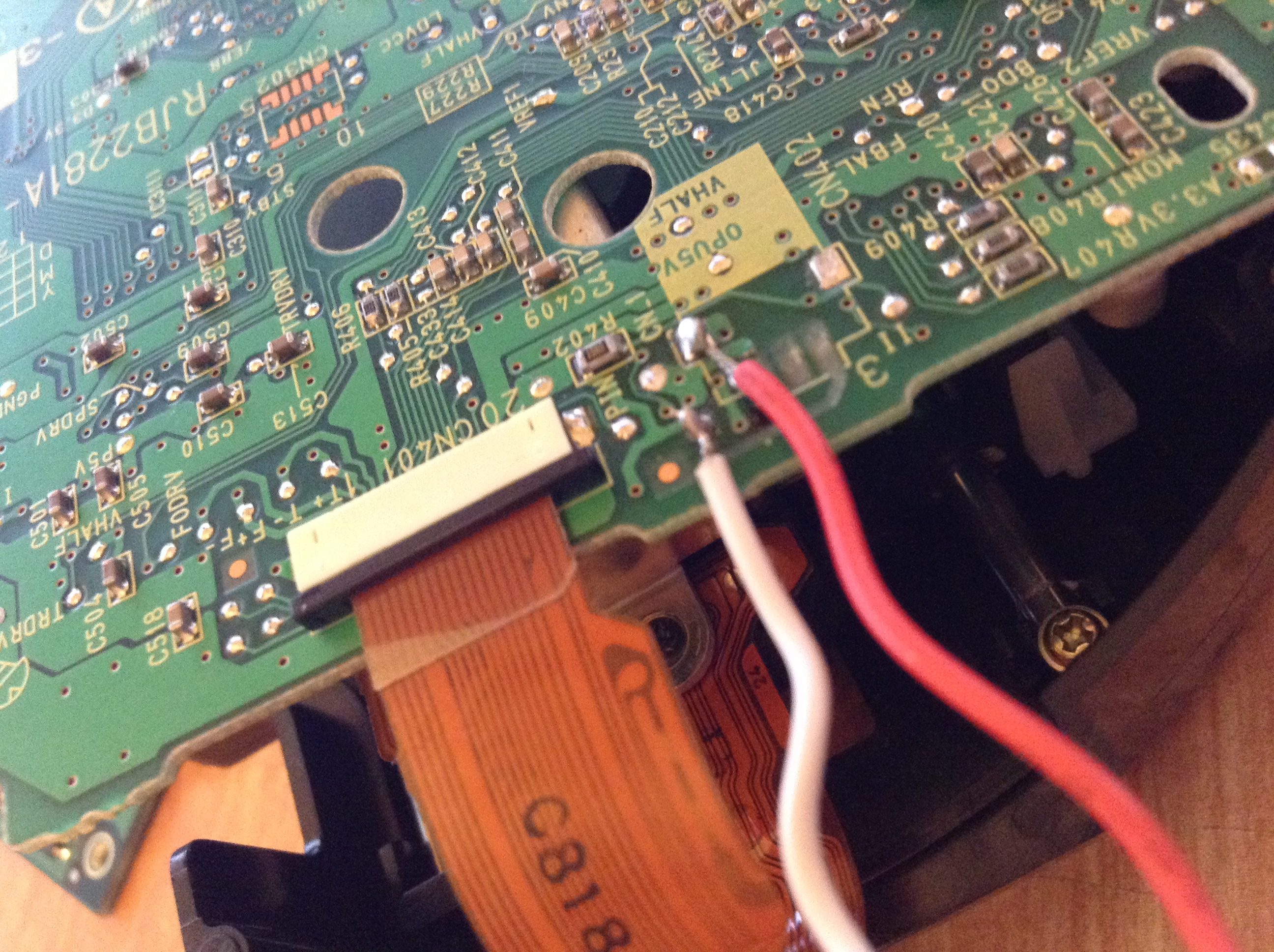

Re: GAMECUBE PORTABLE WORKLOG
Post by kinect360 » Wed Jan 29, 2014 6:38 pm
Attached the switch back to the points where I previously tried and no luck again. Pics attached of what it looks like. Also checked continuity and all seemed well.
Note:
Red wire is ground, no more black wires left atm.
(1.55 MiB) Not downloaded yet
Should I try directly at the R402 point? Continuity between that and the point I soldered too.
(1.92 MiB) Not downloaded yet
Post by megalomaniac » Wed Jan 29, 2014 7:34 pm
Red wire is soldered to the wrong point
I'm not at a computer right now so I can't post a photo of the correct location...
