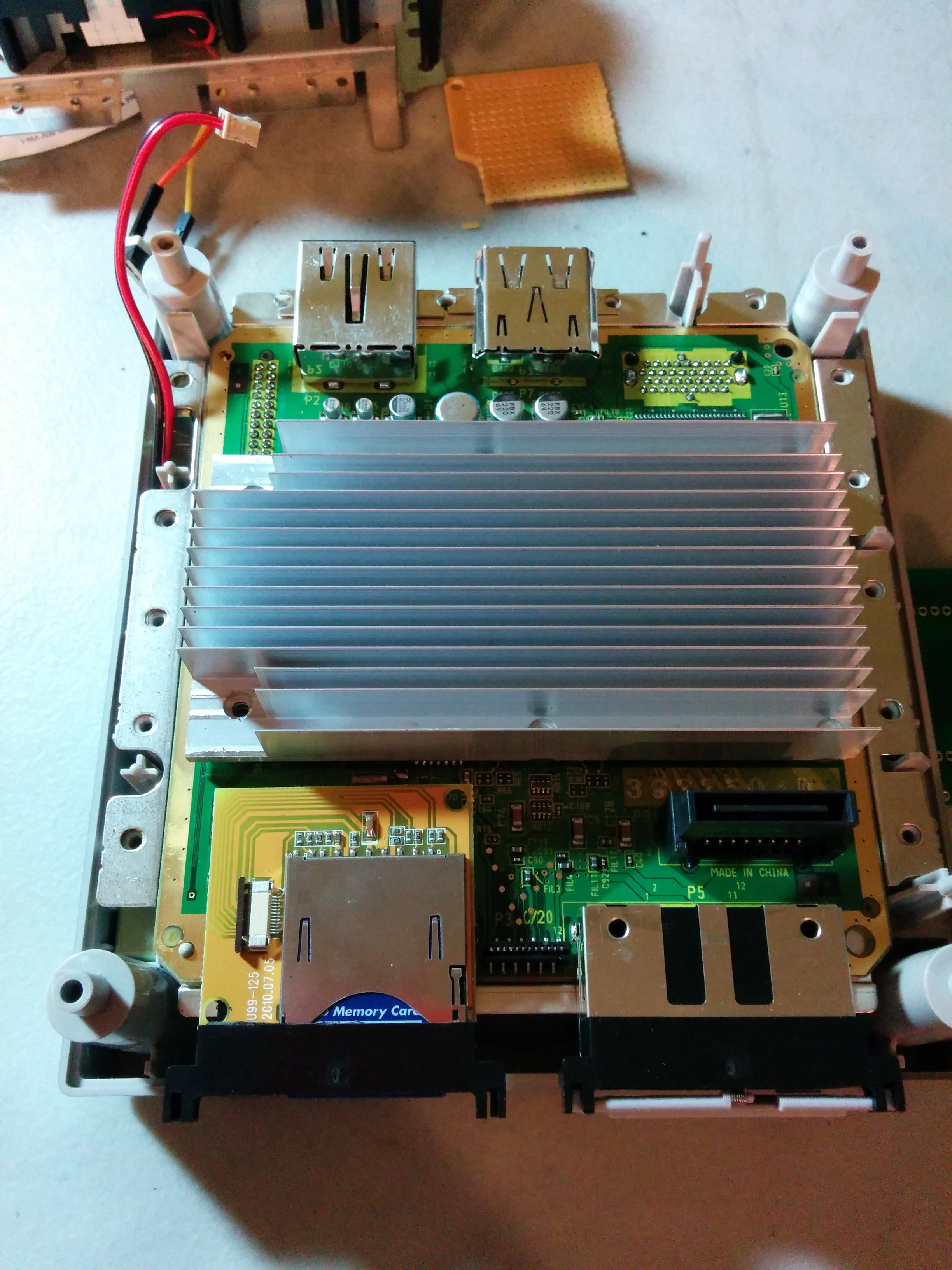

Got my mega drive v4 in AWESOME! Time to mount it up.

Re: mega drive v4 install.
Post by emu_kidid » Fri Jul 04, 2014 4:26 am
nice! but what about all those games that require slot 1 for saving?
Post by marcus9199 » Fri Jul 04, 2014 4:31 am
I have one soldered under the board.

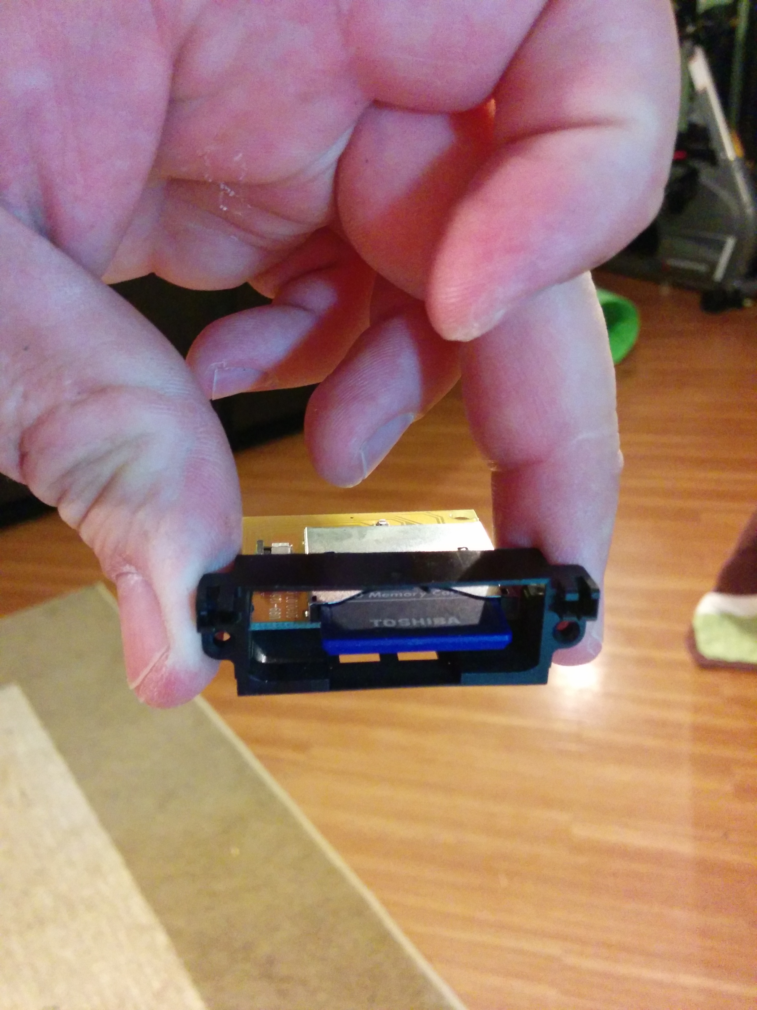

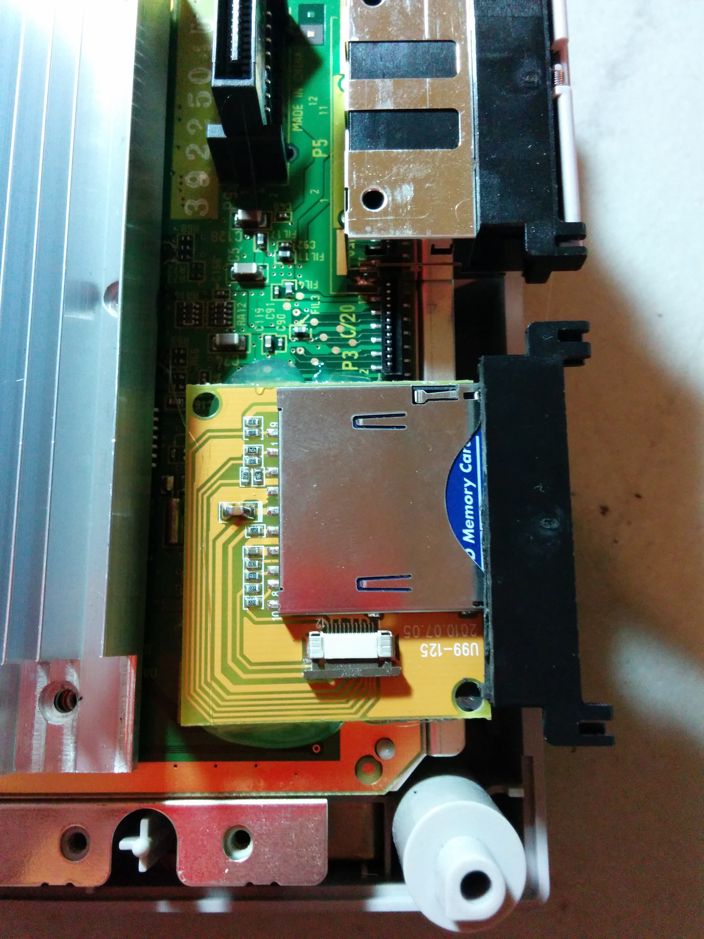

Post by marcus9199 » Fri Jul 04, 2014 4:34 am
Lots of hot glue

And a little closer

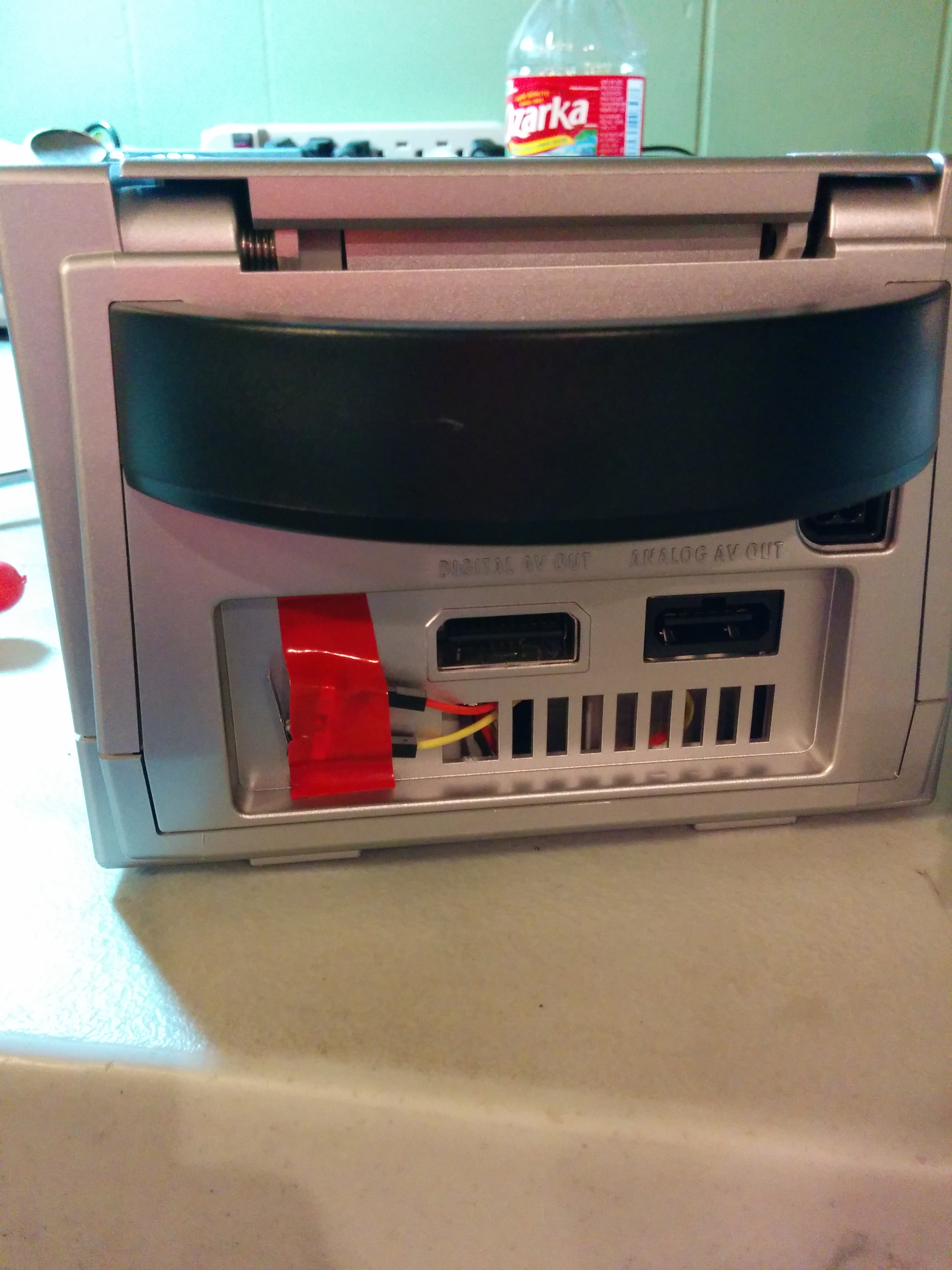

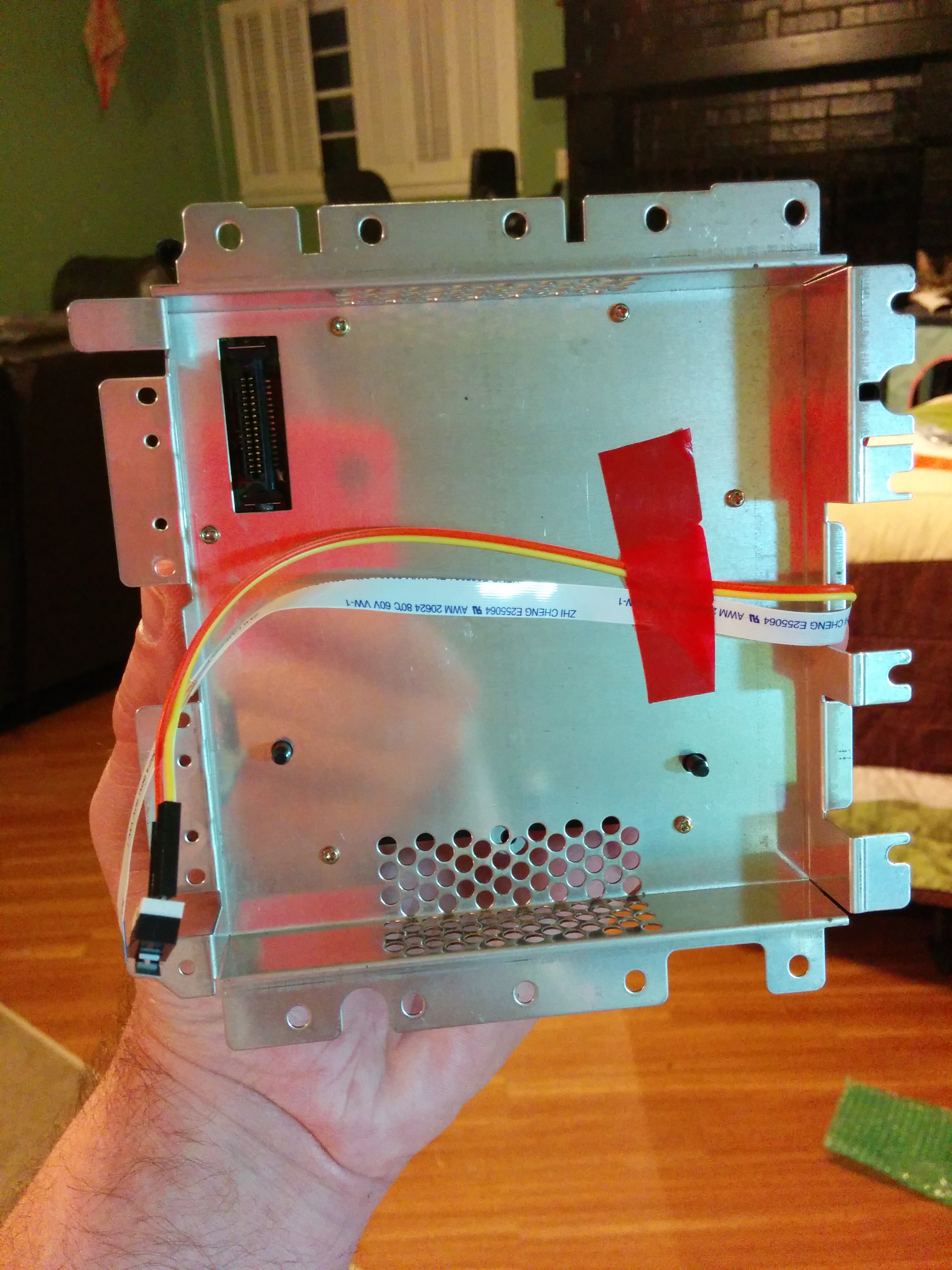

Post by marcus9199 » Fri Jul 04, 2014 5:06 am
Have to find a place for the switch but there's time for that later.

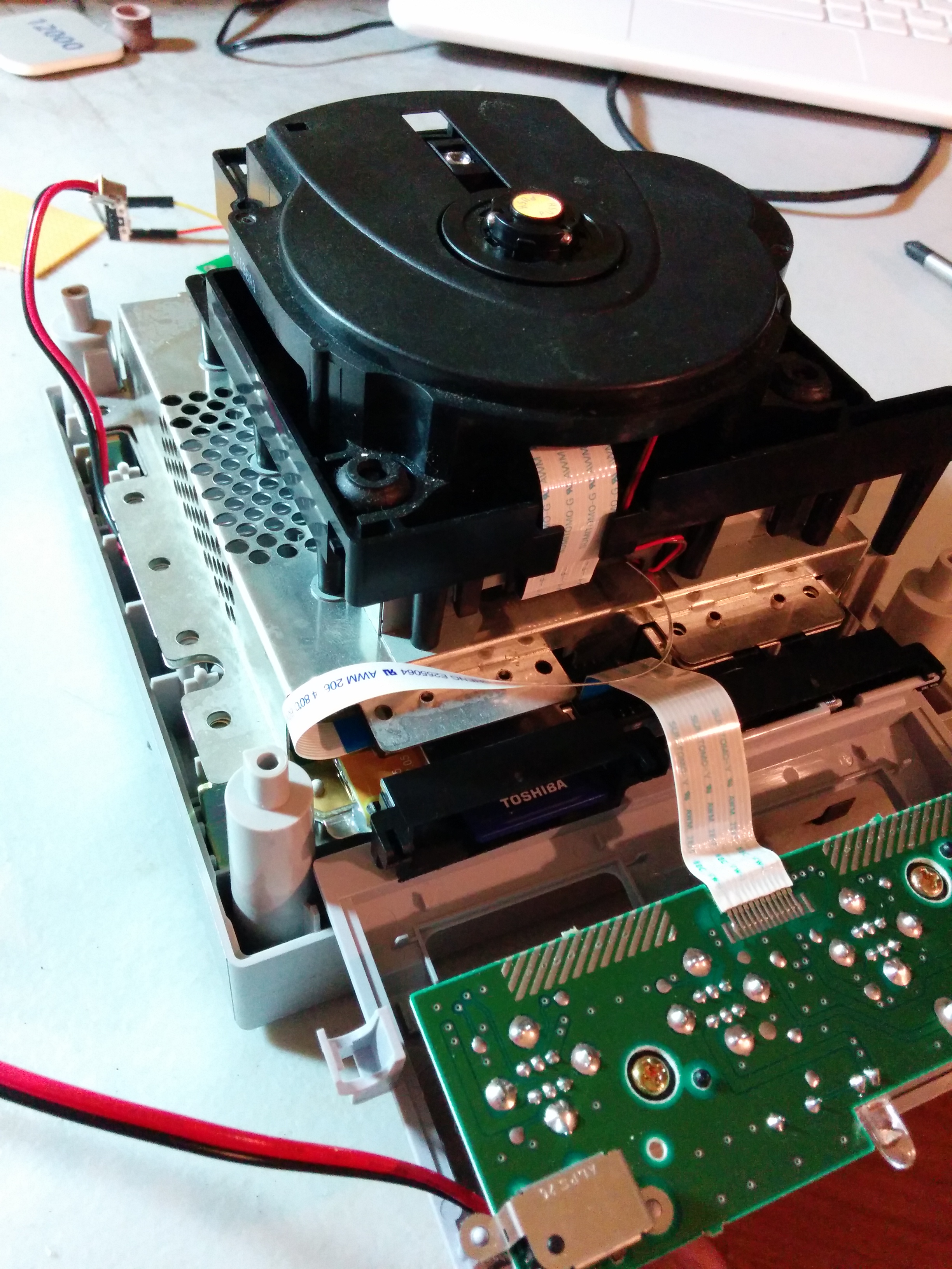

Post by marcus9199 » Fri Jul 04, 2014 5:15 am
Holy crap that was so much easier than the month I spent making wasp work with an FFC adapter.

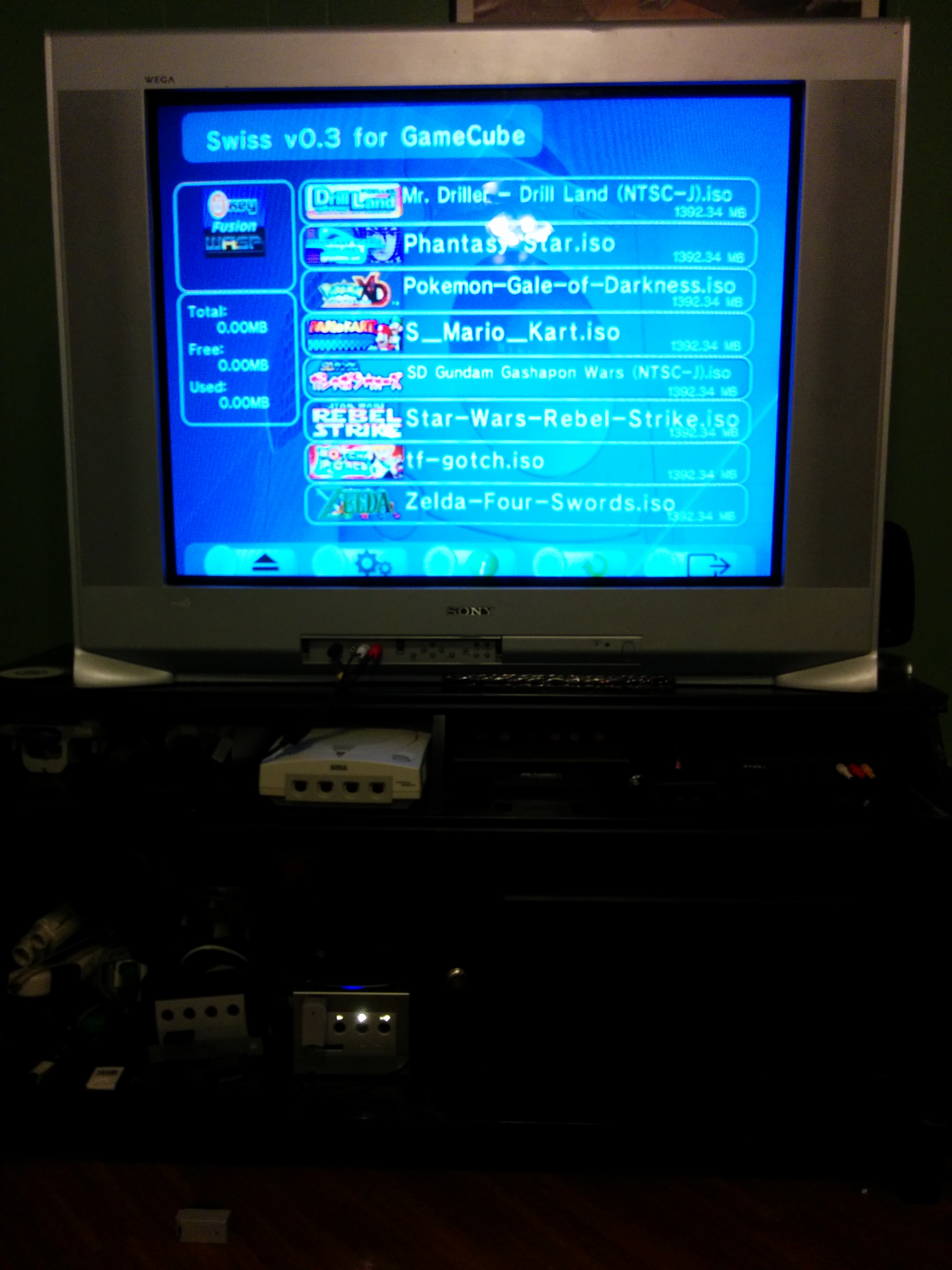

Post by emu_kidid » Fri Jul 04, 2014 5:40 am

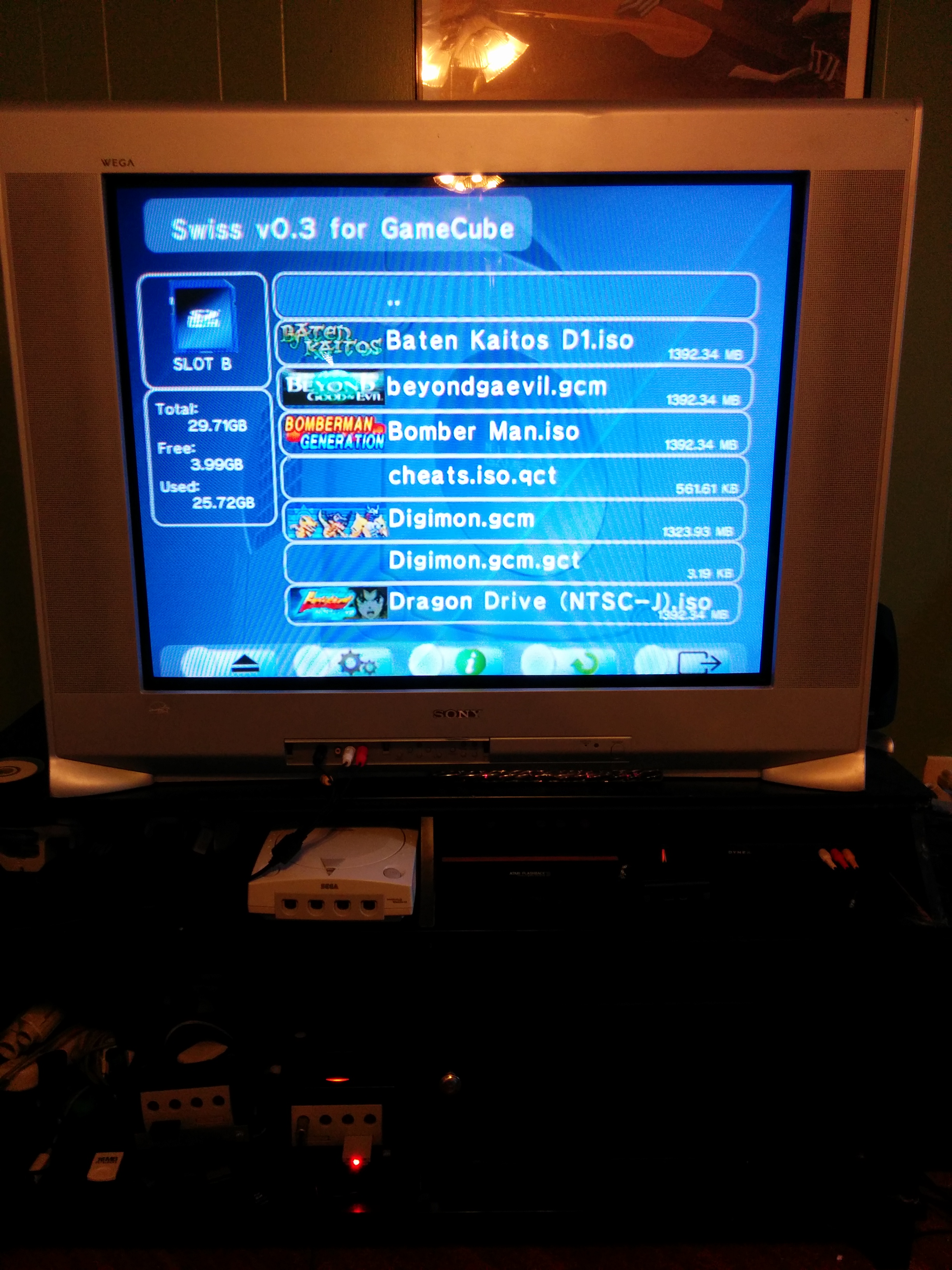

Are you using a >64GB SDXC and that's why Swiss isn't filling out the space on the left or is it an older build where I wasn't populating it?
marcus9199
Posts: 141
Location: Texas
Post by marcus9199 » Fri Jul 04, 2014 5:59 am
Hhhm. I didn't even notice that. It is R260, 32 gig sandisk sdhc.
My wife took my Beer Away!!!!

Post by marcus9199 » Fri Jul 04, 2014 6:33 am

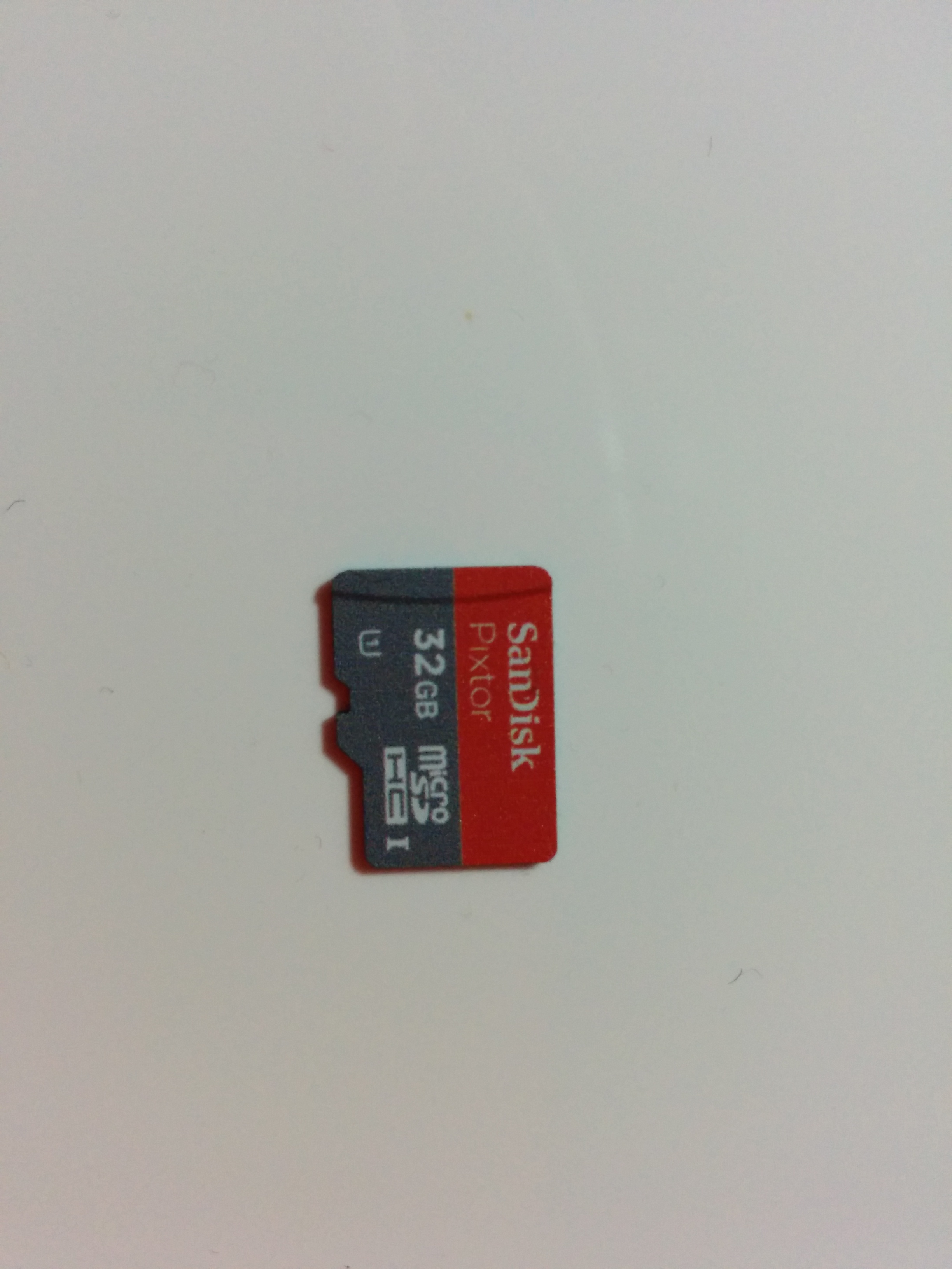

Okay I updated to R264 and still no capacity info. Attached is the card I'm using.
(1.22 MiB) Not downloaded yet
Post by megalomaniac » Fri Jul 04, 2014 5:37 pm
can you put your SD card into slot B and read the capacity successfully??
weird why its not showing up in WKF/WASP menu..
i never noticed how perfect the WASP SD slot fits within the space of the memorycard port

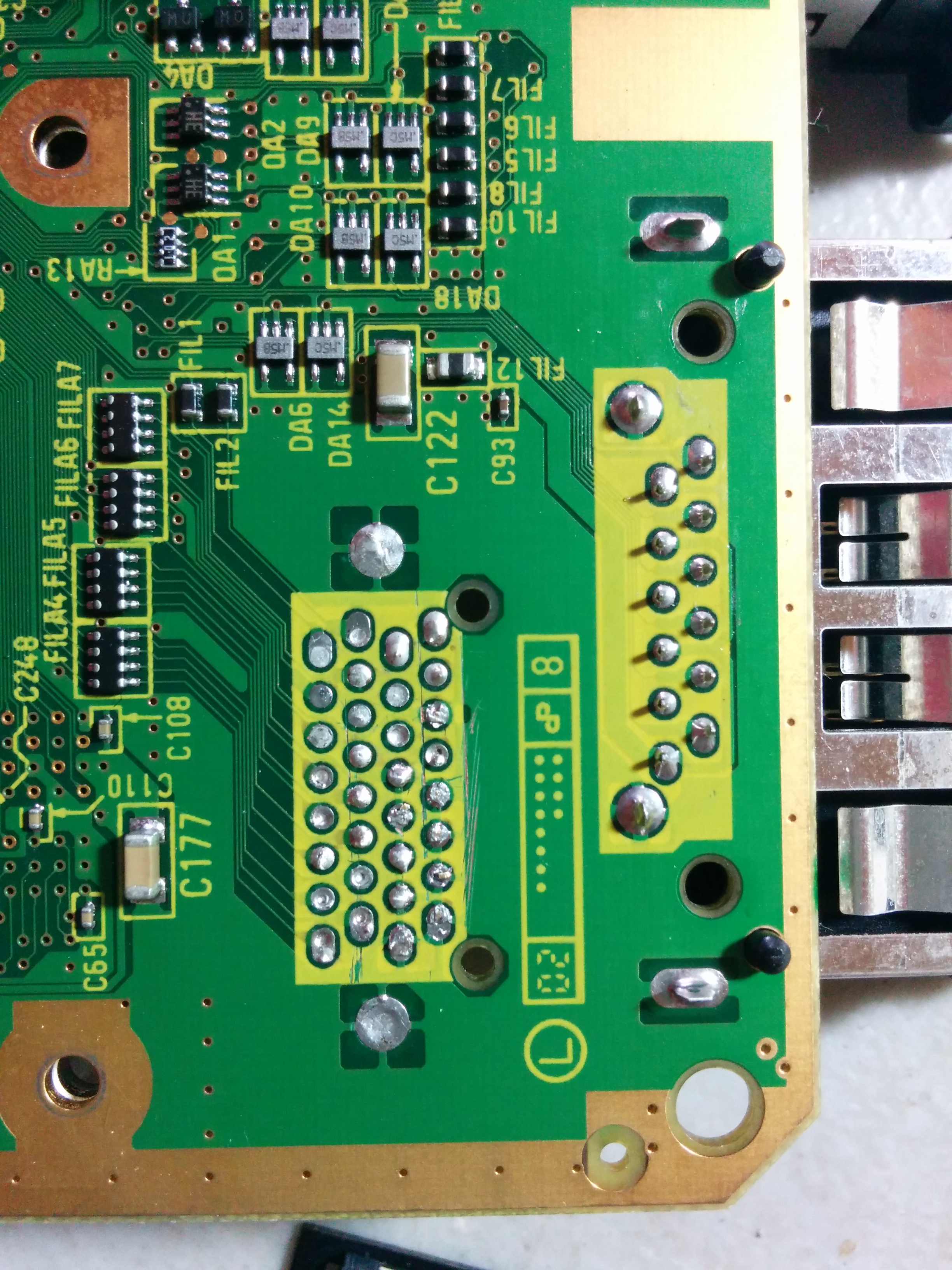

marcus9199
Post by marcus9199 » Fri Jul 04, 2014 6:02 pm

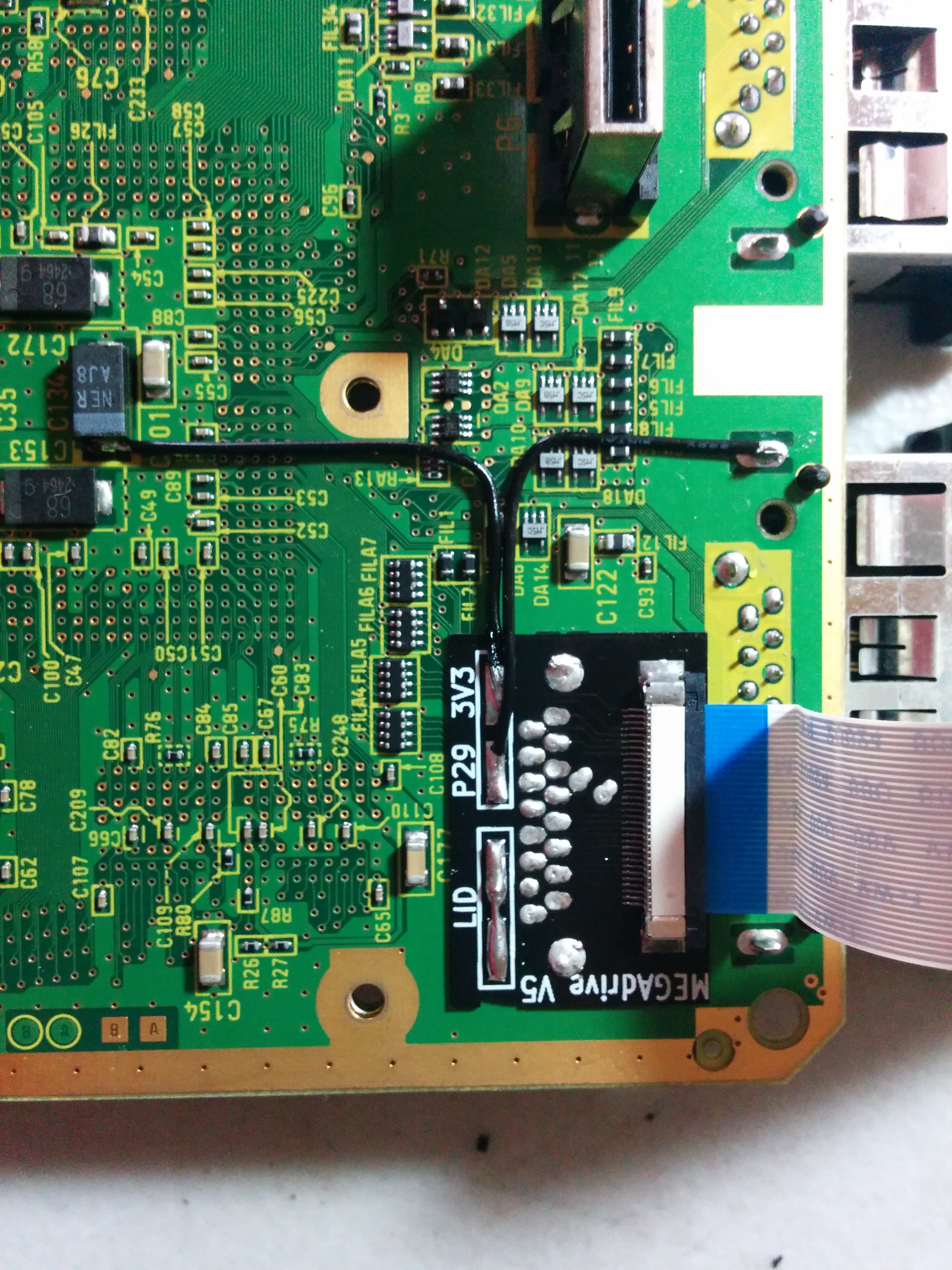

Figured a little bit of pre tinning couldn't hurt.

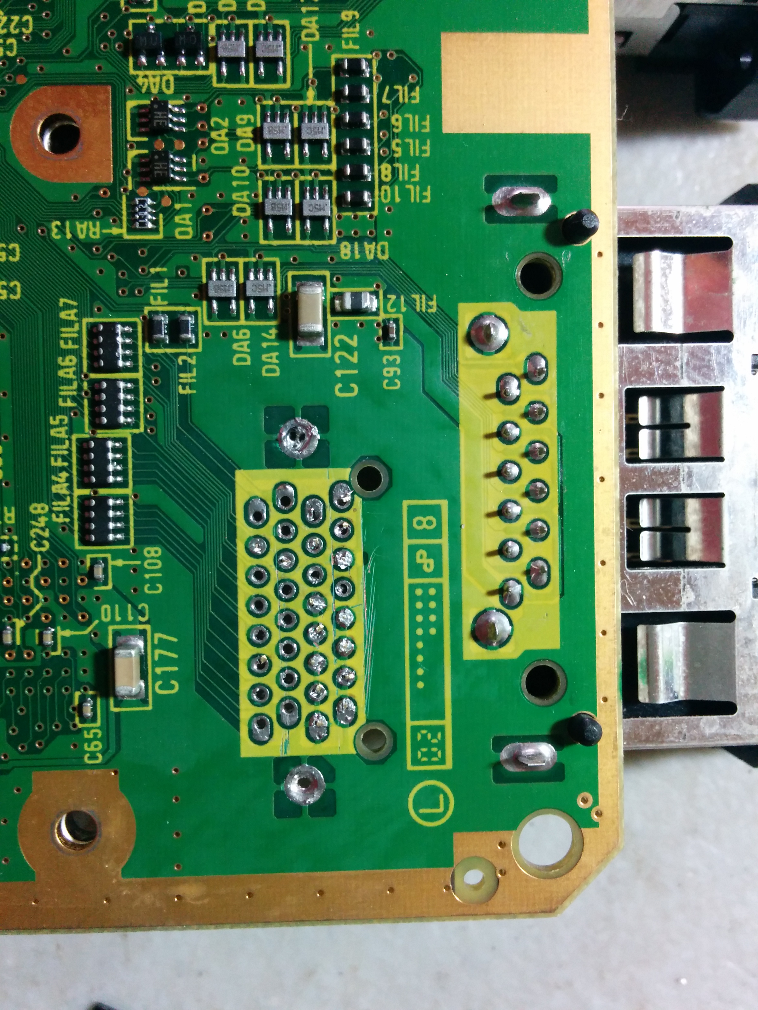

marcus9199
Posts: 141
Location: Texas
Post by marcus9199 » Fri Jul 04, 2014 7:45 pm
Woo hoo!
