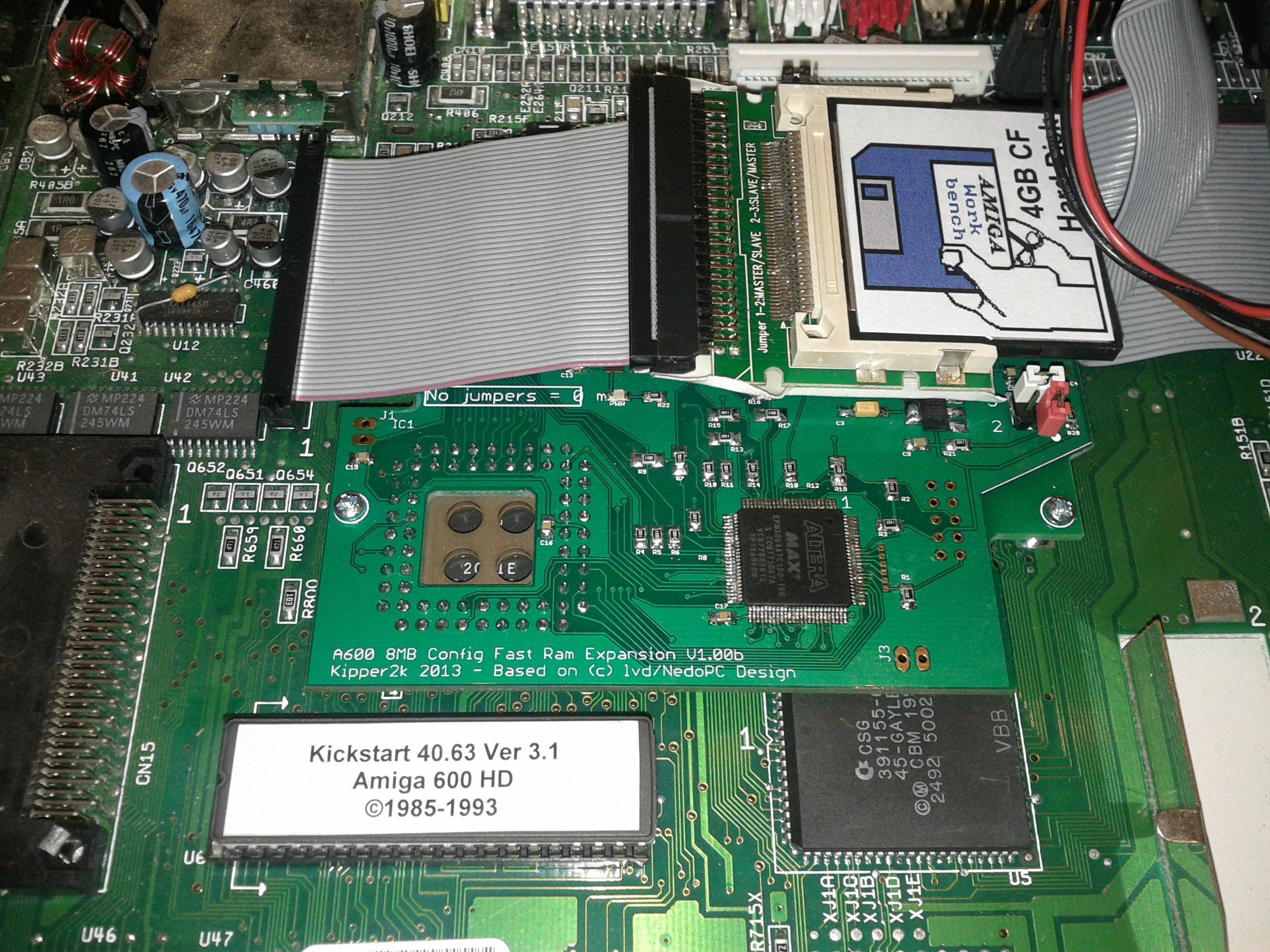

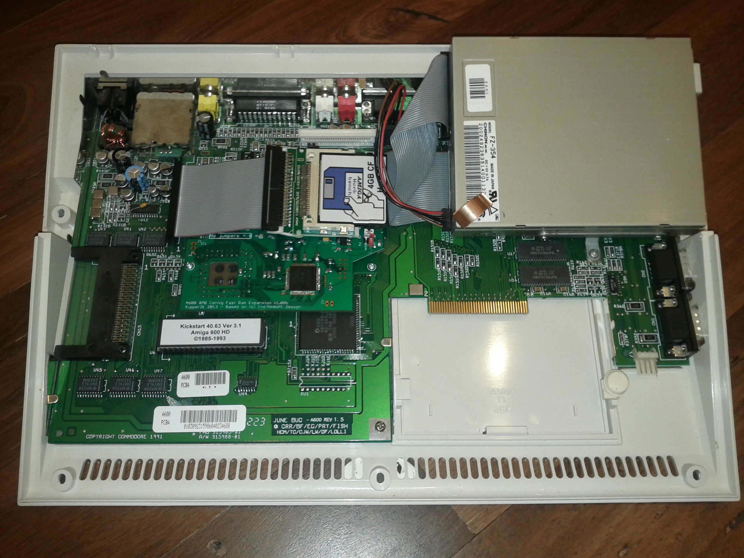

Finally got around to upgrading my Amiga 600 HD which had a dead/corrupted 40MB HDD in it.
I've added 8MB (fast) RAM, 4GB CF card to replace the HDD and upgraded the Kickstart to v3.1, here's two pictures. I really like the way the RAM addon clips on top of the 68000 and has screws in the same spots where the HDD sat to hold it down in position so it wouldn't move even if I dropped the thing hopefully.
