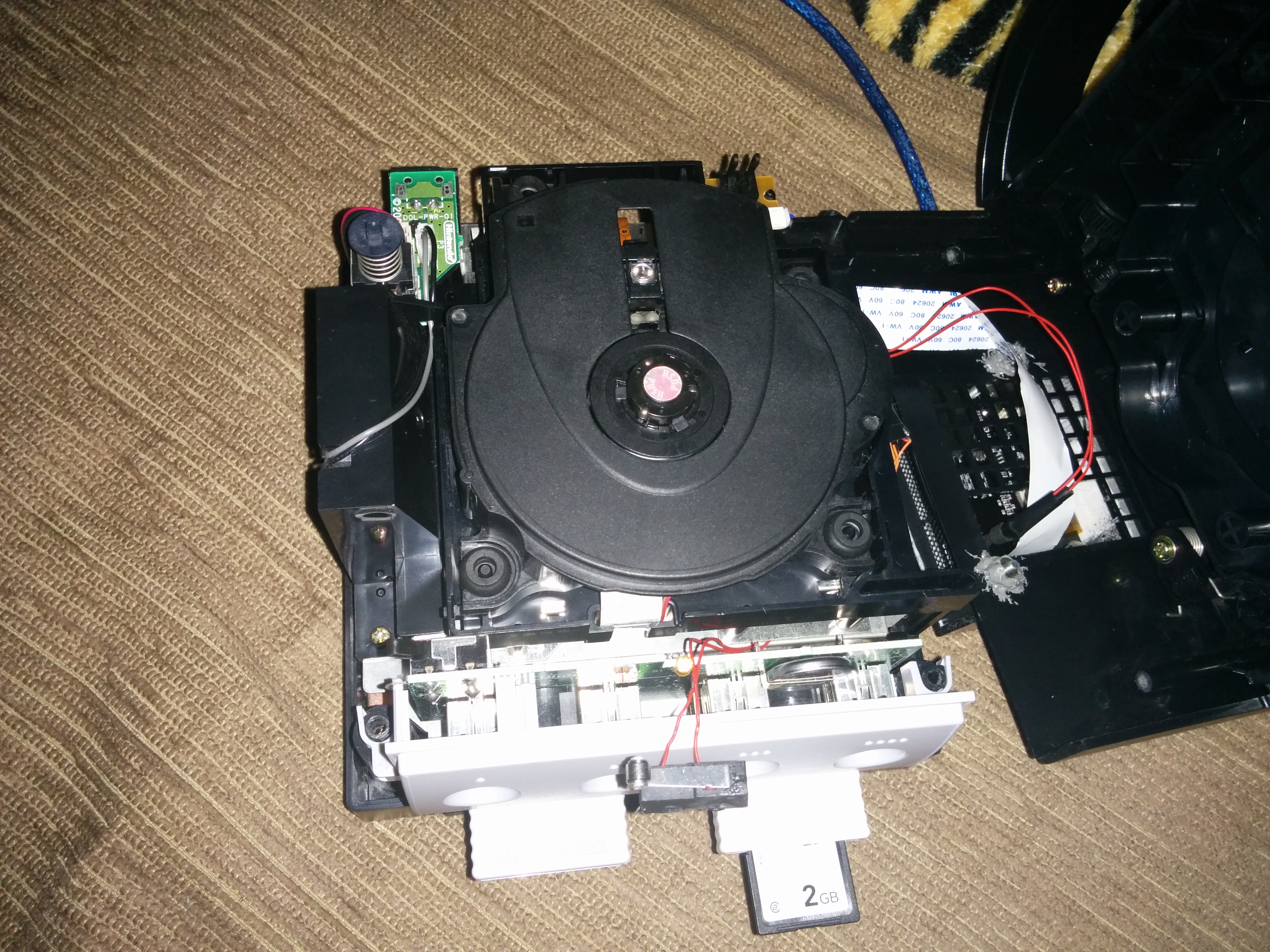

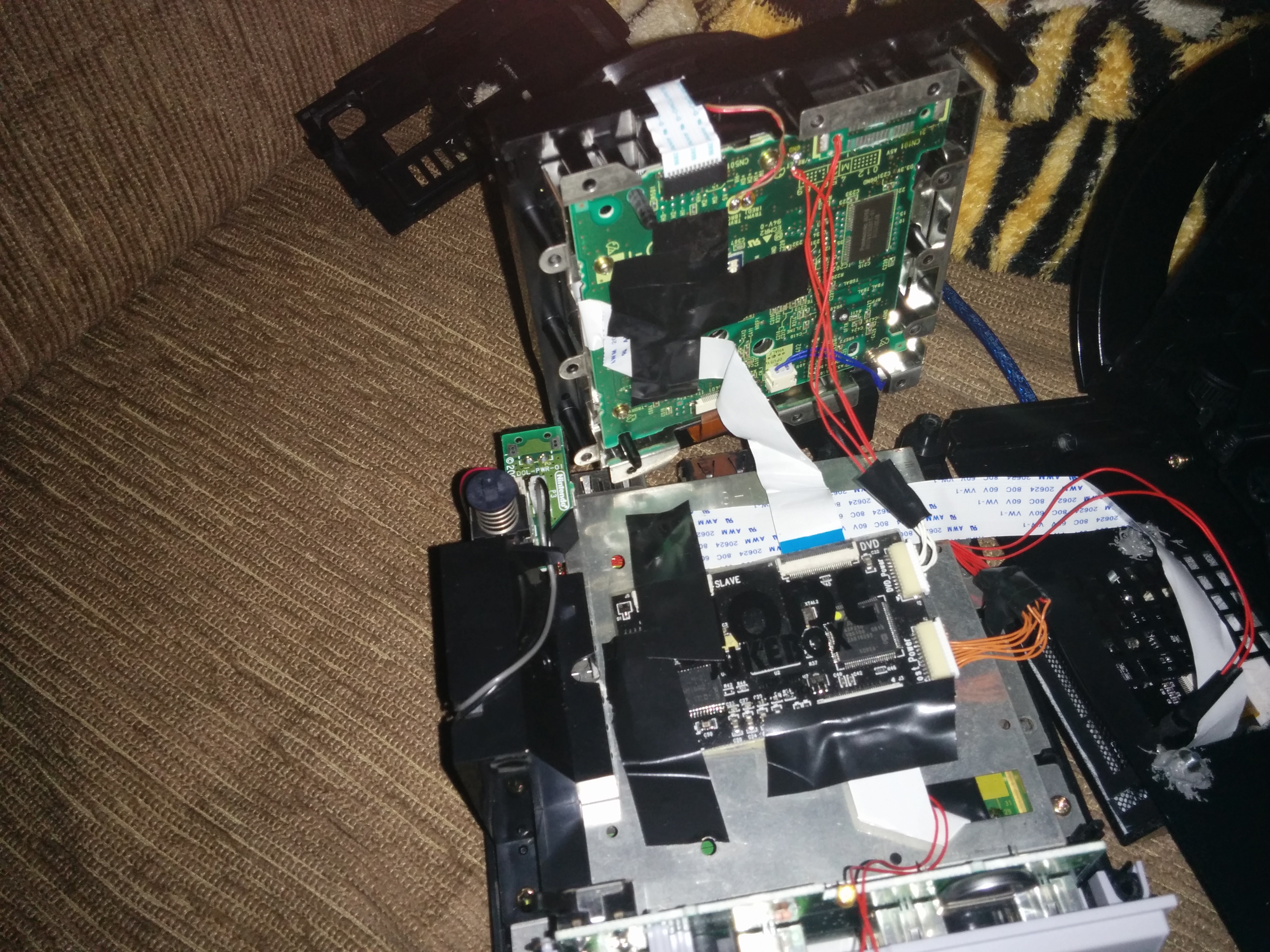

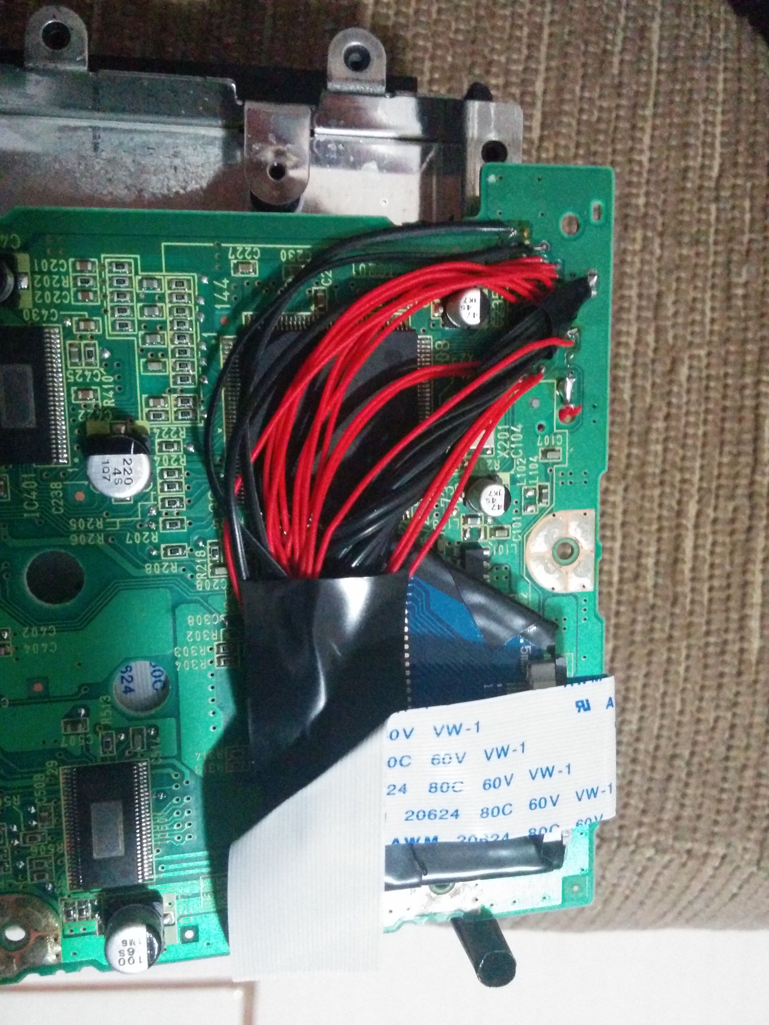

Here is my setup.
I can play games without audio streaming from a DVD flawlessly, but I can't play games with audio streaming.

Re: MegaDrive v5 + WODE
its got to be a wode setting or firmware or something within the wode blocking the signal...
try not to make a mess of these instructions below:
remember GC has pins 1,3,5 which are different from Wii / Wode pins 1,3,5
you are basically bypassing wode audiostreaming and reconnecting the DVD drive pins directly back to the GC mainboard...
dont worry about wire length...about 15cm is fine to use for this test
from the Mainboard to MEGAdrive, desolder your wires for pins 1,3,5
then from the DVD drive, solder pins 1,3,5 directly to the Mainboardremember GC has pins 1,3,5 which are different from Wii / Wode pins 1,3,5
