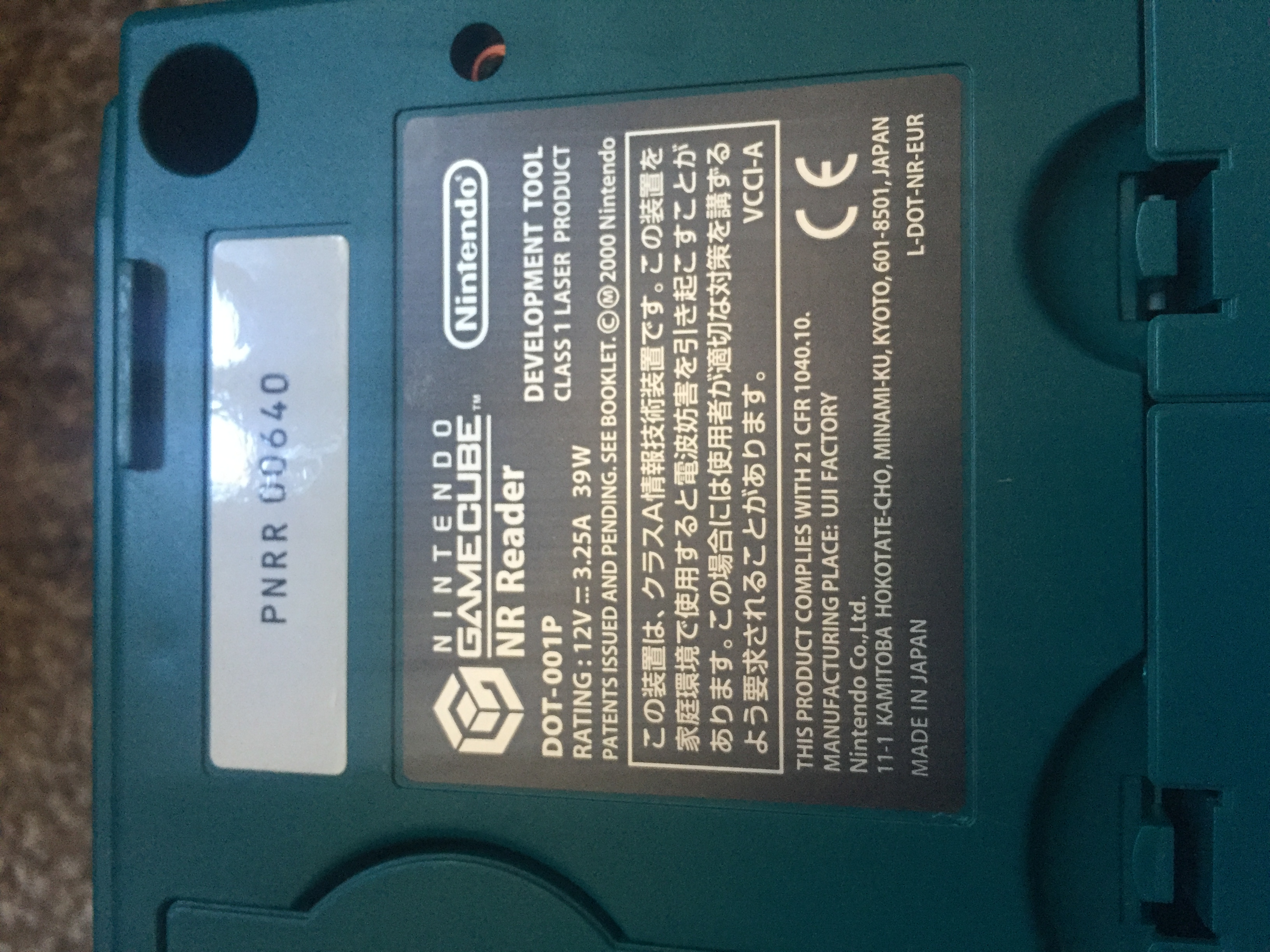

Gamecube dev stuff is neat. If you have a chance to pick it up for a decent price, you should do it!
I’ll attach some pics of my nr reader for you or anyone else. I spent about $400 for mine with the box
- (2.35 MiB) Not downloaded yet
