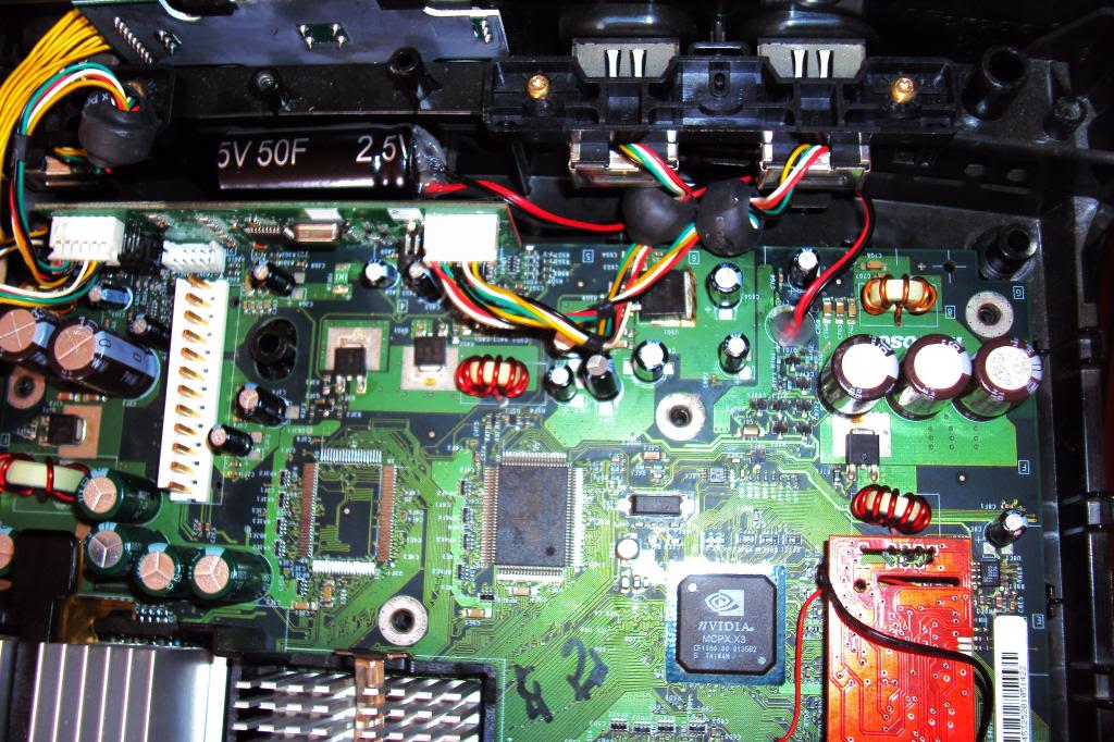

My original Xbox (first model), same age of the Gamecube, is known for having bad clock capacitors.
(the xbox used a capacitor instead of a battery to keep the clock)
The 2.5V 1 Farad capacitor leaks, destroying everything it touches in the motherboard. It can even cause short circuits and fires!
I replaced the ridiculous 1Farad capacitor (wich could keep the clock for about 3-4 hours max) for a monstruous 50Farad super capacitor. hahah
The clock lasts for over a week with the console unplugged now. I also placed it away from the motherboard, that way, even if it leaks, it won't cause any harm.

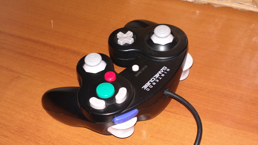

And one more thing to worry about: The controllers!
If you play a lot, you will eventually wear the analog sticks (had to replace them in my nintendo 64), and also the analog caps. (had to replace them in my gamecube)
For my gameboy advance, snes, dreamcast, PS2 and Xbox, I've also had problems with the contact rubber pads inside the controllers.
They simply get rigid and crack after some years and under heavy use.
Luckily, China is also providing replacements for those, at least for the most known consoles.
