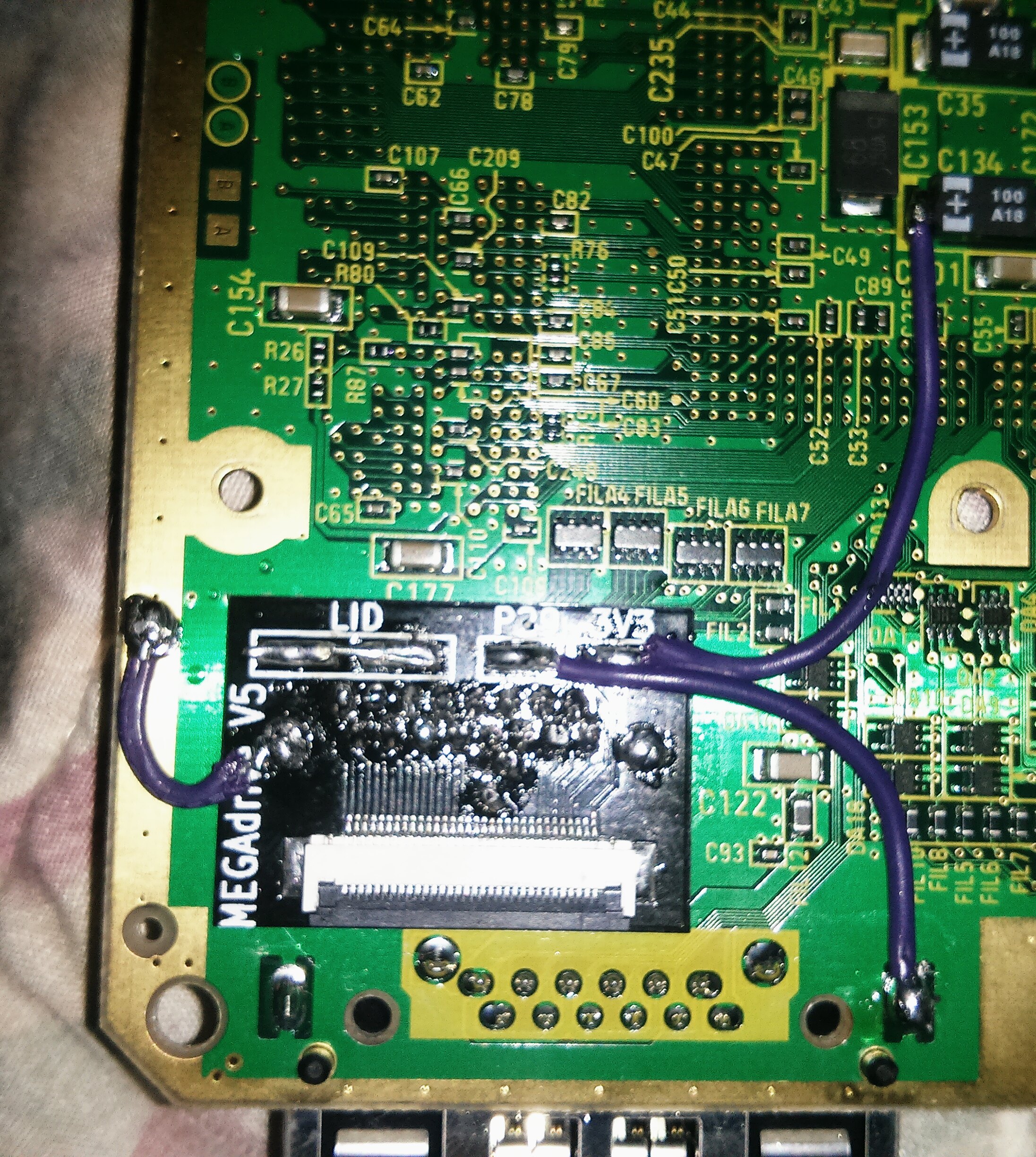

So I bought a WASP thinking i could install but sadly i was mistaken. I want to replace the dvd on my Gamecube and put this in to eliminate using discs. I am completely lost on what i need and i was wondering if anyone has a tutorial. I would like to make this procedure as easy as possible, so any attachments that save me soldering would be a plus. I have spent hours trying to find a clear guide.

Get a megadrive v3 from badassconsoles.com, it's the easiest way.

I'm having the same issue. I bought a Wasp Key for use in my GameCube and received it today. I've been looking at install guides and thought it was solderless but I keep reading about soldering pin 29 or power or ground. The YouTube videos I see make it look like you just have to plug it in. I also looked at the Megadrive by couldn't find one to purchase so I went with the Wasp. Going to pop open my GameCube tonight and look at it closer. I don't have a problem with soldering it's just that I'm not that great at it and have done a couple of other mods recently and wanted something a little easier for this.

If your not going to use a megadrive your going to have a hard time installing it into the cube. You have a few other options you could solder wires right to the FFC cable which in my opinion is insanely hard with 0.5mm pitch or you could completely remove the FFC connector from the wasp and solder to the pads where the connector was sitting I find this a little easier but if you mess up you destroy the wasp. Then there are generic adapters 36 pin that are the easiest way besides megadrive and would probably hold up better then the options above but the cheapest megadrive is the V5 and at 15usd you might as well go with that since the generic adapters are 10usd. If you were looking for plug and play connection out of the box Im sorry but the wasp/wiikey was designed for wii not gamecube so soldering must be done. I added a photo of my first V5 install to give you an idea of what needs to be donebyonddrivn wrote:I'm having the same issue. I bought a Wasp Key for use in my GameCube and received it today. I've been looking at install guides and thought it was solderless but I keep reading about soldering pin 29 or power or ground. The YouTube videos I see make it look like you just have to plug it in. I also looked at the Megadrive by couldn't find one to purchase so I went with the Wasp. Going to pop open my GameCube tonight and look at it closer. I don't have a problem with soldering it's just that I'm not that great at it and have done a couple of other mods recently and wanted something a little easier for this.
Re: Need help to install a WASP (WiiKEY Clone) into a gamecube
V3 is more expensive ($50) but plug and play except for a couple of big solder points
Yeah version 3 is more user friendly, but you loose your disc drive without further case modding, but if you already mod stuff that shouldn't be an issue.

To retain the DVD drive on GC the only option is megadrive v4 which is a complete DVD drive with a built-in WASP. V5 doesn't let you use a DVD drive at all since it requires removal of the DVD drive connector. V6 is harder to solder.
