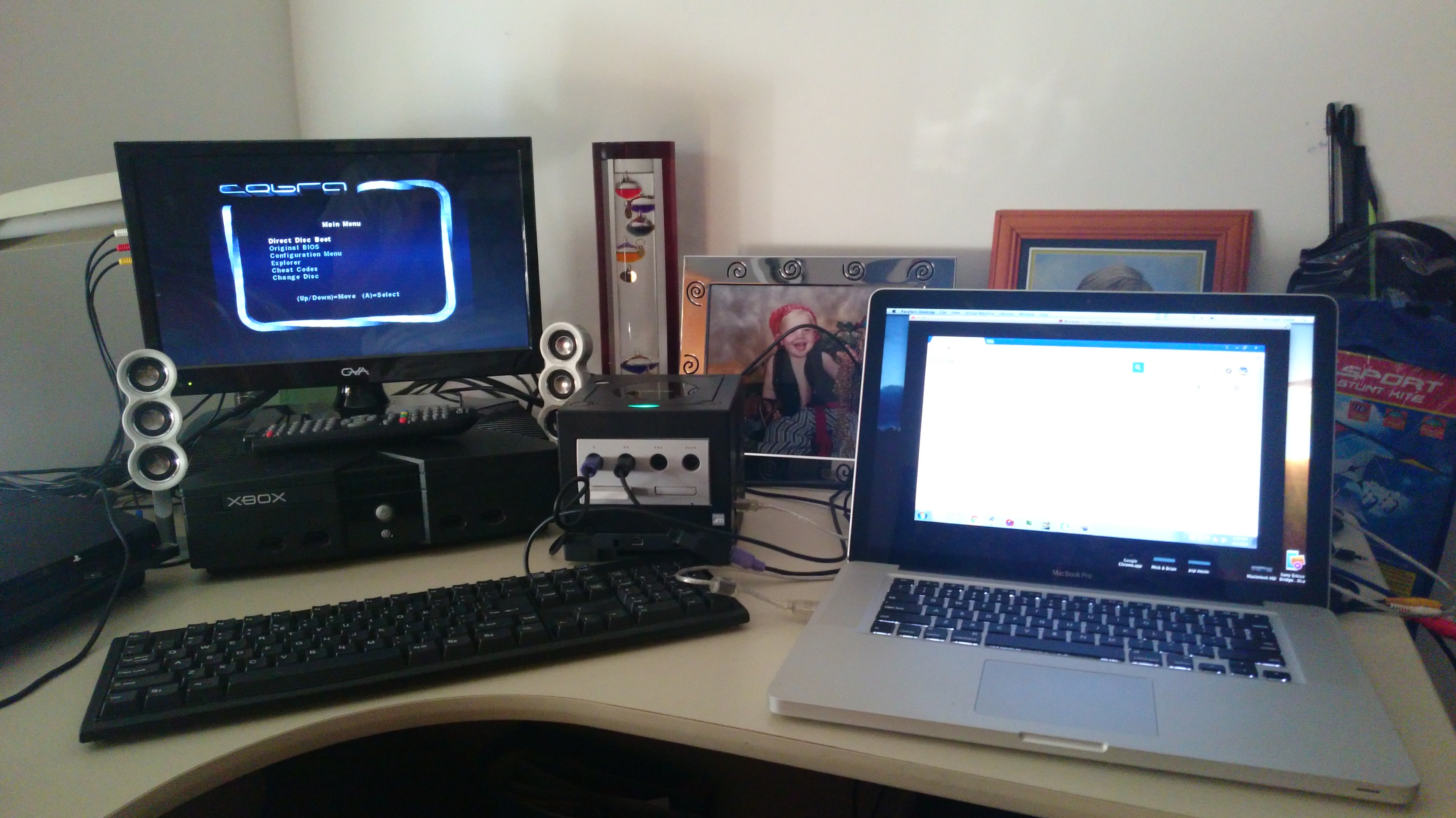

I managed to fix the damn thing by using the original computer from which I flashed from. It's weird how a mac with a vm of windows worked and not my own windows 7 pc haha.
Thanks for all the help emu_Kidd :D
And for anyone reading this post for troubleshooting. If you accidentally bricked you viper or it won't flash, try doing it on the original computer you flashed it on as that worked for me.
And if it came bricked try doing it on an older computer.
