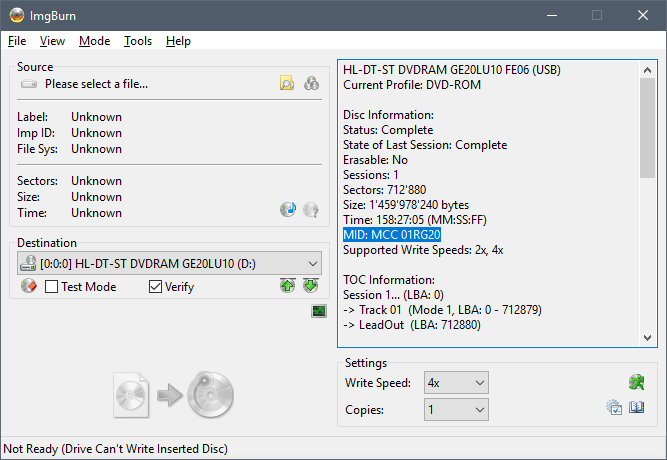

You didn't answer andzlay's question. What media are you using? Pop a disc in your drive and fire up Imgburn. Tell us what the MID is (see the attached screenshot).

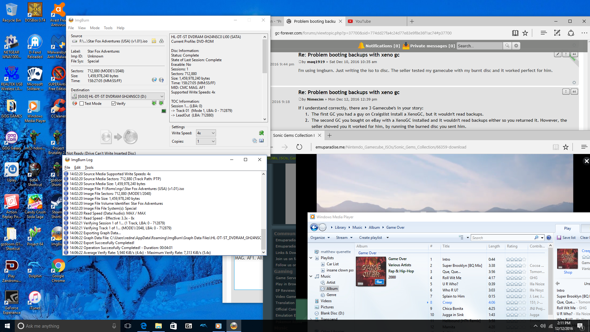

No I don't know for certain but he sent my some copies he burnt. They didn't play either. I'm using phillips mini cd-r with a MID of CMC MAG. AF1. All burnt on 4x. Also attached a screenshot of imgburn.

maq1919 wrote:No I don't know for certain but he sent my some copies he burnt. They didn't play either. I'm using phillips mini cd-r with a MID of CMC MAG. AF1. All burnt on 4x. Also attached a screenshot of imgburn.
You must mean Mini-DVD-R. CMCMAGAF1 should be good, although they're noted to have a wide quality variance. They seem to be popular, and the last person I helped had good success with it. You should inspect the MID of the seller's discs, too.
