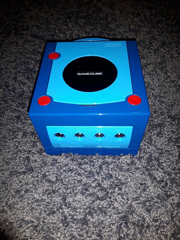

so i have 2 gc one has the region mod switch and the other doesnt. so tried 3 different tv, worked only on one perfectly didnt matter what the region was set at. the other gc still only will boot non backups in color but backups are black and white

Did you try forcing 60hz?

Yes. Does it matter that I'm using a wave bird

Shouldn't. Have you tried to boot up while holding X/Y?

Yes

i think i just had the bad luck of the 1st 2 backups were on the list, i burnt another back up and its fine.
