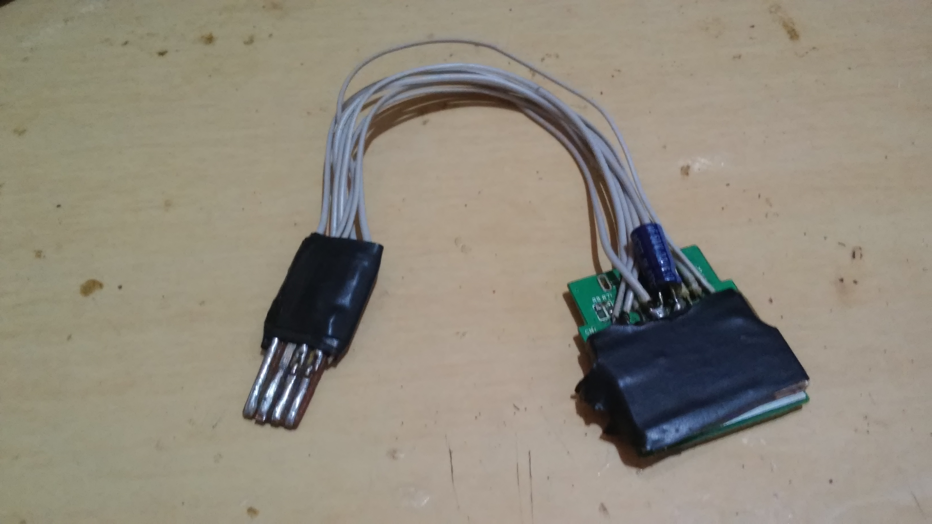

guys I'm done...
I tried different things and the result is the same
I make a New Sd gecko connected to main board in memory card B with this diagram
I tried connecting with SD pin 9 and without it
Spoiler
Show
this is my SD Card adapter is kingstone and mini SD 16gb (I pull out the capacitor)
Spoiler
Show
Diego borella

did not work? I think there is blocking by the data bus ... :!:
:idea:
do not use pin 9 of the SD. :|
follow the diagram. with multimeter ...
weld it to the SD without this wire head.
eliminate the red wires and also the plug.
use less wire. :arrow:

Trying with handmade stuff won't get you anywhere, because it is very error prone.
First, you have to make sure the software side is OK, both what is on your GC Memcard, and what is on your SD card, that it works well together and with the game you're using to boot.
One safe thing to do first is to try run GBI or any homebrew off a GC memcard with your save exploit. (replacing the DoLauncher (Boot.gci))
Diego's right, if your red wires go straight under the adaptor, there are many errors, no need for pin 9 and 8 to be connected, while 7 and 6 may be needed.
But you can keep the connector and red wires, it makes for easier disassembling.
Try to be precise and serious about what you do (ie, your Kingston adapter is a µSD card adapter, why does it matter? only miniSD cards, not regular nor micro ones, use the Int pin) and do not try everything around.
Validate working things step by step, this only way we would be able to help you.

Papy.G wrote: Tue Mar 31, 2020 10:48 amDiego's right, if your red wires go straight under the adaptor, there are many errors, no need for pin 9 and 8 to be connected, while 7 and 6 may be needed.
thanks for help me
I pull out the red wires and pin 9, now when I go to Smash B. vs mode/enter name the image freezes for 10 sec. then it restarts
anyone has the files for this process to download again?
