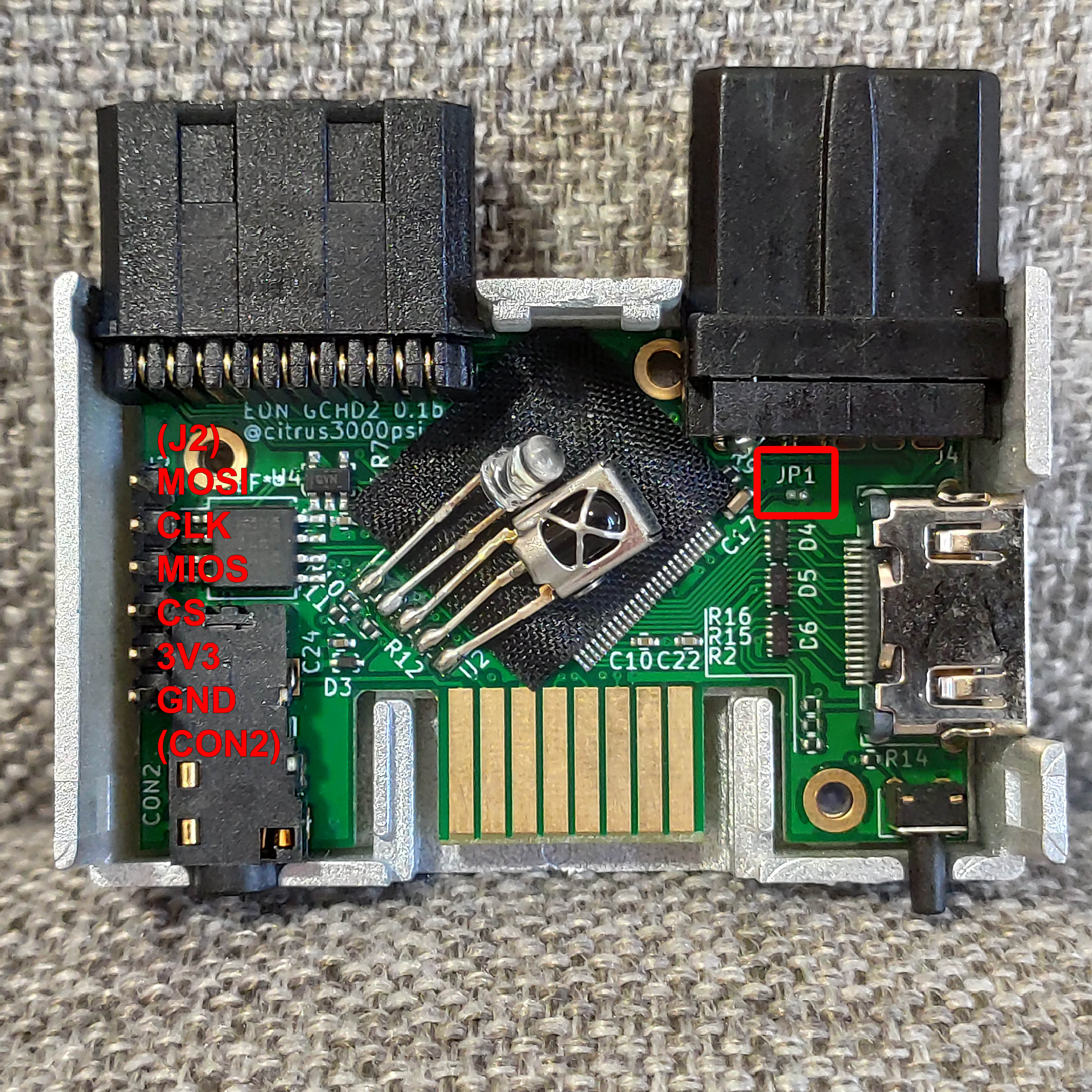

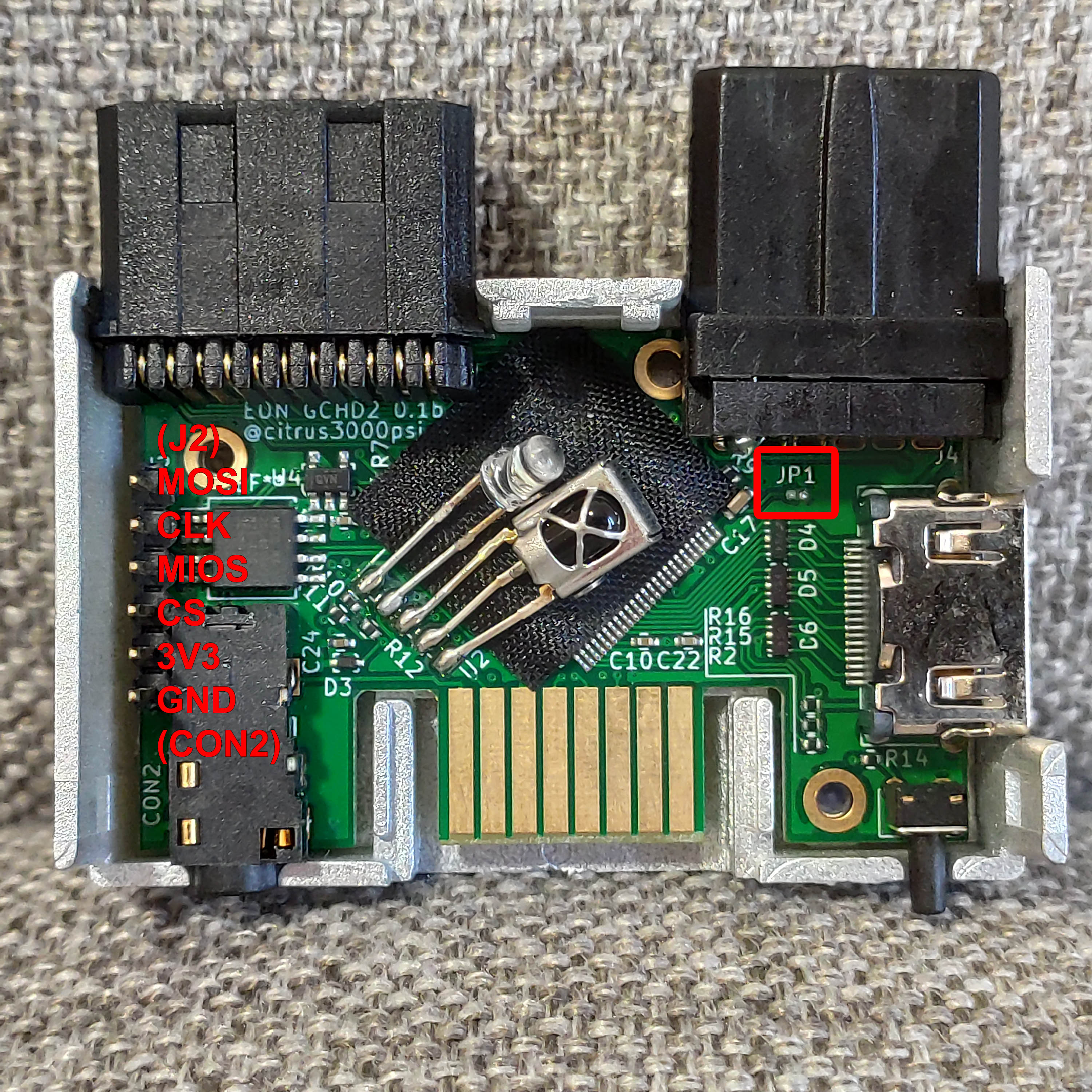

Bridge JP1 to disable.
J2 header is SPI.
In the following order (Parentheses = Silk Screen):
(J2) MOSI CLK MISO CS 3V3 GND (CON2)
J2 header is SPI.

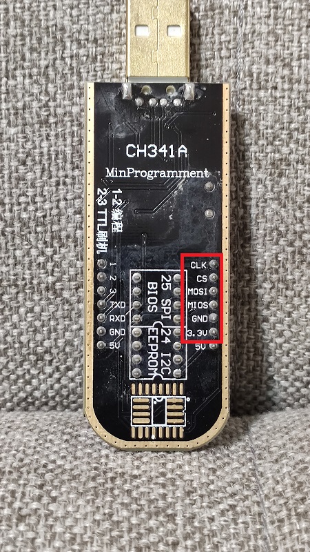

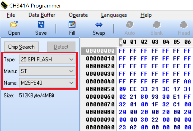

i made this picture based on the pinout provided by @dilav. i soldered a 6 pin bar to the mkii board because i only had female-female wires. for the firmware update you have to bridge jp1 using a tiny drop of solder. connect it to the ch341a programmer by connecting their corresponding pins. configure ch341 programmer according to the picture below make a firmware backup file by clicking the read button, then save it in a safe place. if anything goes wrong, ever, you can restore it using this file.
download the latest firmware from dans repository at http://dansprojects.com/firmware/GCHD_MK2/
extract it, load its .bin file on the CH341A Programmer, click the auto button.
if the new firmware is flashed successfully, unbridge jp1 and enjoy your updated adapter. future updates can be made using the .dol method.

Anyone care to share what software they used? I'm having the same result after what the software presented as a successful flash, now it just appears as blank.
Edit:
https://www.youtube.com/watch?v=DWWigscuQDY
I used the software linked to in this video (seems more like the one the post here is using. Extract it, make a languages folder, and drop the "english" config file into there to get english).
I just had to redo my solder pad bridge, and then it consistently gave me good matches with the new firmware. Be sure to unbridge after you get the verified good program, i got no output 'till I did that (i wanted to make sure it was okay before unbridging, I'm bad at soldering and so I always rip pads, I try to minimize how often I do it
