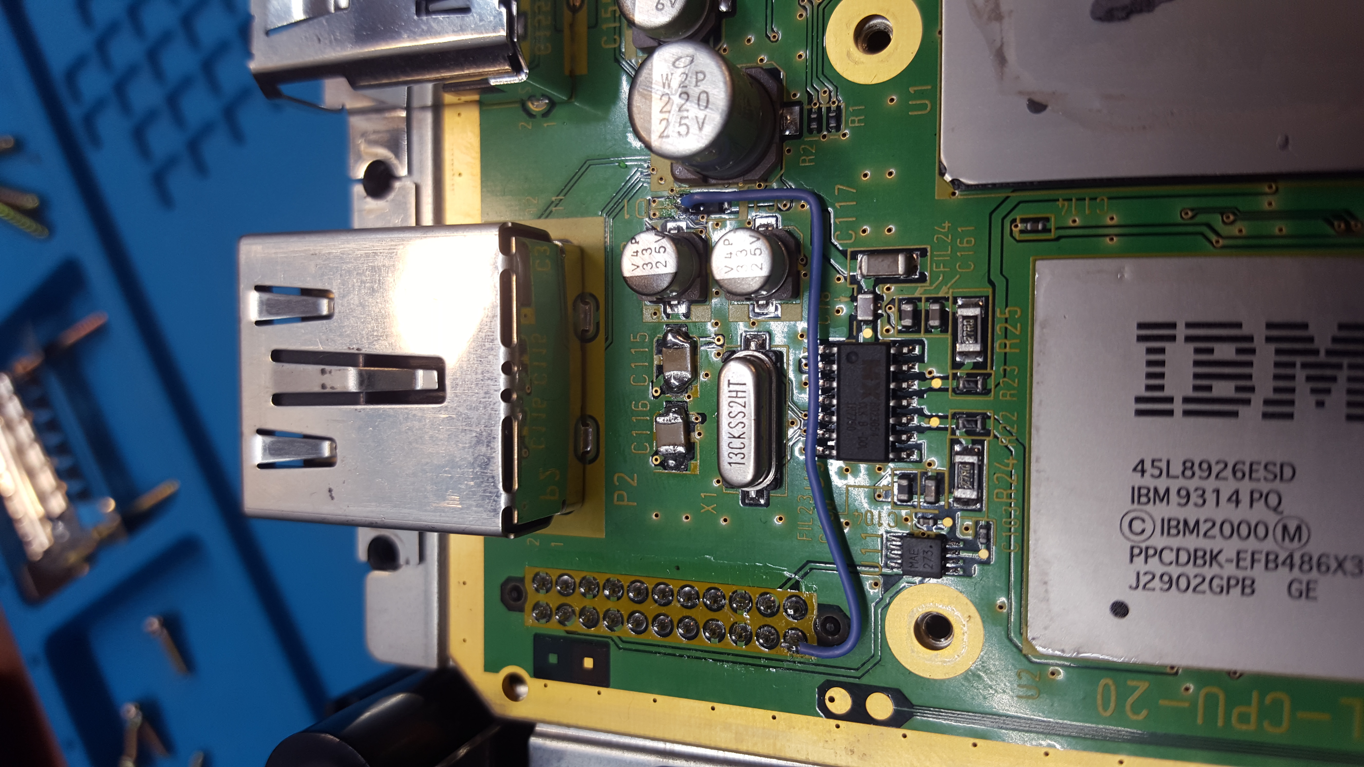

Old topic, but I think I have the fix for this issue, so may help someone in the future with a similar issue.
(This information is only for DOL-001 boards, as the DOL-101 boards have their regulator circuitry combined with the main board.)

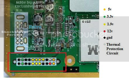

The audio circuit runs on 12v, and is pretty much the only thing that uses the 12v rail. If the 12v rail is disabled for some reason, like a bad regulator board, then the rest of the GameCube may run perfectly fine, but with no audio. Luckily, the audio circuit will happily run off 5v as well, so running a jumper wire from the 5v rail to the audio circuit will most likely fix the problem. You must check that there is NO 12v rail present before doing this though, otherwise you'll most likely send 12v to all your 5v circuits, destroying your GameCube.
I'm including some pictures for reference. I have a wire running from the 5v pin to the diode of the audio circuit. This essentially bridges the 5v rail to the 12v rail, so you must check that the 12v is not present before doing this, or it's magic smoke time.
(3.68 MiB) Not downloaded yet
(3.57 MiB) Not downloaded yet
Voltage pinout diagram
(261.25 KiB) Not downloaded yet

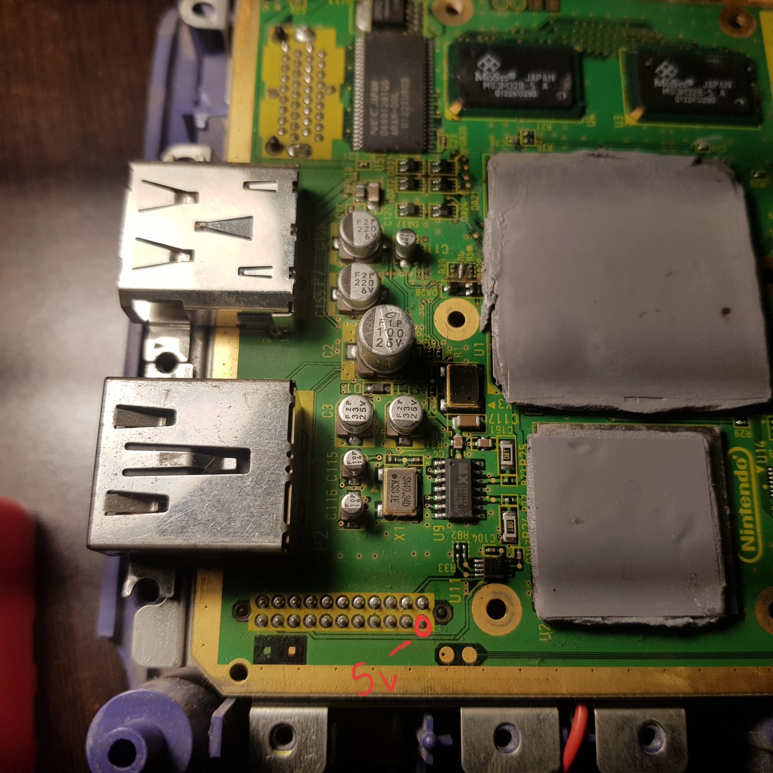

Hi I really need some help here, I thought my gamecube was the same as the one shown in the pictures but aparently it is an NTSC Japanese Gamecube region modded to be NTSC American, so, I am having problems trying to locate the Input 5-12V to power audio amp, I am sending pictures so that anybody could tell me where should I solder the wire to make the link between the 5v point to the actual audio amp. all of this so that I can have audio since it is only giving me video.
(236.05 KiB) Not downloaded yet
