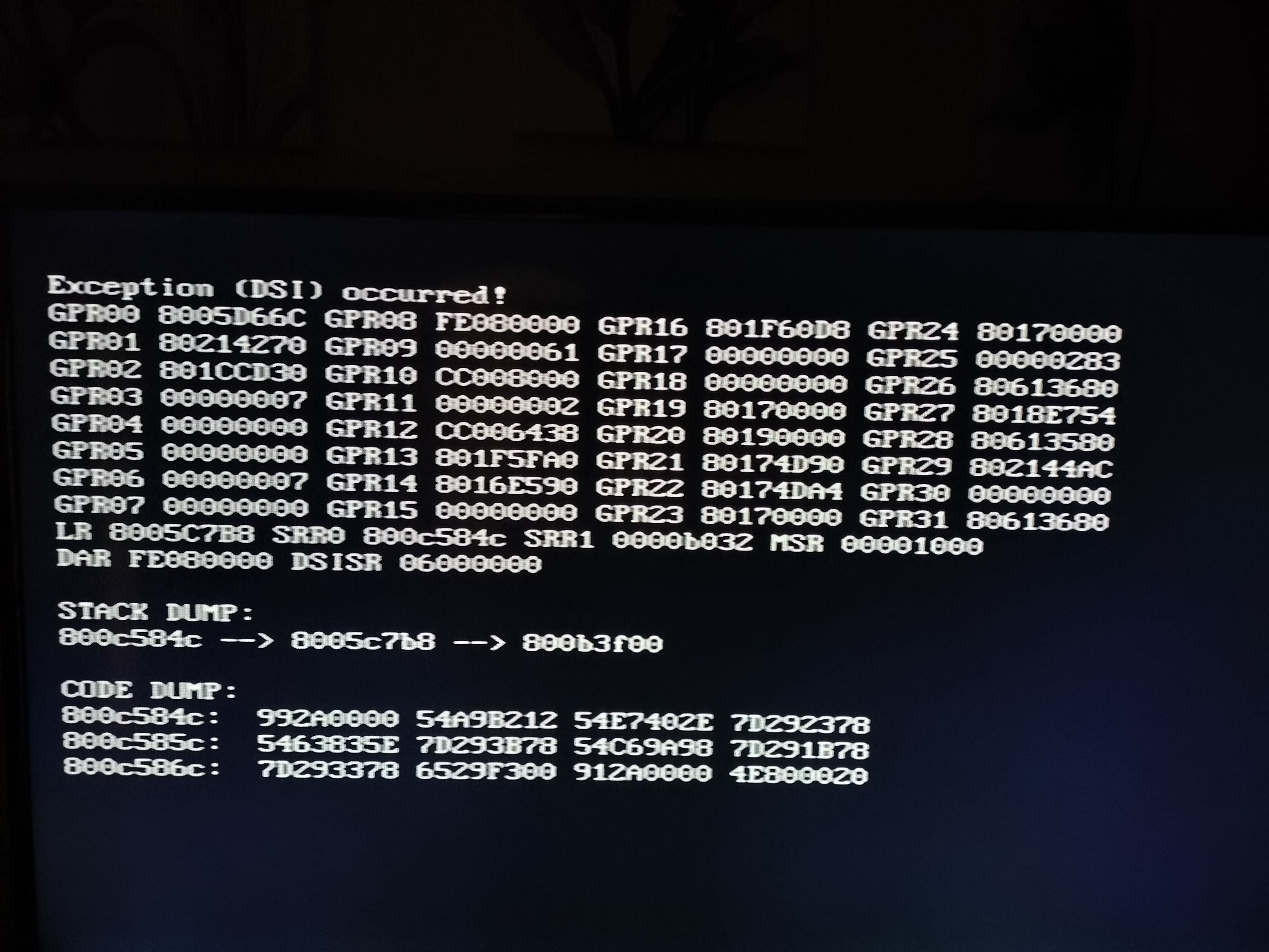

It seems like something that isn't used by the boot process too extensively is faulty, perhaps ARAM? Try various games, do they boot any differently beyond the black screen?
Can you provide the exception screen (photo, screenshot) from the most recent version of Swiss that you see?

Attached is a screenshot of the error screen. The first two times I tried it today (to get the picture), it froze on the SWISS screen. After that, it started to show the error.
