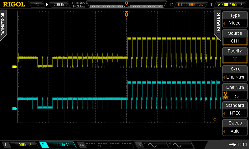

It sounds like we need someone to get their hands on a digital scope. Then we can know for sure.
No there are video filters between the digital port and ave-dol video chipShockSlayer wrote:No. It's been awhile since I've looked at a non-trimmed GC motherboard, but I'm pretty sure the digital port pins come straight off the processor.
Since I had the cube set up anyway and I needed the scope to measure something else, I just did that. =)bobrocks95 wrote:You can satisfy some sort of morbid curiosity, sure
Indeed. Now let's see if someone claims that "negative lag" is also bad and the code must be patched to remove it. =)It's hilarious to me that this EXACT scenario was joked about right when this project was posted, and now here we are.
