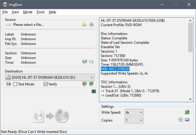

You didn't answer andzlay's question. What media are you using? Pop a disc in your drive and fire up Imgburn. Tell us what the MID is (see the attached screenshot).

No I don't know for certain but he sent my some copies he burnt. They didn't play either. I'm using phillips mini cd-r with a MID of CMC MAG. AF1. All burnt on 4x. Also attached a screenshot of imgburn.
- (1.22 MiB) Not downloaded yet
