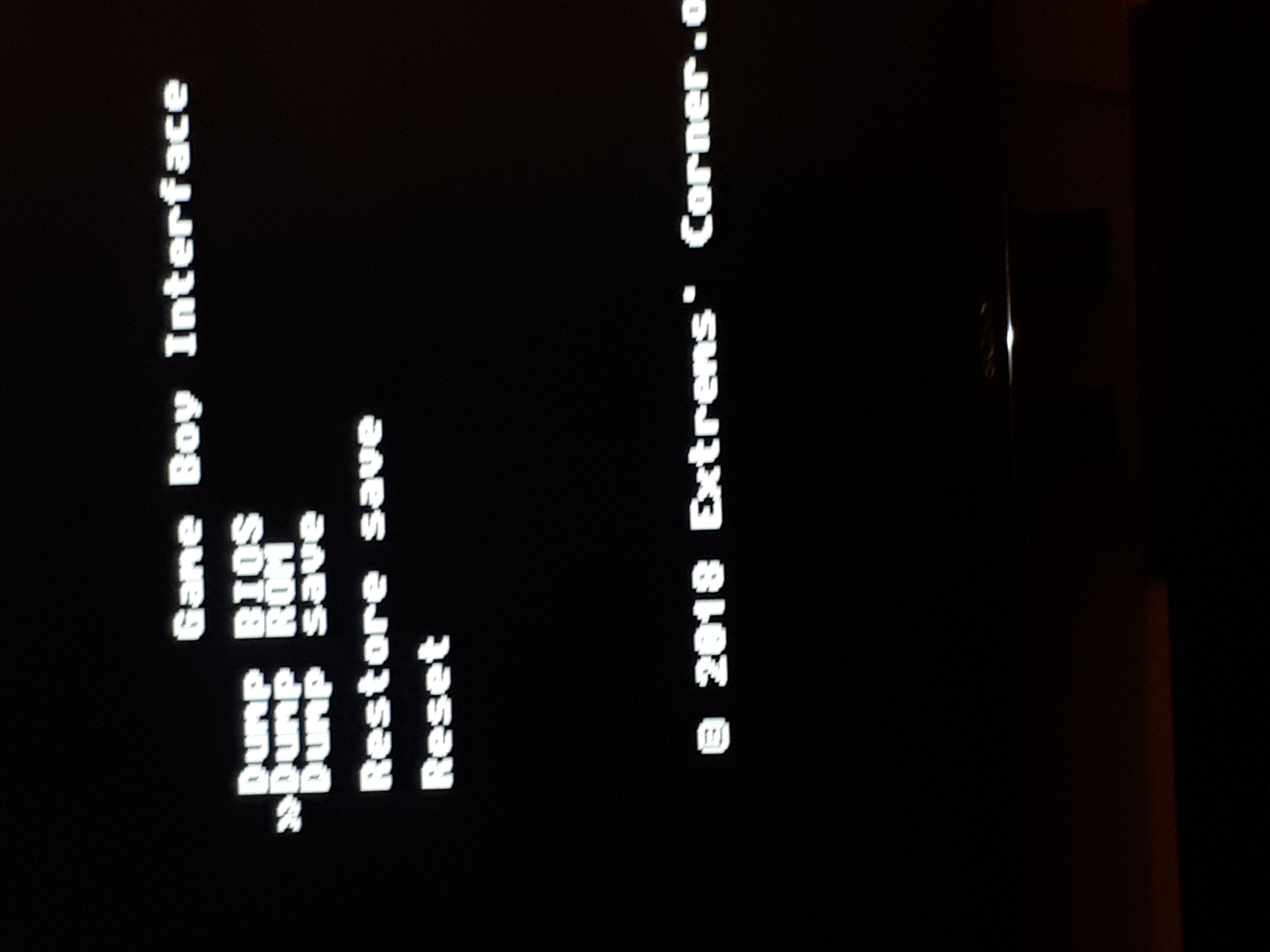

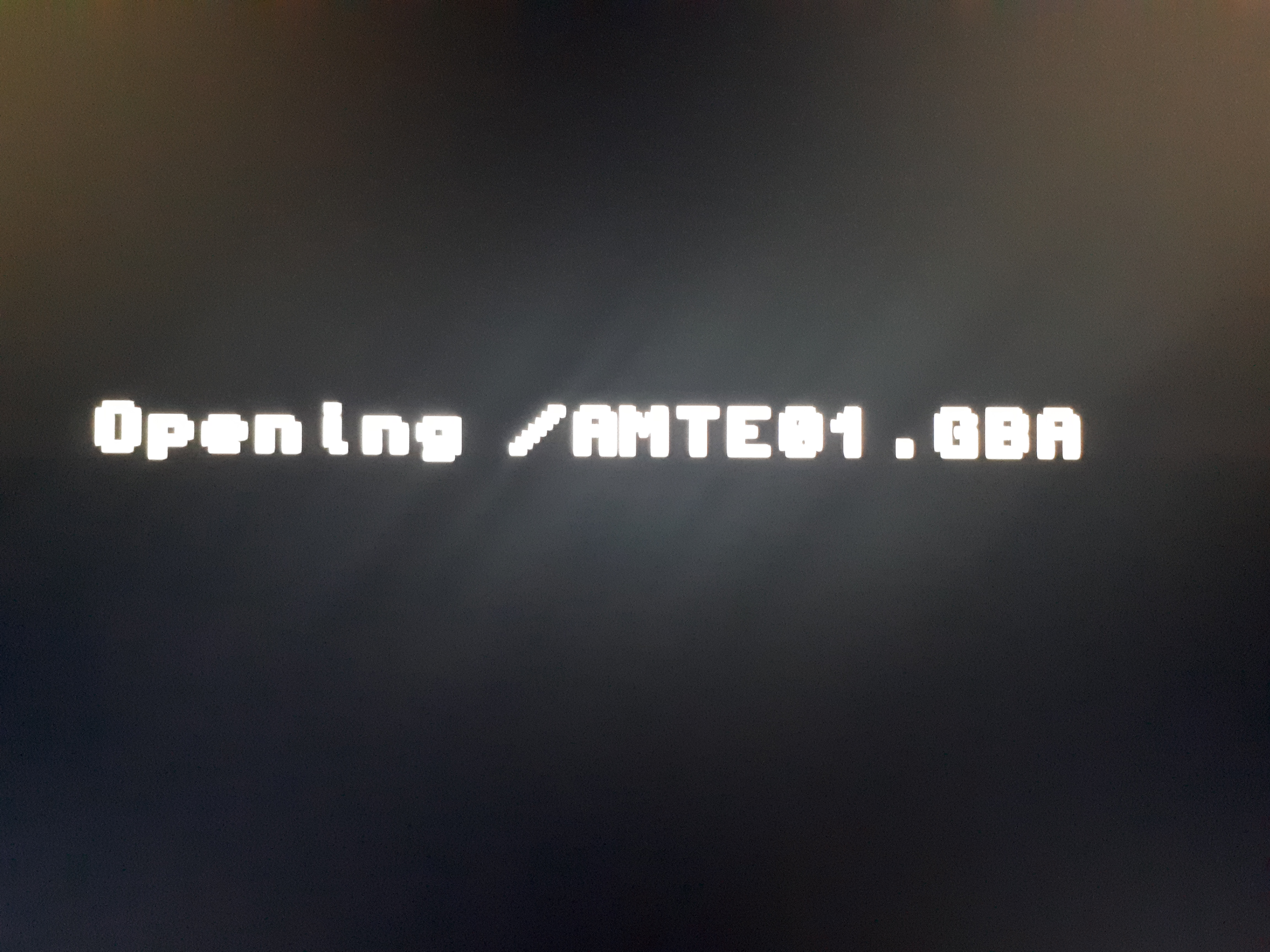

chloeh8zyou
Joined: Wed Aug 08, 2018 8:19 pm
Re: Game Boy Interface
Post by chloeh8zyou » Wed Aug 08, 2018 8:37 pm
Hey Extremes (or anyone by this point lol),
I'm currently having an issue with the software right now. I'm trying to make a backup of my GBA games to an SD Card. When I press the option to dump a ROM, it freezes and just says "Opening /(game ROM).GBA". Included are some pictures :cry: :mrgreen:
I have tried resetting the GameCube over and over but nothing seems to make it move past this. I've also left my GameCube on for nearly an hour without progression. I've tried backing up Super Mario Bros 3, Metroid Fusion, A Link to the Past, and Mario and Luigi: Superstar Saga. :|
Please help someone.
Thanks
Ps, I have been able to dump the GBA BIOS successfully ^-^ :lol:
