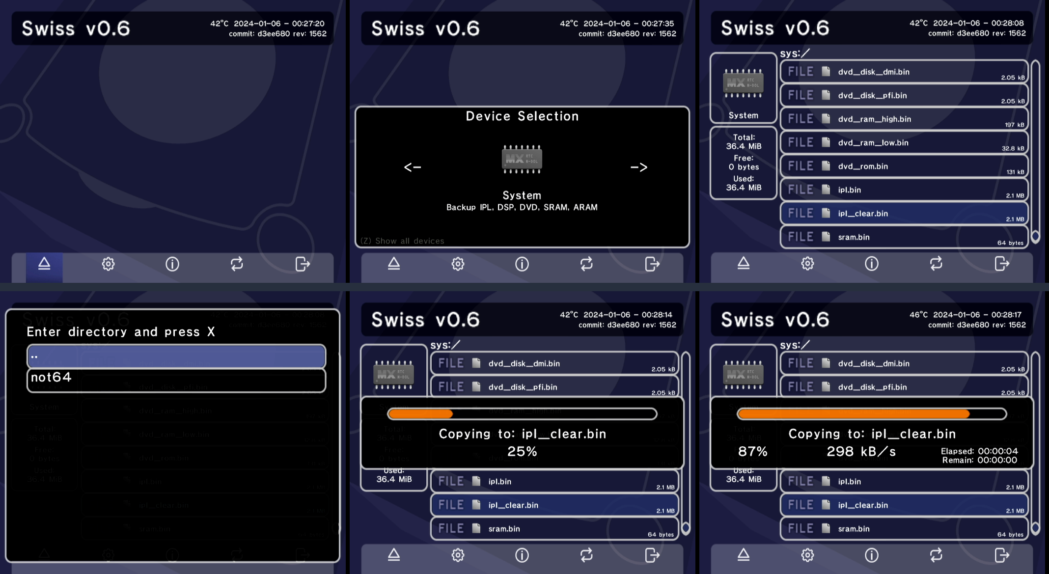

Since Aug-2015 in Swiss you can dump the 2Mbyte GameCube's IPL Mask ROM / bootrom to the decrypted IPL ROM file: ipl_clear.bin and the file: ipl.bin It is a really great feature of Swiss. Thanks a lot.

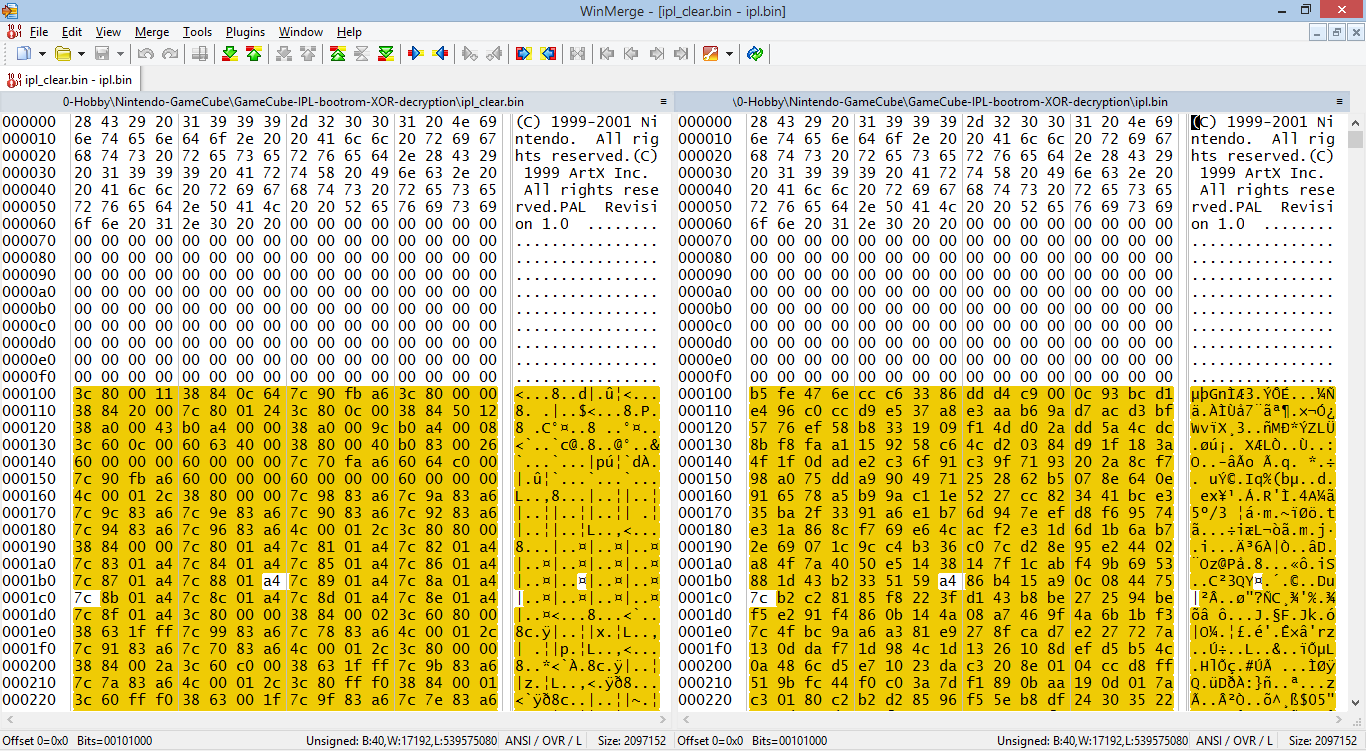

From the point of view of the educational purpose, I did open both (ipl_clear.bin and: ipl.bin) in the differencing and merging tool "WinMerge".
(a well known tool like: "WinDiff").
As you can see the first 0x100 bytes (0x00000000 - 0x000000FF) are identical.
So the first 0x100 bytes are not encrypted - a well known fact (YAGCD -- 10.3.1 Memory Map (Europe/PAL))
The next area from:
0x00000100 to 0x001AEEE8
there is the GameCube BIOS - it seems to be right regarding to the YAGCD -- 10.3.1 Memory Map (Europe/PAL).

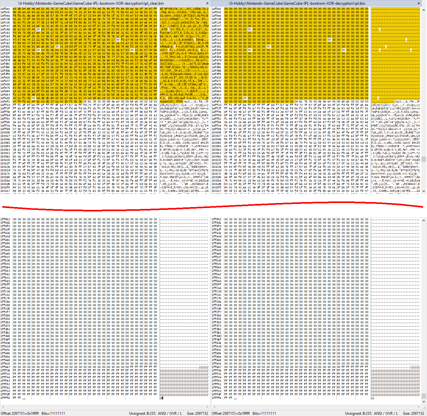

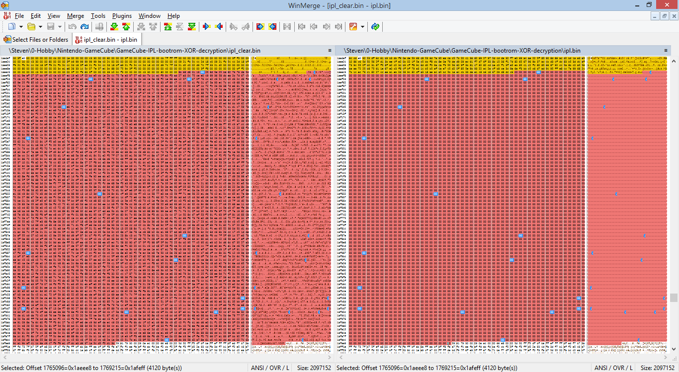

Well, the confusing thing is the next part from:
0x001AEEE9 to 0x001AFEFF.
Inside the decrypted ipl_clear.bin there is data (encrypted/scrambled data?).
But inside the encrypted ipl.bin there are 4120 times (0x1018 times) the 0x00-Byte.
Strange thing : misc binary data (0x001AEEE9 to 0x001AFEFF) is encrypted to 4120 times (0x1018 times) the 0x00-Byte?
In other words: inside the area from 0x001AEEE9 to 0x001AFEFF there are 4120 times 0x00-Byte (in the encrypted ipl.bin) wich will be decrypted to misc binary data in ipl_clear.bin?

What is the sense of the data from 0x001AEEE9 to 0x001AFEFF and why is it "0x00" in the encrypted ipl.bin file?

Borg Number One wrote: Fri Jan 05, 2024 10:55 pm What is the sense of the data from 0x001AEEE9 to 0x001AFEFF and why is it "0x00" in the encrypted ipl.bin file?
It varies with the IPL ROM revision. 1.2 has ciphered padding there.
