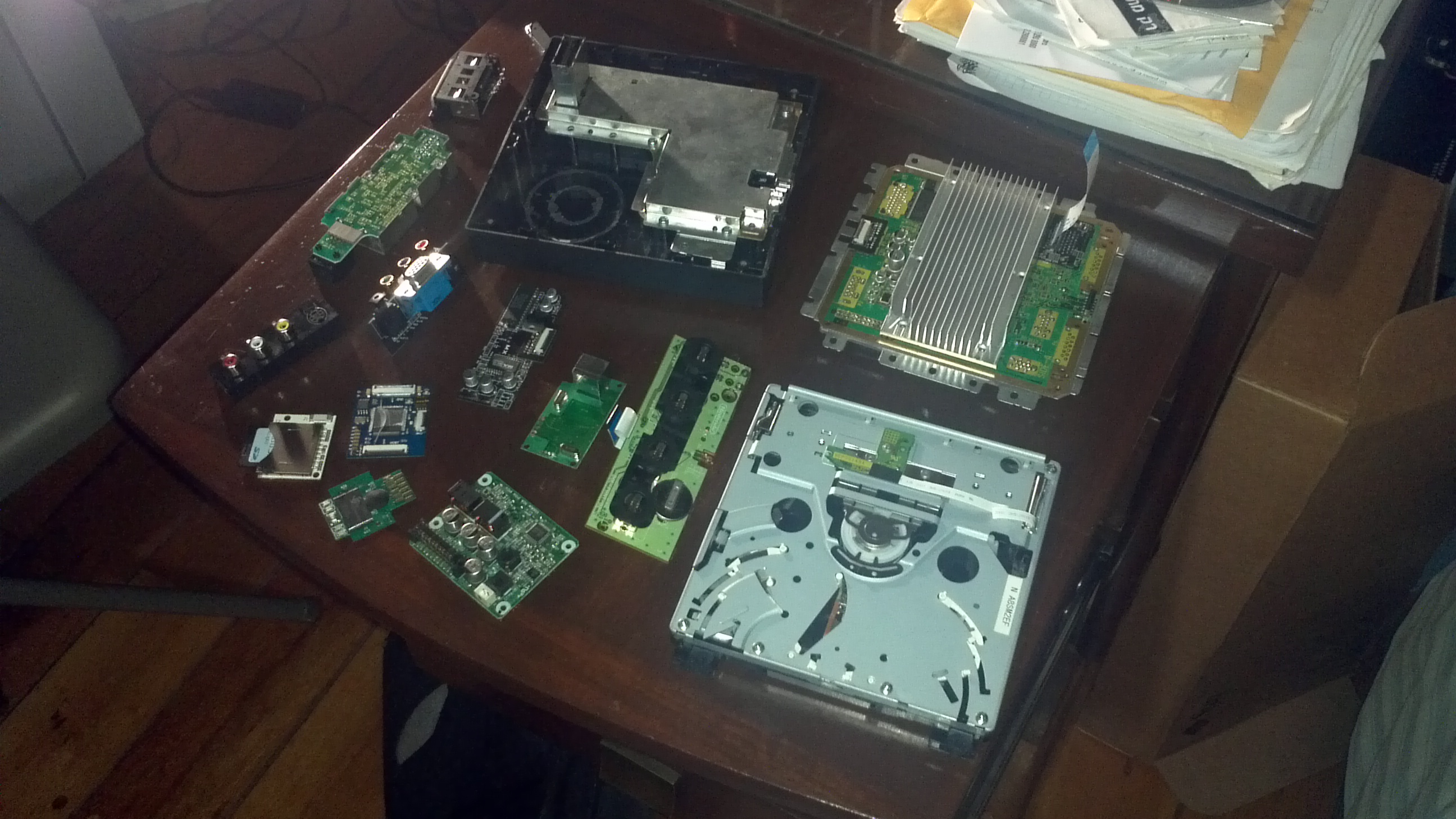

I've been working in this project for quite some time.
It is a GC featuring:
  • Wii drive
  • WKF
  • GB Player
  • 512mb (4x 2043) Block internal memory card
  • BBA
  • MEGA3 board (component and vga)
  • Internal ps2 keyboard adapter
  • AV outs
  • Some other surpprises

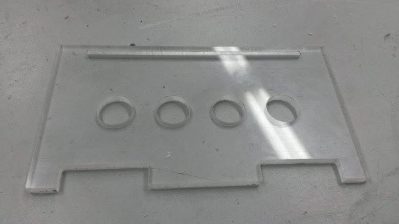

All inside a GB player base and a custom acrylic case barely larger than a standard cube.

Parts:

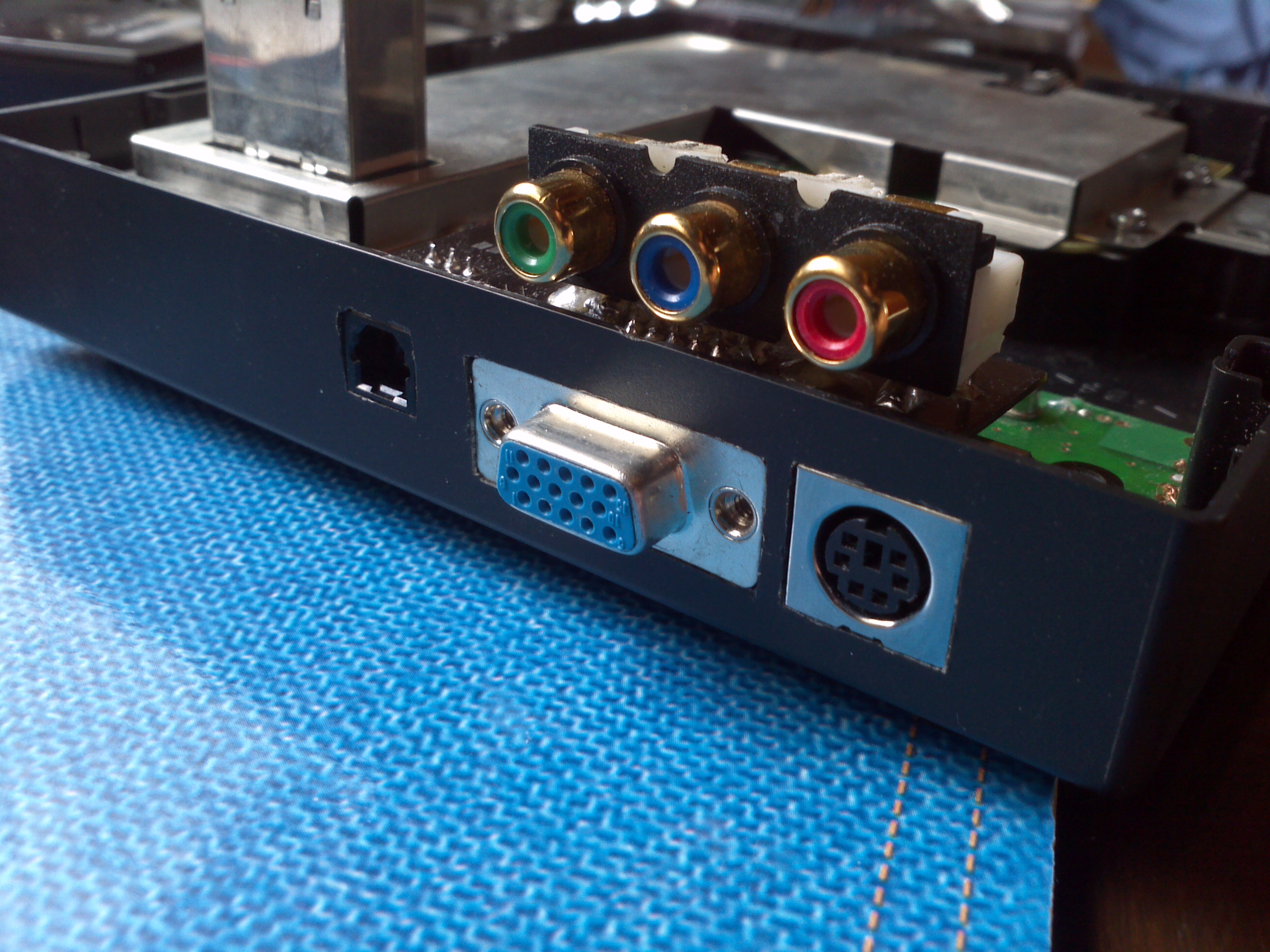

Some ports on the back:

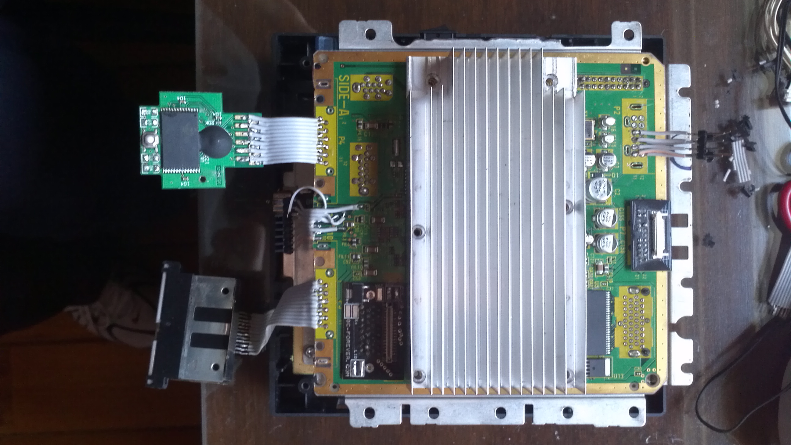

I desoldered everything and the problem remains, if you see on the gc motherboard picture I trimmed the motherboard to make room for the controller board, my guess is that the short could be there, I'll sand it thoroughly tomorrow.

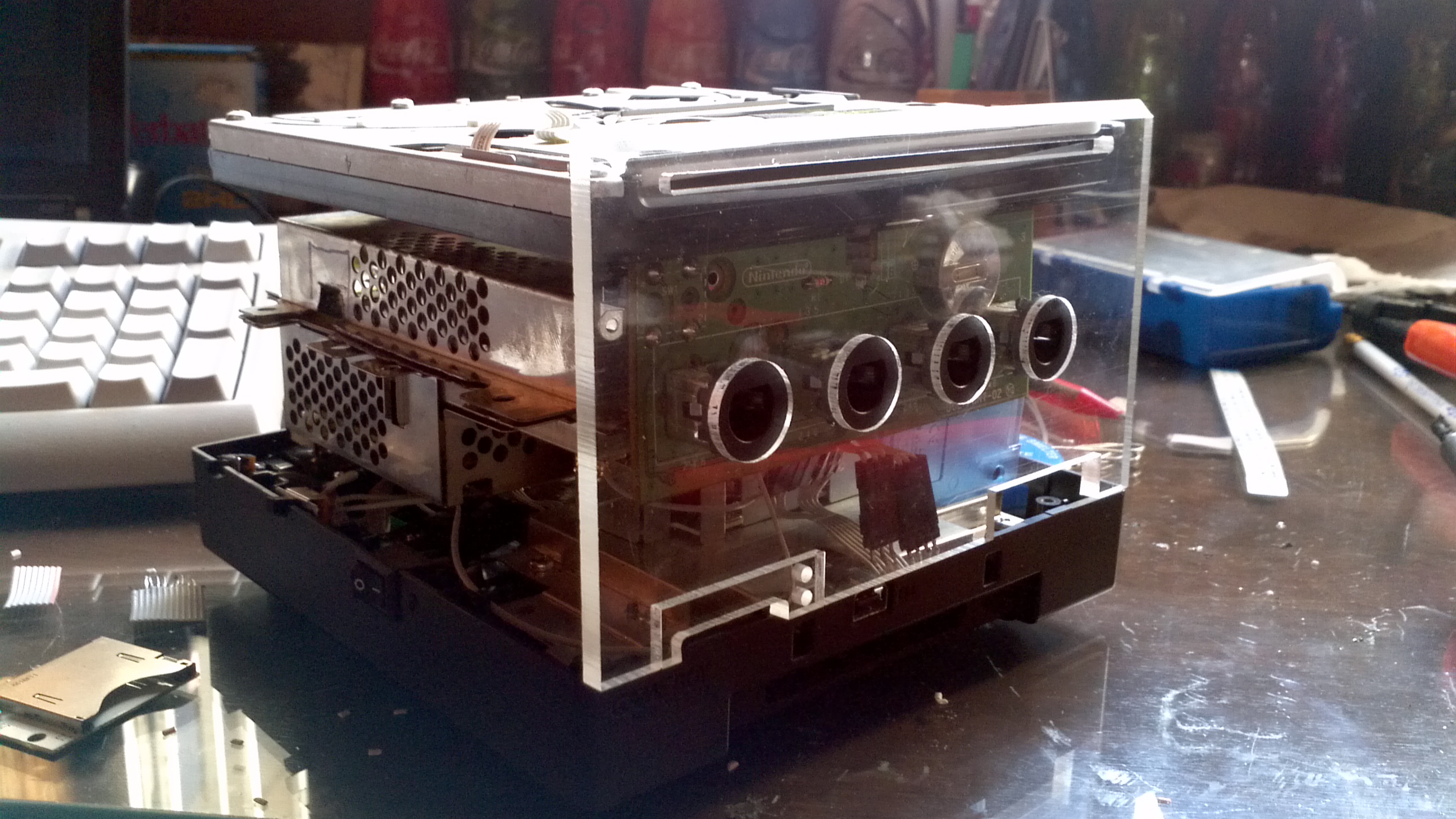

Here's a pic of the Procube fully assembled just before I noticed it wasn't working:
There is still a lot of work to do.

i see an on/off switch on the side
i also see the mainboard is "floating" because of the PSU and PSU cage..
ever thought of wiring the PSU to save a few inches in height?
how will the drive stay aligned and in place? it just looks like its sitting on top of the drive cage
there have been many many many discussions on IRC of making a GC Slim, but you know us, something else always comes up and none of us ever get the chance to make one...

The space the PSU makes will be filled with the BBA and some other stuff, it's actually very tight.
The mainboard and the drive will be hold and secured in place with the acrylic case sides, I'm still figuring stuff out.

It's been a long time, I started to work on this project again.
I changed the whole mobo and I'll start wiring and testing everything, component by component.
I was concerned about the mega3 board, but I just tested it and it works great, next step will be to connect and test the controller board.

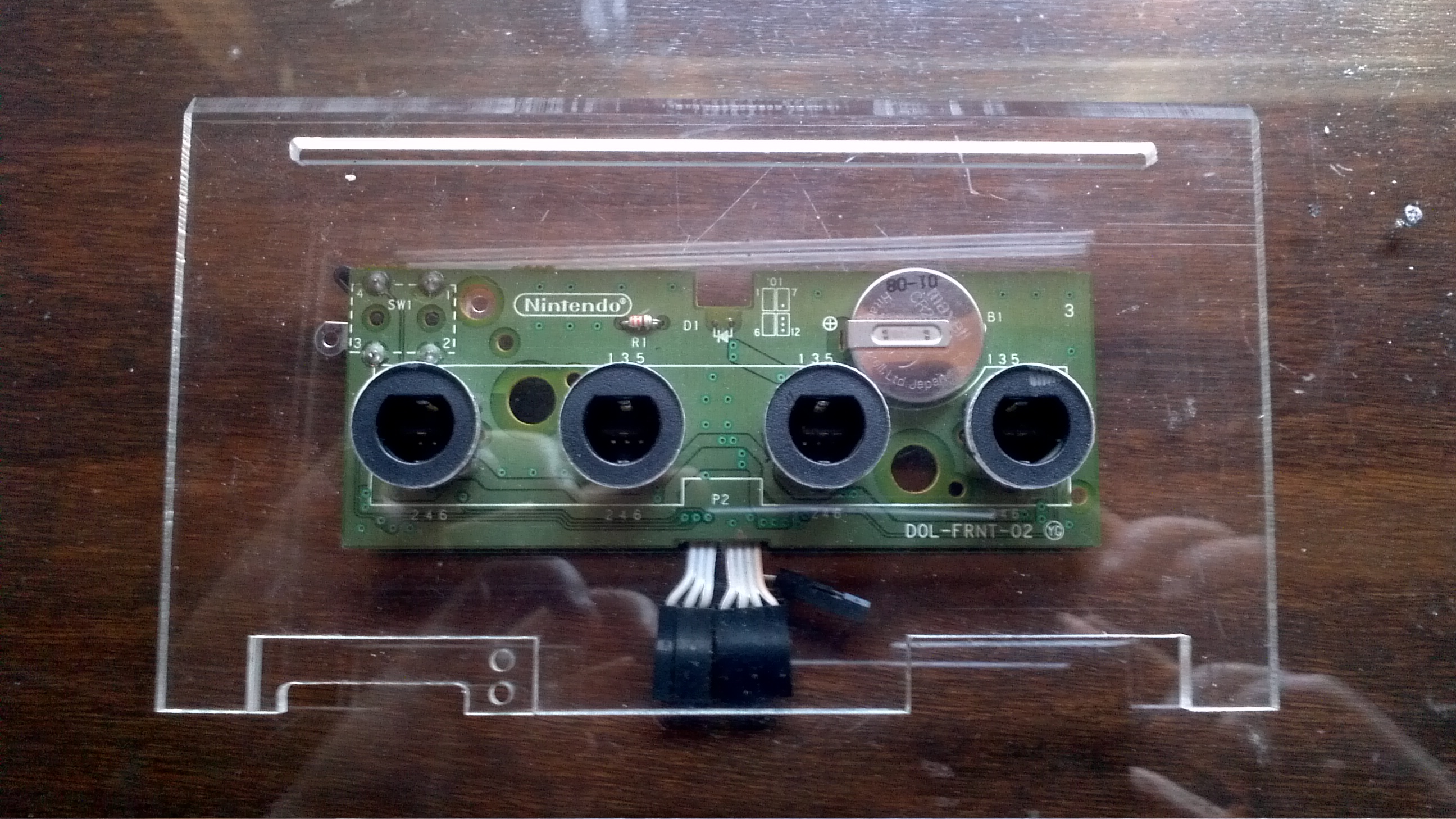

Yes, left slot is wkf, wkf led's will be wired to the holes.
Right slot will be a standard gc mem slot wired to the motherboard's slot B, for external memory cards or sd-adapters.
A 512MB memory card is permanently soldered to the motherboard's slot A.

Did you use a CNC and auto cad to cut the acrylic.
