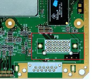

This is a massive compilation thread for people interested in doing DVD drive replacement efforts. Unknown or unverified information will be listed in red italics.
The GC motherboard interfaces with the DVD drive assembly through the P9 connector on the motherboard. YAGCD has this info on the pinout.
(27.16 KiB) Not downloaded yet
(21.12 KiB) Not downloaded yet

All signals lines are 3.3V. It may help to group the pins by function. Pins in red are host-controlled (driven by GC motherboard), in blue are DVD-controlled, and in green are bidirectional. Black is for non-signal wires.
Pins 11, 28 and 30 need direction / definition

Re: The Definitive DI / DVD Interface Thread
Post by novenary » Mon Mar 21, 2016 7:33 pm
meneerbeer wrote:What kind of chip is on the DVD drive anyways? Also just a standard microprocessor?
Some 8 bit MCU (MN10200).

hornpipe2 wrote:
Unseen wrote:AISLR should be driven by the drive in either case.
Actually... AISLR may be Cube controlled too. Check this VHDL for the CrazyNation version?
Indeed, I misremembered that - when an I2S receiver is the master device, the only signal driven by the sender is the data line.
pyroholic
Posts: 58
Joined: Tue Nov 25, 2014 8:22 am
Post by pyroholic » Wed Mar 23, 2016 6:26 pm
Unseen wrote:
Yes that is correct, the cube drives clock and l/r channel strobe. It toggles every 16-bits so a period is 32-bits which is equat to a clock frequency of ~1.54 MHz at 48kHz and 1.02MHz at 32kHz. I used the audio-streaming code from dolphin when i wrote my VHDL core for streaming audio and it seems correct, sounds decent at least. The dolphin decoder is the same as for the winamp plugin.
As for cube/dvd speed on the bus, from my findings using a logic analyzer the cube seems to be transmitting at 20Mbyte/s where the strobe signal toggles as a 20MHz clock. The drive seems to be shuffling data at 13.5MHz, which was calculated by measuring the time of ~100 clocks divided by the same number of clock flanks.
The one signal i have not been able to figure out is DIBRK, which is listed as bidirectional in crazynations code but not handled. I have mapped it as IO in my implementation set to high impedance, and has never seen it toggle from 1 to 0. I have not seen it toggle while sniffing on the original drive connected to the cube either. But my guess is that it is handled using some kind of handshake if it should really be bidirectional.
hornpipe2
Posts: 7
Joined: Sun Mar 20, 2016 9:10 pm
Post by hornpipe2 » Tue Mar 29, 2016 6:49 pm
I assumed DIBRK was marked as bidirectional just because they didn't know what to do with it either : ) Maybe the Cube raises it if you send data too fast.
Any idea on MONI or MONOUT? Some kind of serial debug thing or something, I guess.
Have you tried going faster than 13.5MHz to Cube?
pyroholic
Posts: 58
Post by pyroholic » Tue Mar 29, 2016 7:13 pm
Currently i use a system clock of 125 MHz divided by six to generate the strobe signal, so it toggles every third clock resulting in 20.83 MHz and so far no issues.
I measure zero ohms resistance between moni / monout pins and grund on the drive board so i guess they are really ground pins.
tueidj
Posts: 564
Post by tueidj » Wed Mar 30, 2016 2:34 am
BRK is signalled to the drive on error I.e. when it takes too long to respond. It's meant to cancel the current operation.
pyroholic
Posts: 58
Post by pyroholic » Wed Mar 30, 2016 6:54 am
Ok, I guess that might be why I've never seen it toggle. Perhaps it is asserted before a dre happens.
My guess is that the cube asserts the break signal for a short period and then releases it, the dvd responds by holding the break signal on the asserted level until the break is complete. It should be possible to verify with some custom code that starts a break request while observing with a logic analyzer or scope.
hornpipe2
Posts: 7
Post by hornpipe2 » Wed Mar 30, 2016 2:35 pm
meneerbeer wrote:
hornpipe2 wrote: I'm also planning to start one of these (based around some fast ~100mhz ARM microcontroller and an SD card) so I'll add my own notes as I discover issues.
Interesting. I have been thinking about that as well, but I am much more a hardware designer, so I usually settle with an FPGA. ;) What kind of chip is on the DVD drive anyways? Also just a standard microprocessor?
After some research, I think ARM-based uC is not the answer. 20MHz bitbanged parallel access is just too fast for most microcontrollers to keep up with. For industry protocols like SPI or I2C there is often on-chip hardware to make it go fast, but for a custom protocol you are limited to how fast you can toggle GPIO pins. Even with a 700MHz Raspberry Pi, it craps out at 22MHz using C.
Now to see how much VHDL I remember from one semester of college : )
The chips currently on the drive, according to YAGDC, are:
    Matsushita MN103S13BGA Optical Disk Controller
    Matsushita MN102H60GFA MicroComputer clocked at 34mhz
with some custom ROM. MN103 probably runs the motor and laser etc, while MN102 does the computation.
pyroholic
