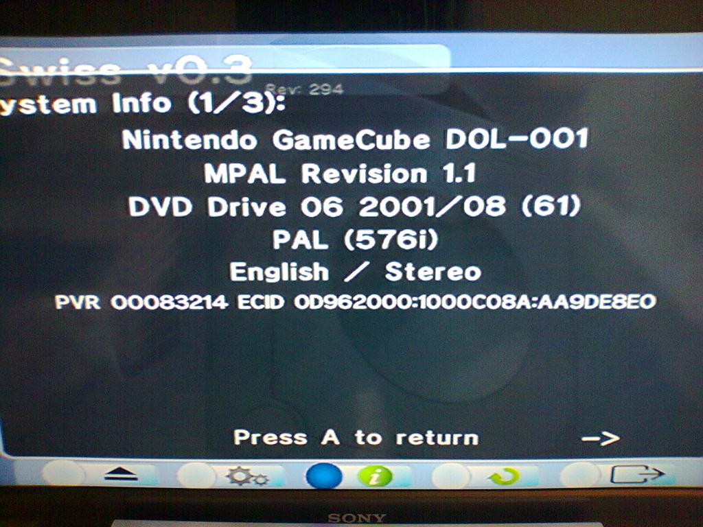

Sugurain
Posts: 35
Joined: Wed Dec 31, 2014 1:21 am
Re: Swiss Nightly Build
Post by Sugurain » Thu Jan 01, 2015 2:37 pm
Although the sticker on the underside says it's a DOL-002:
Take a look at what Swiss says about it:
And, yep, I just bought an SD to memorycard adapter from Deal Xtreme.
It's exactly like this one:
I've been messing with homebrews for my old Xbox, PSP, PS2 and DS for years now, and for the first time I decided to play with my Gamecube too. I must admit, I'm having a lot of fun with this. xP
(47.06 KiB) Not downloaded yet
(94.25 KiB) Not downloaded yet
(112.26 KiB) Not downloaded yet
(117.99 KiB) Not downloaded yet
Posts: 4573
Post by emu_kidid » Thu Jan 01, 2015 2:56 pm
Nice, have never seen one of those before. At least the DVD drive looks standard and nothing special.
From that "MPAL Revision 1.1" I can tell it's a new undumped IPL (BIOS), and from that alone we could add support specifically for that console revision :)
If Swiss treated your console as NTSC would that work out better for you as I'm unsure how to cater for PAL-M specifically at this point (Extrems?).
You should be able to go to the settings in Swiss and change "Swiss video mode" to "NTSC (480i)".
Also, I'd like to see the BIOS dumped for completeness sake if you've got the time (and if I can remember if there's any already written tools to dump the IPL to SD Gecko).
EDIT: Do you also know if there was a GameCube released later in your country without the Digital Port on the back? If so, do you think you'd be able to get Swiss booted on one? ;)

Now I'm plain confused. I thought Gamecube color encoding was entirely hardware controlled (think Sega Genesis etc).
Thus no need for software to distinguish between NTSC and PAL-M.
In any case I've never heard of a Nintendo licensed commercial PAL-M game. So it may only be relevant to homebrew like Swiss.
From the looks of it, your console is outputting PAL-M at 50hz 576i. That would explain color returning with the TV set to PAL-M, but cut off.
