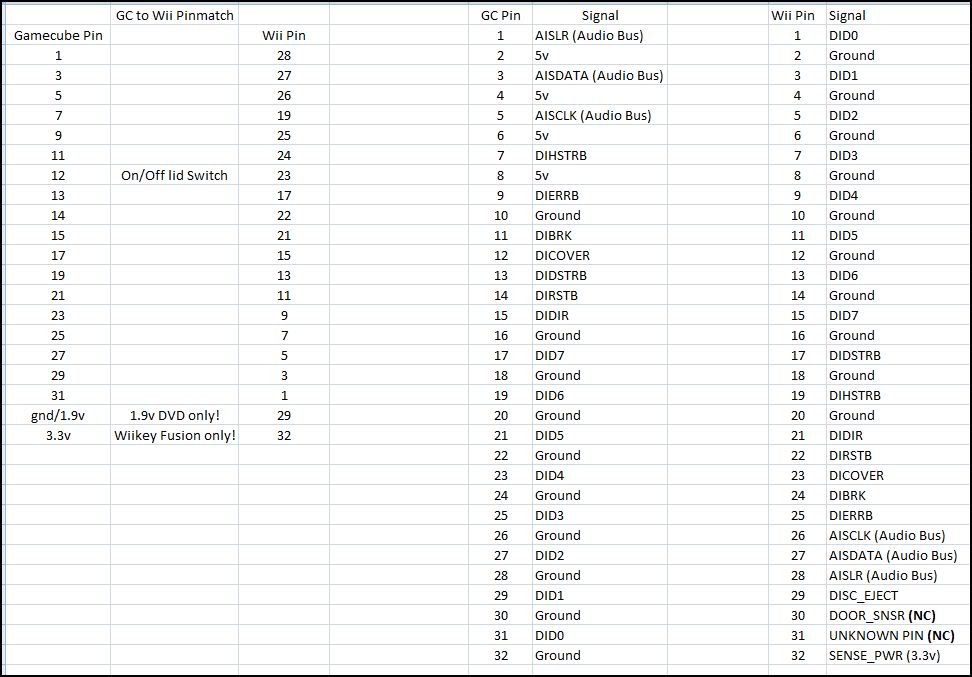

Post by Ashen » Fri Feb 04, 2011 3:56 pm
Not saying much for the mass storage department on the gamecube yet but, can I get a fucking booyaa!
This is the correct match up:

Post by Ashen » Fri Feb 04, 2011 4:19 pm
I would have but disc eject is still a work in progress. For things to work correctly the eject pin needs to stay grounded (low byte). To eject the disc it needs a 1-1.9v pulse. Gonna have to figure out a good way to do it. Also, I still am not giving up on the sundriver, especially now. :D :D :D :D :D

Post by Tchay » Fri Feb 04, 2011 10:48 pm
Ashen wrote:I would have but disc eject is still a work in progress. For things to work correctly the eject pin needs to stay grounded (low byte). To eject the disc it needs a 1-1.9v pulse. Gonna have to figure out a good way to do it. Also, I still am not giving up on the sundriver, especially now. :D :D :D :D :D
I was ganna say, you could have a switch that connects to the gamecubes 1.9v line. And toggling the switch will send 1.9v to the line.
:draws it out:
EDIT: Okay I think I was just having a brain fart. This is very simple. A 2 way switch will fix this problem ASSUMING it is okay to have a constant 1.9 volts being fed into pin 29. Then when you toggle the switch the other way, it connects ground to pin 29. WIll the drive work again after the toggle?

Post by Ashen » Fri Feb 04, 2011 11:53 pm
No no. Pin 29 does not ALWAYS need to be grounded. In fact a game will boot without it, but the GC errors out shortly after booting. Pin 29 I think expects to recieve a "low byte" signal after a game is booted. Grounding pin 29 tricks the drive into thinking its recieving this low signal.
Pin 23 on the Wii side is the "lid open, lid closed" signal. In the case of the Wii its actually just disc inserted, disc not inserted. Same thing really.

Post by Ashen » Sat Feb 05, 2011 12:38 am
Yep, pin 29 (wii side) is the only altered pin. The rest is pretty much "plug and play". Pins 32, 31 and 30 are unhooked in those vids I made, if you look close u can probably see the extra wires going nowhere. I will say though that the drive does act funny when ejecting and inserting a disc, kinda like the disc insertion/eject motor doesnt know when to stop running. I can make some vids sometime this weekend that show these issues.
Also, for those interested in trying this mod. I would suggest getting the same flat ribbon cable connector from proto advantage that emu_kidid ordered a few pages back. It will make your life much easier. Soldering straight to the cable is a major biatch.
