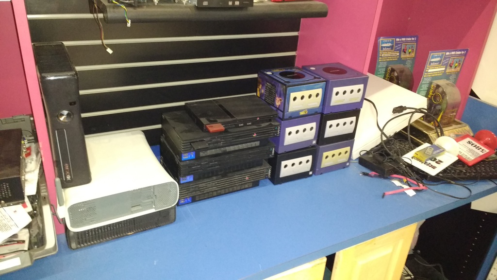

I ended up cannibalizing the cube for some other parts so now I have a spare for the next batch I dig into
I spent all day yesterday installing region switches on 9 of the cubes lol
ugg the solder points are soooo tiny had to go out and buy a helping hands just to see them
lol busy day
